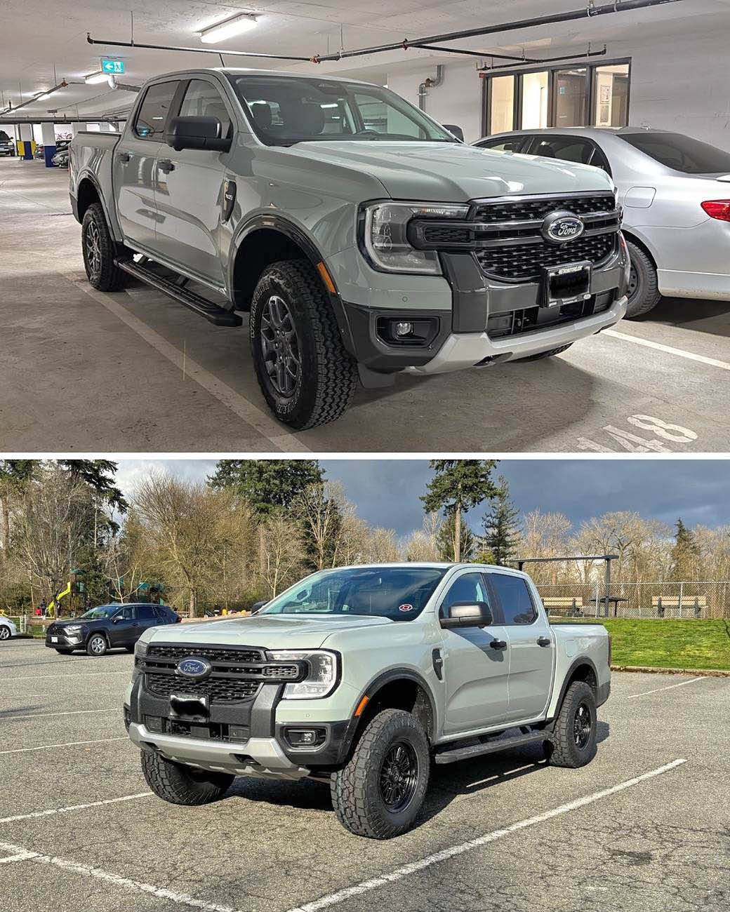

Oh interesting, does it ride bouncy or stiff at all?
Yea I've got the same question.. If I was going for strut replacement I'd probably make sure to get the rears as well (so it is more compliant in the backend).
The truck looks amazing though, would be curious to know how tall the cab is for clearance in a parkade as well.

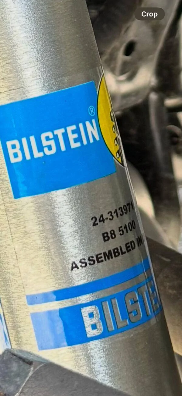

FWIW i had the 5100's on my 5Th gen and it did stiffin it up a bit, nothing uncomfortable but eliminated that slight floaties that the stock shocks give you.
I've been waiting for Bilstein to release them specific for the 6th gen but nothing so far,
this install seems to be the first confirmation that the Bronco's will work.

I’d say slightly more stiff than the stock set up, but nothing crazy. The bilstein is digressive so changes depending on shaft speed I believe. Not bouncy at all and seems to be tighter than the OEM set up.
Goes well with the rears now but I plan on doing the rear as well, just gotta do some more research first!

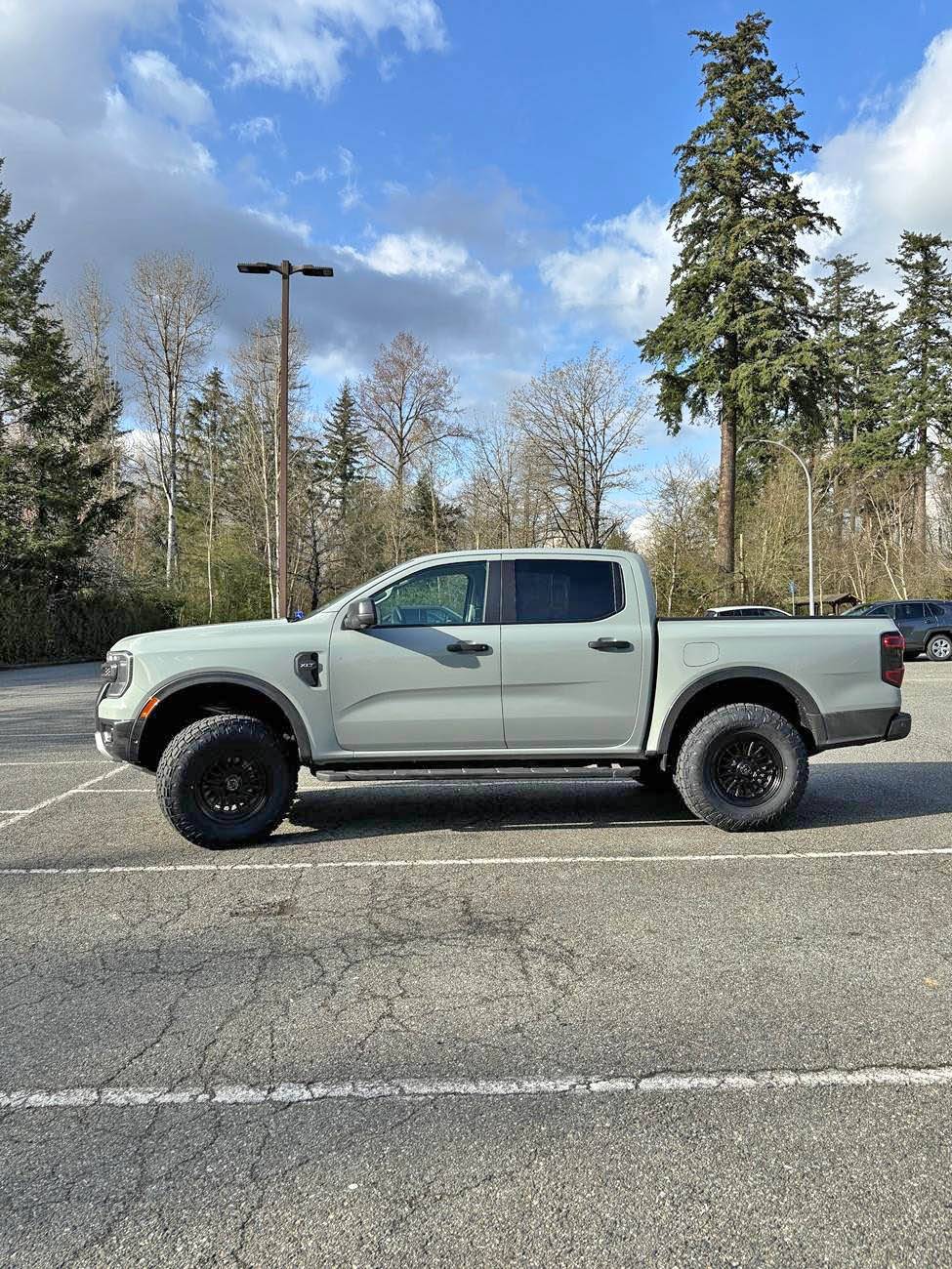

my parkade is 7ft and it fits.
6ft 8 is close and hits the antenna everytime, I’ve ordered a stubby so should be clear for that. I wouldn’t risk a 6’6 though

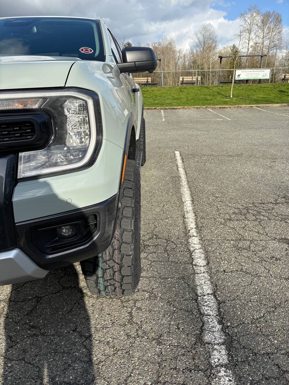

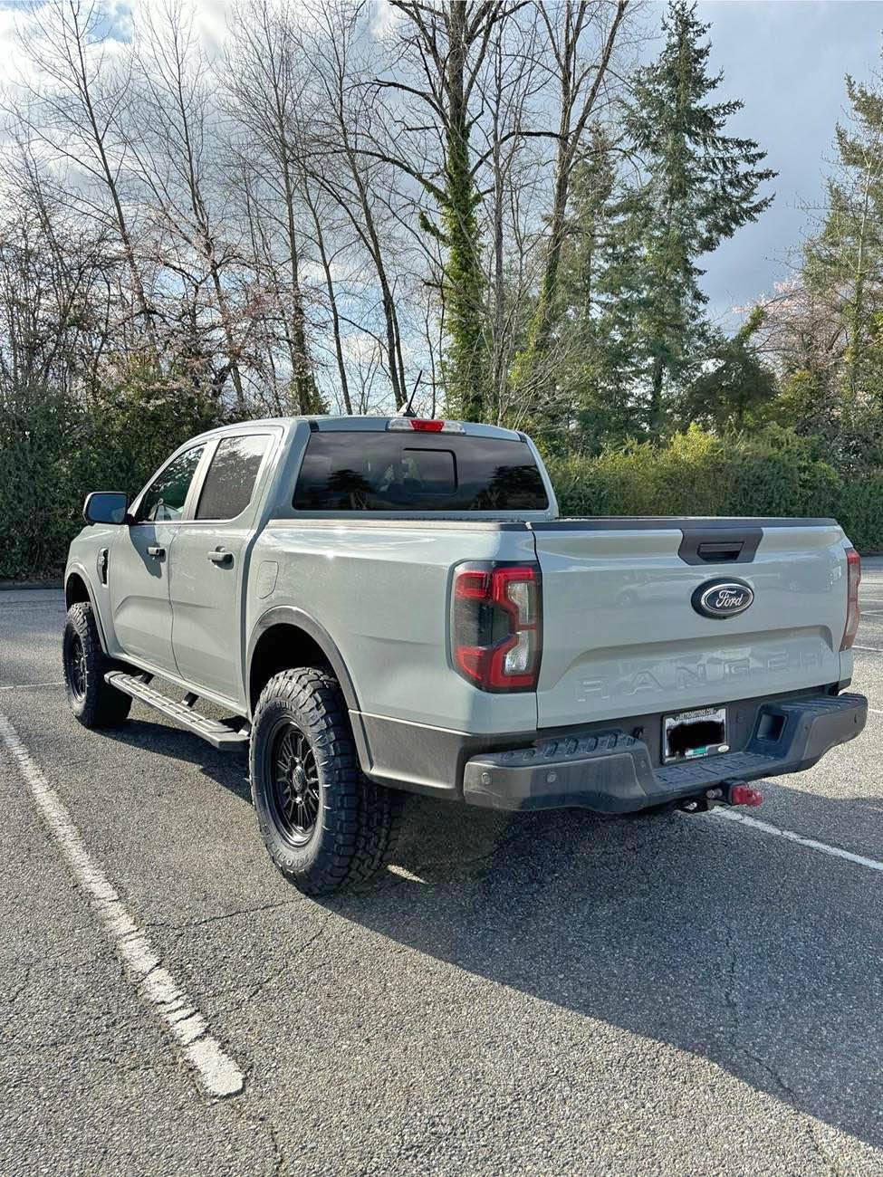

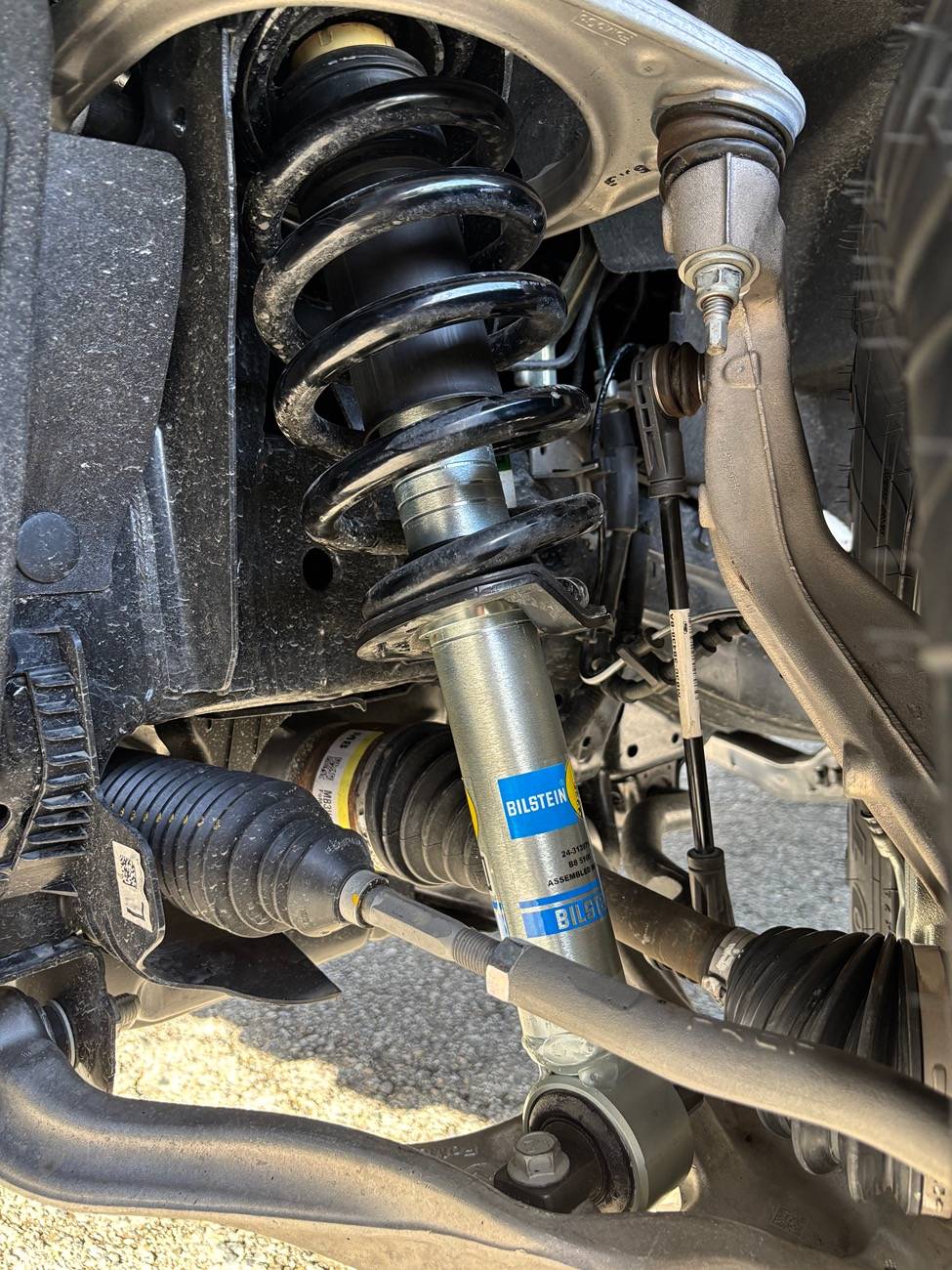

Just picked up the ol gal from the shop.

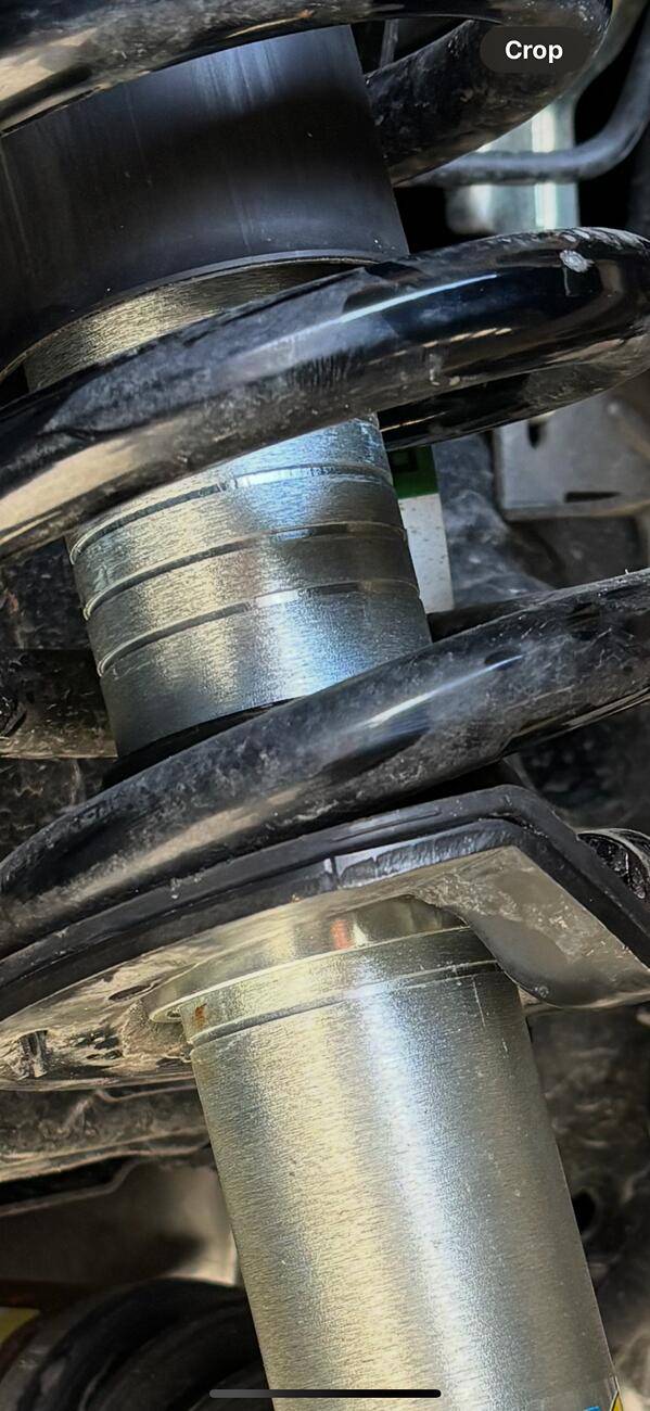

Last week we tried to install the Bilstein 6100’s and found the lower perch to be too large for the OEM coil. So we went with the 5100’s and they fit great. Looks pretty level on the 2nd Circlip.
Also Installed tire/wheels while they were at it.
We got 285/70/17 Toyo Open Country AT3’s
17x9 +25mm unreleased Black Rhinos.
Got lots of photos for you guys if interested in a similar set up!

I wonder if these would fit since you need to reuse the stock top hat. https://www.summitracing.com/parts/eib-e80350480122/make/ford/model/ranger/year/2023
