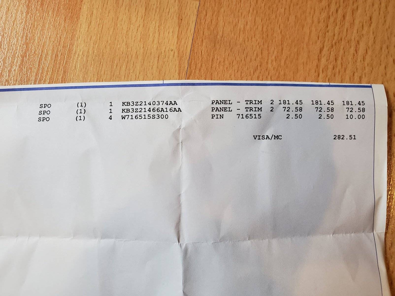

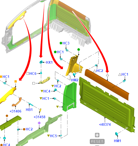

These are the correct part numbers that you will need if you want to trim out your non XL after removing your rear seats.
Ford Ranger 2019 Ranger XL Rear Seat Delete Option 20190625_152206(5)

What color are the trim panels. I have the ebony interior and would love to do this to my pickup!

You're in luck, XL trucks only come in Ebony.
I think the back seat delete may only be available as an option on the XL trim level?
Certainly, Ebony will be available, and probably no other color.

Awesome I'll give those part numbers to my guy at the dealership and hopefully they can get it fairly quickly. I personally think it looks and functions way better without the seats. Thanks for the info!!

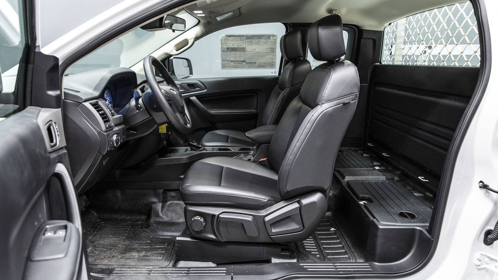

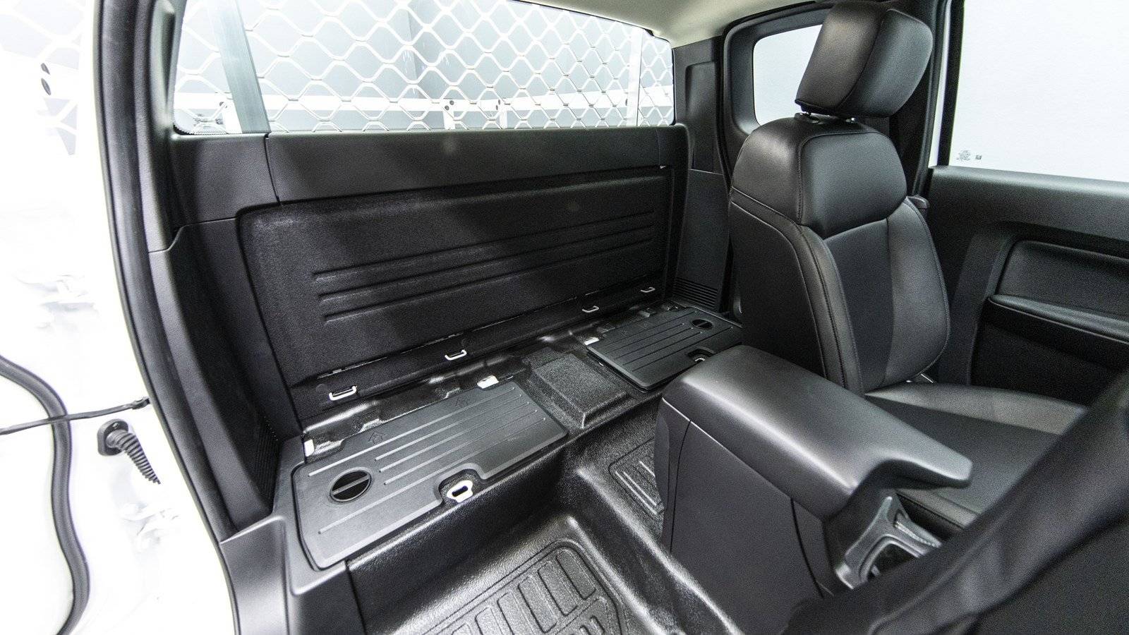

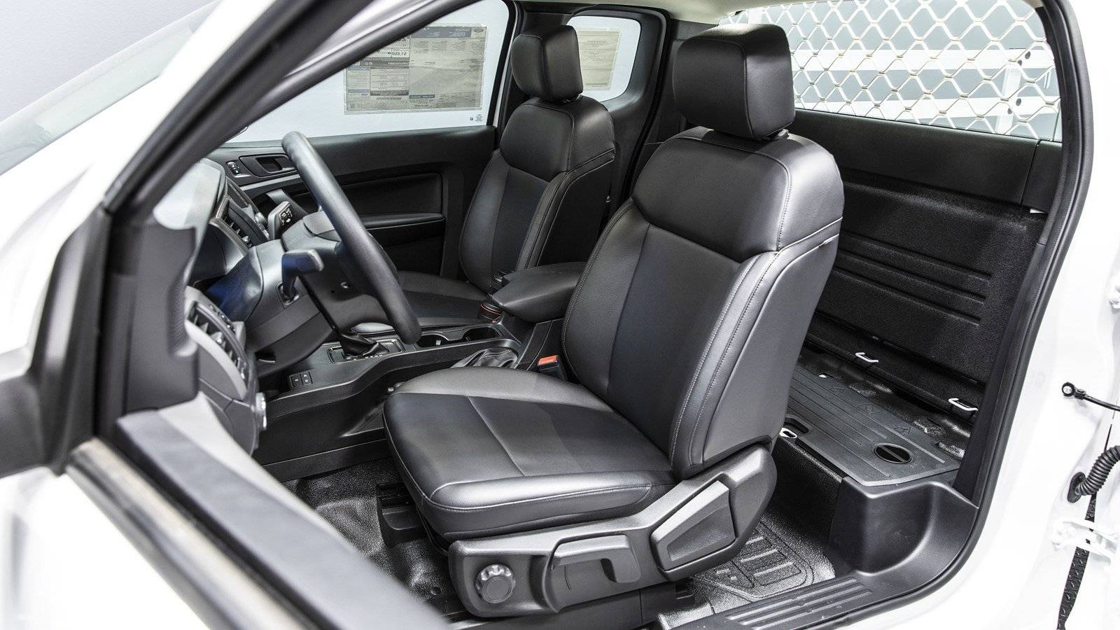

As requested by @rangerdanger, this is what the rear seat delete option looks like in the supercab XL.
Rear seat delete option unavailable in the Lariat trim level, was looking to save the hide off of some hapless bovine...
