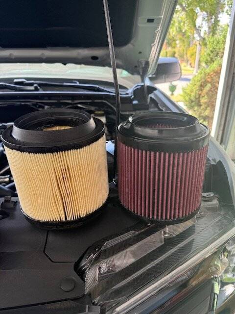

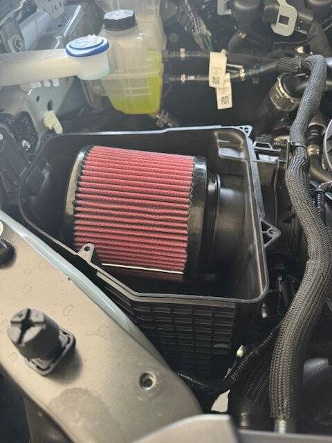

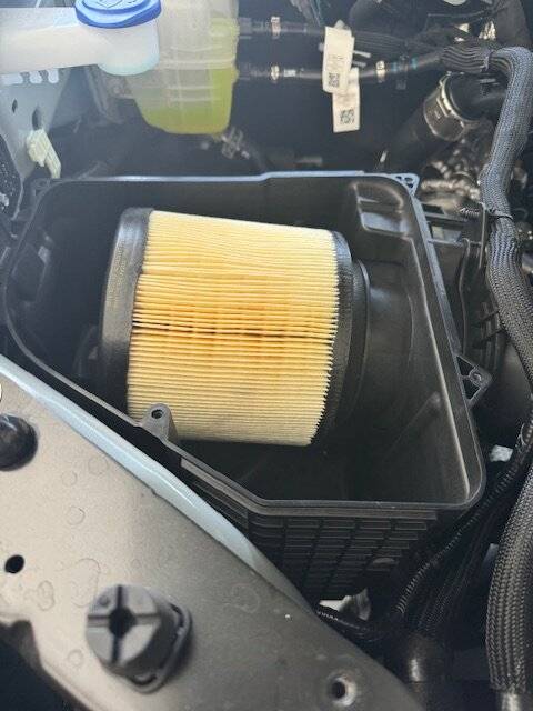

Hello everyone tried out the SB air intake filter for the 2.7 Bronco on my 2.7 Ranger and it does work, it's a little different install process so I will try to detail it out here as well as include pics!

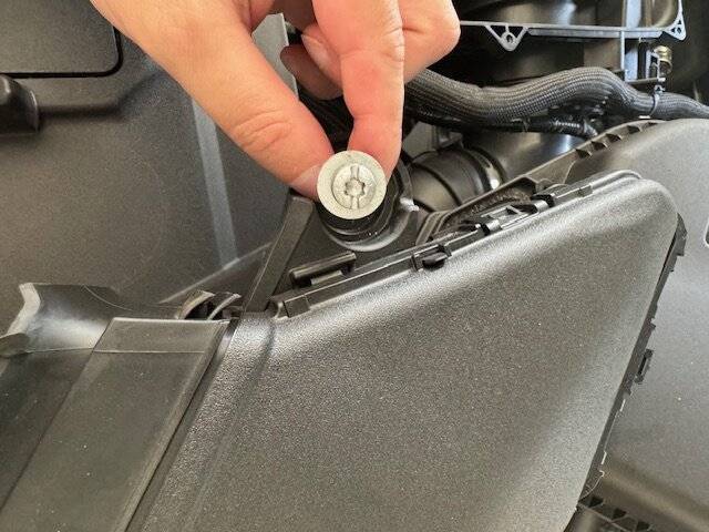

1) Remove 4 Torx30 bolts on the stock air box lid, I didn't use an attachment the bolts are fairly long but came off quick with my power screwdriver.
2) Remove 1 Torx30 bolt for the air intake inlet. This one only has one bolt compared to the bronco, take it off and the inlet comes right off very easy.
3)Remove stock air filter, insert SB filter. The fitment is tight you will have to shimmy/angle it to get it seated but once it's on it's on it's definitely not going anywhere.
There are different ways you can have the air box if you are curious, so I posted a pic of that as well just for fun
