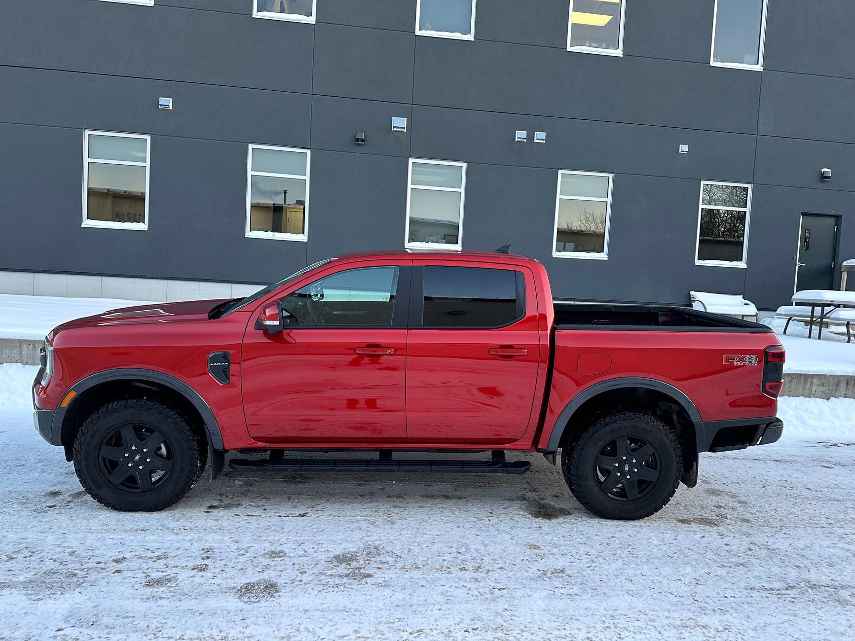

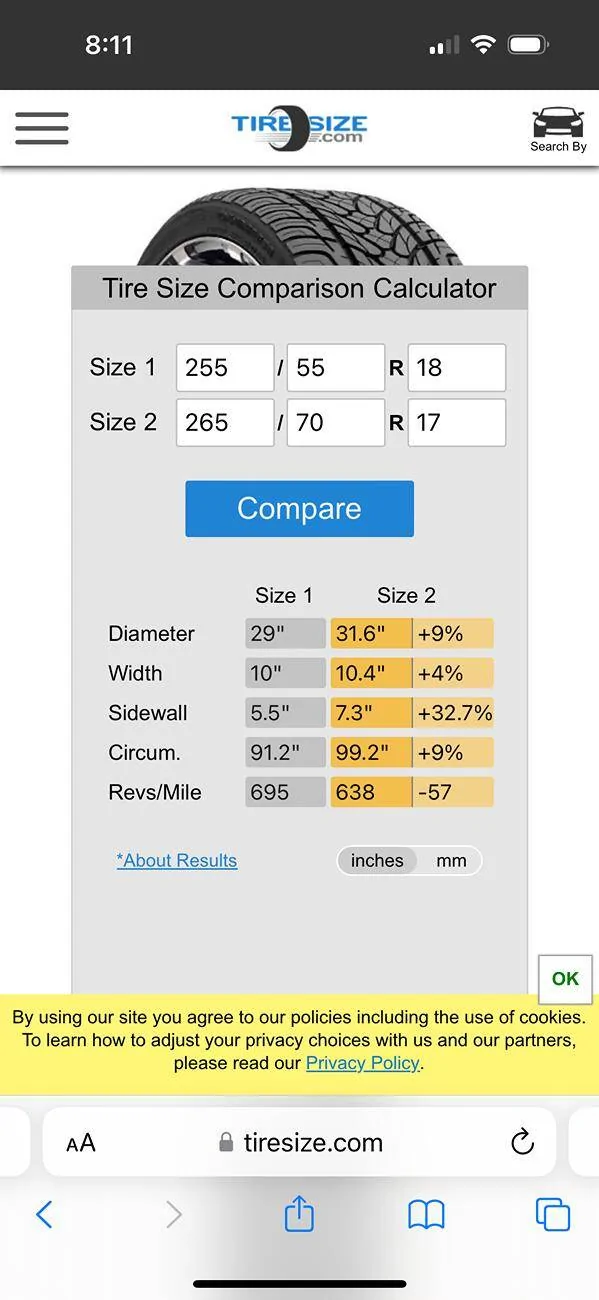

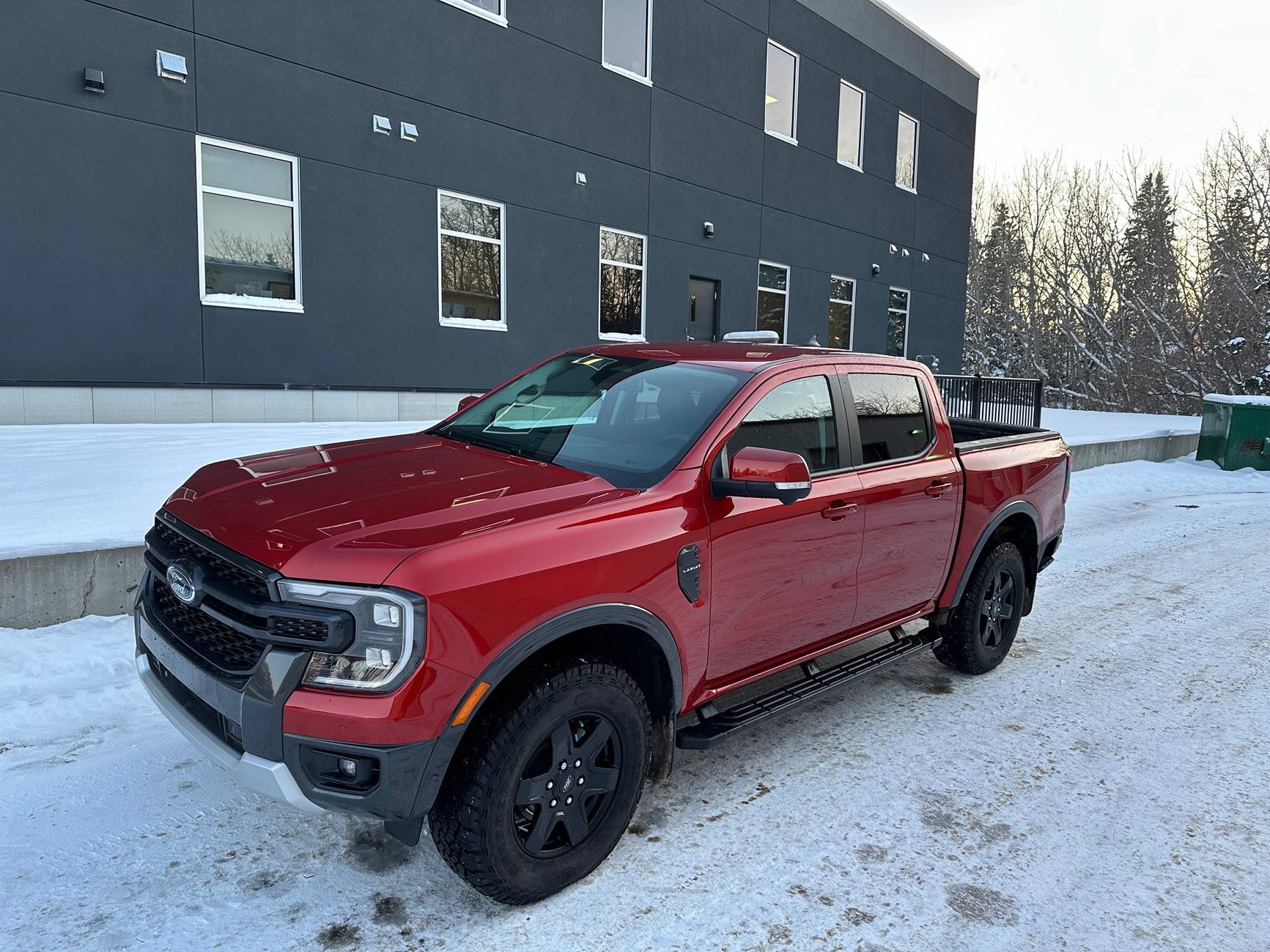

Here is my Lariat FX4 with 265/70/17 - take offs from a Bronco. Same offset and wheel width as the OEM 18’s. Not in love with these wheels. Might change it up in Spring.
Greetings. So happy to see your post! First of all I like your truck! I've been trying to find someone who's running 265/70/17s on stock wheels & FX4 suspension. Could you please confirm your wheels are 17x7.5JX55s? What brand/model tires? Have you encountered any clearance or other issues?
Thanks!!
Danager
Dan
May 10, 2023
78
112
Alberta
2021 Ranger Lariat Tremor Crew - Cactus Grey
Manager
Thanks for the compliment on the truck!
I deleted the pics I took of the back of the wheels. I can say, when my son and I were swapping them, we checked the bore diameter (same), back spacing (same) and width (same). Everything looked good compared to the new OEM 18” wheels wrapped in 255/55/18. We then put on the driver front, checked clearance to the UCA, then turned the wheel lock to lock and checked for any interference. Everything cleared. Moved to passenger front, did the same. Then did the rears.
The tires are General Grabber ATX. I had these as stock on my 2021 Ranger Tremor. I picked this set up as a replacement and then ended up trading in that truck.
No issues in the month of running these. They are quiet enough, and pretty smooth. Just know, you NEED mud flaps if you go with these tires. They throw rocks like crazy.

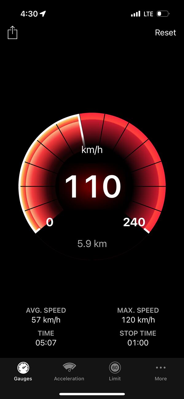

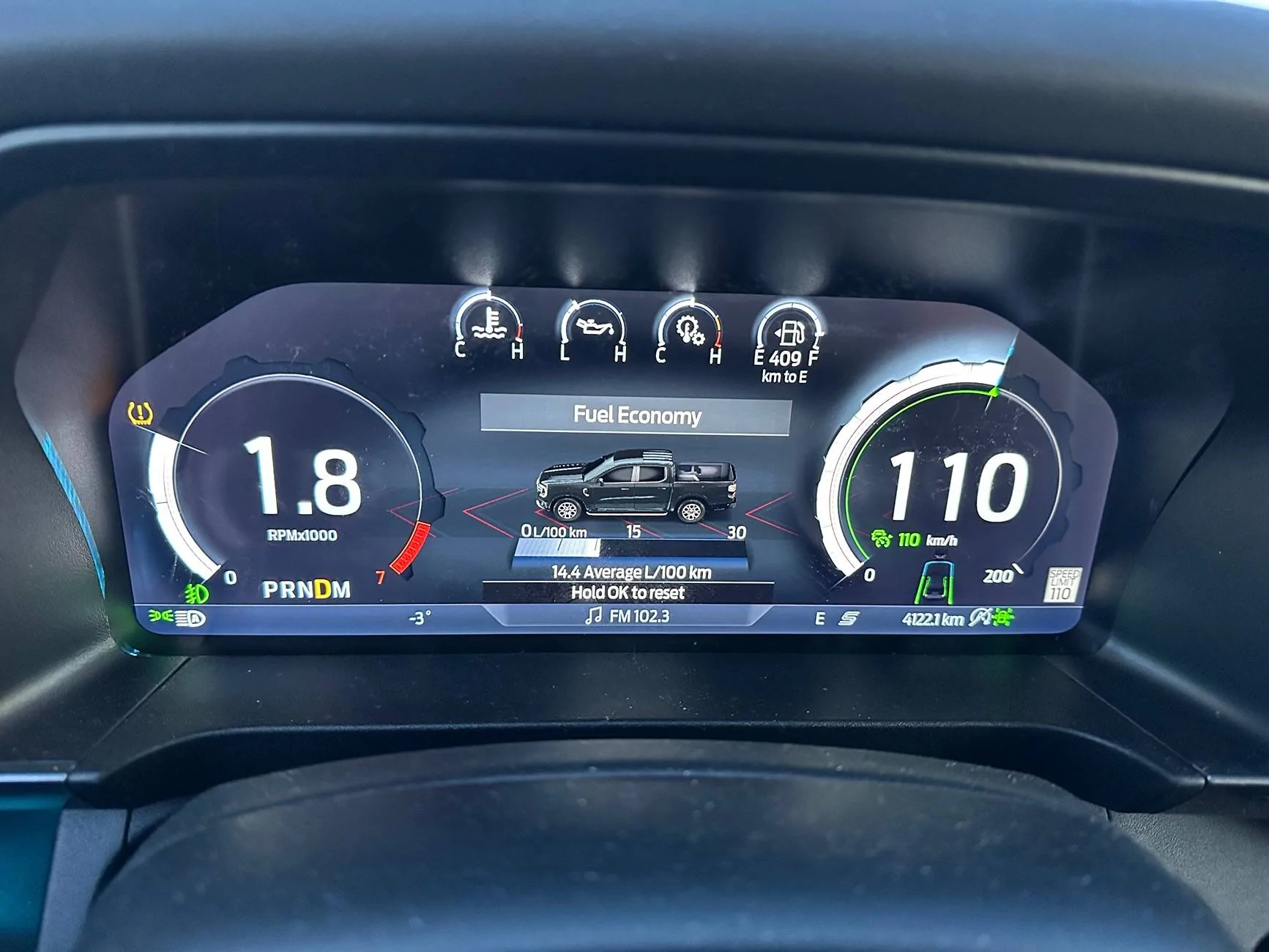

I’m a bit North of you - Edmonton Alberta.
So, I checked my speedo against a gps speed app. Long, straight, flat section of highway. Seems odd that it’s a dead on match after I changed the tire size.
