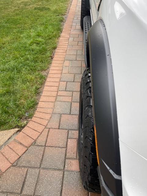

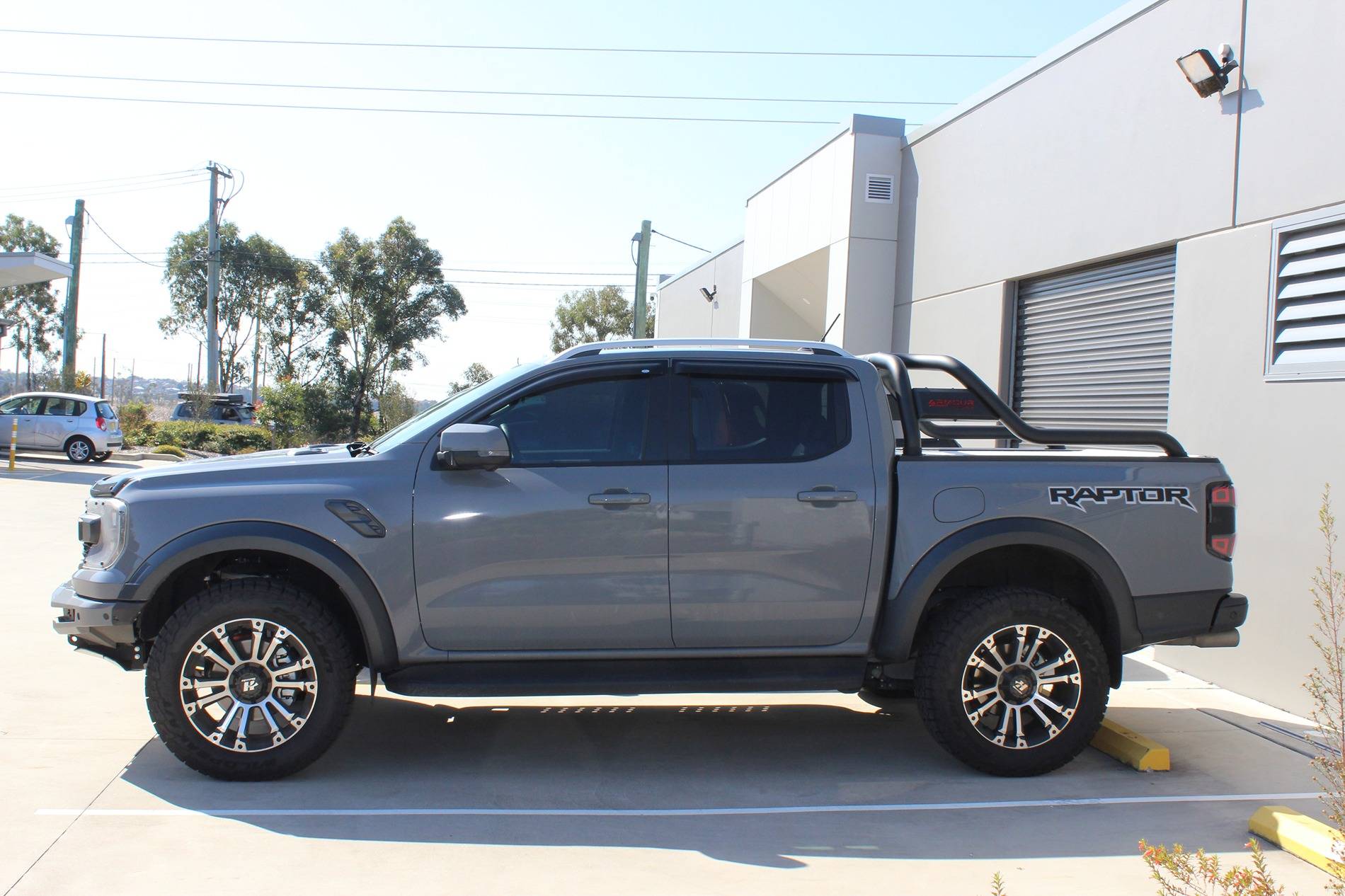

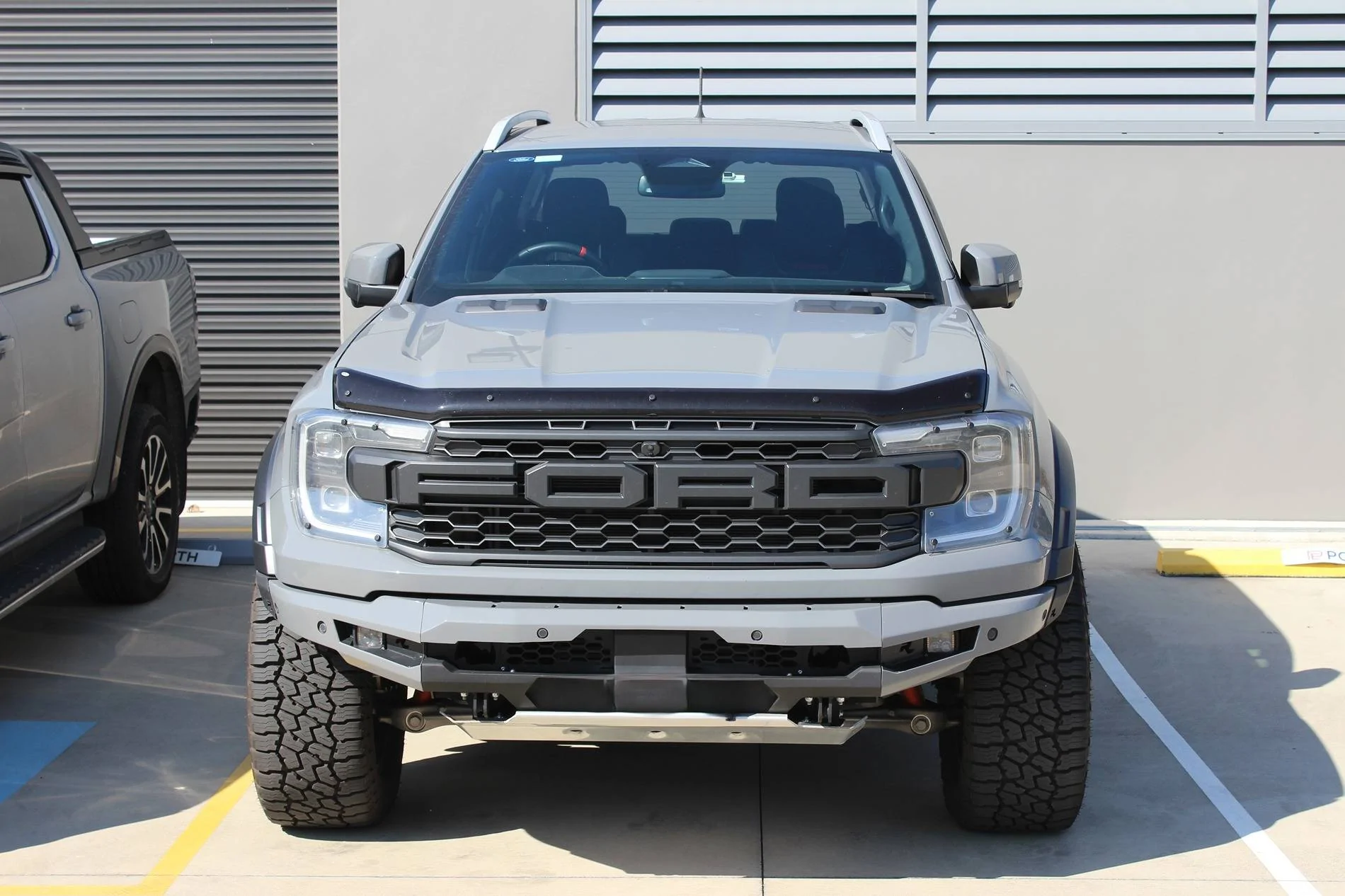

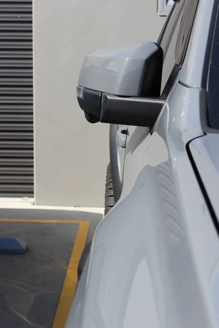

jstyles
Feb 3, 2024
Warners Bay, NSW AU
Next Gen Raptor
Hoping not to break something

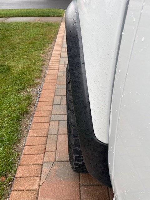

This is mine running +30 with a Falken Wildpeak AT3W 305/55 R20. Being in AU we are not allowed any poke and max 50mm increase in track (mentioned above). I have been 'inpected' by the police with this setup and walked away without any issues, there is very small poke, but track is +50mm, so all good. When I originally ordered the wheels I planned on a 285/60 R20 but US only tyre size which would eliminate the slight poke shown.
This scrapes ever so slightly when articulated and on full lock to the mudflap, but no drama so works with no mods.

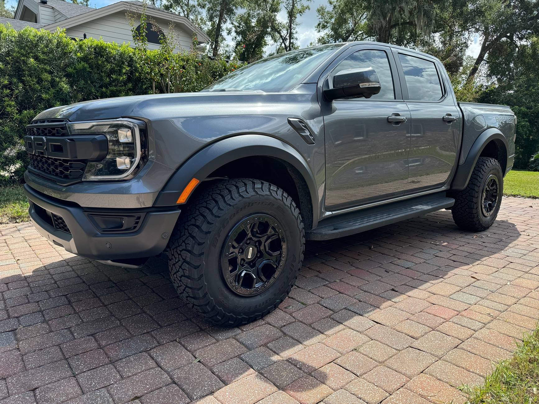

jordan61793
Jordan
Oct 18, 2024
Yucaipa, CA
radilogic technologist II
I run 0 offset and it rubs when I off-road hard.
I will try going back to to +55 or a +25 and see what happens.
I didn’t swap to the bigger tire yet, but I went with the kmc ims 17x8.5 +25mm offset on the stock k03.

Cosmetically thats the correct amount of poke

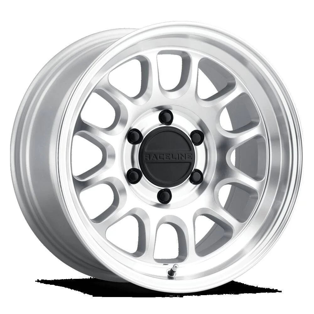

Please no 80's jokes about the machined aluminum wheels. I want to get these wheels for my Ranger Raptor and keep the stock KOs on them. They have a +35 offset, do you think I will have rubbing issues with off roading, mostly mild off roading ?
My new +25 Race-line bead lock wheels do not rub.
I don't think the +35 will do so as you are getting close to the OEM offset.
