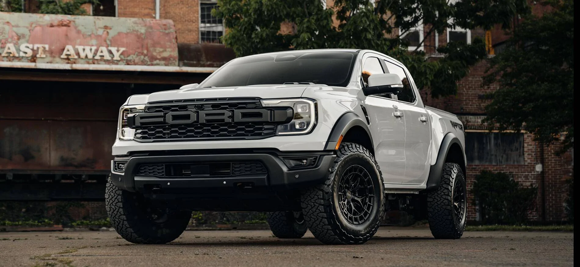

Both of these are zero offset, I think some places say technically +1. 17”x9” put factory k03’s back on them. Vossen did a photoshoot on these so there’s a bunch of pictures. More pics

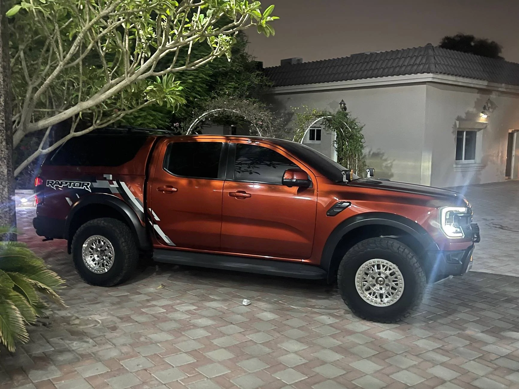

The +25 worked just fine and they are bead grips, I got 2 pop outs in the desert on 14 psi which i did not like might go with the Raceline bead locks +25

i went with Methods Beadgrip since its something in the middle, didnt wanna go full on beadlocks. however the 0 offset it bothering me.
This wheel felt way better since its a hub centric wheel.
