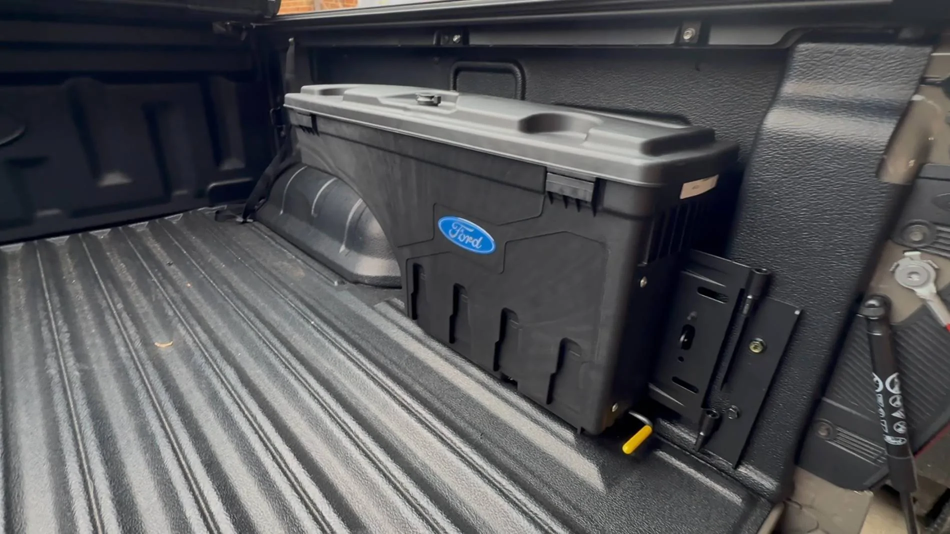

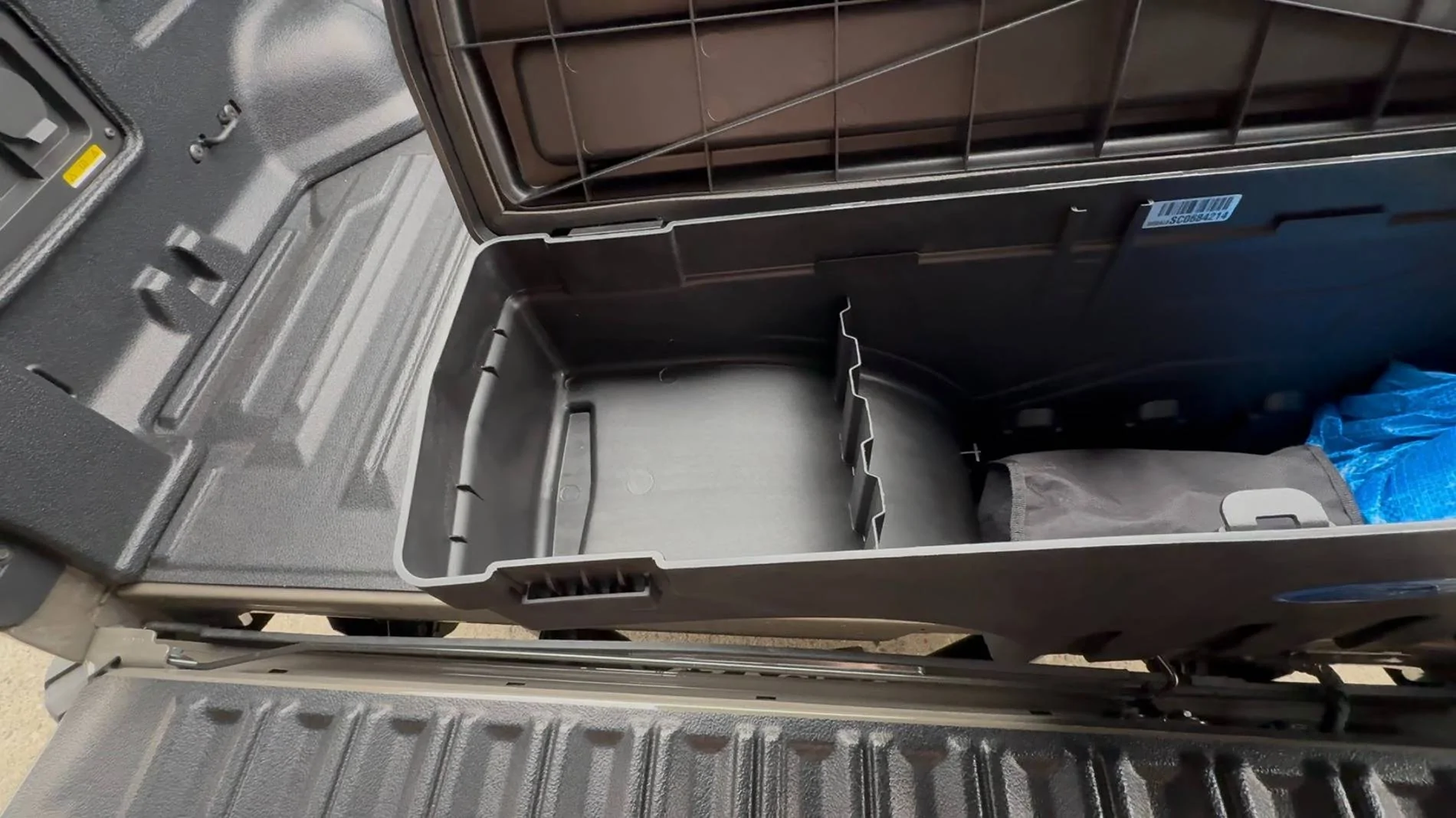

UnderCover Pivot Storage Box in my 2025 Lariat. Install was annoying.

Yes. It comes out very easy.

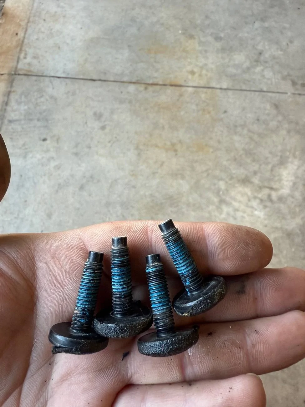

My install issue was removing the tie down bracket bolts. One head broke off leaving the bolt in the hole. Still trying to figure out how to get that out.
Exact thing happened to me. Bolt sheared off backing it out and Ford won’t do anything about it.

I work finance for a company that owns 8 steel and iron foundries. Went to one of the sites and maintenance department said they could get the bolt out but probably couldn't save the threads. I will have to figure out a way to brace that new bolt. Not the end of the world but definitely annoying.

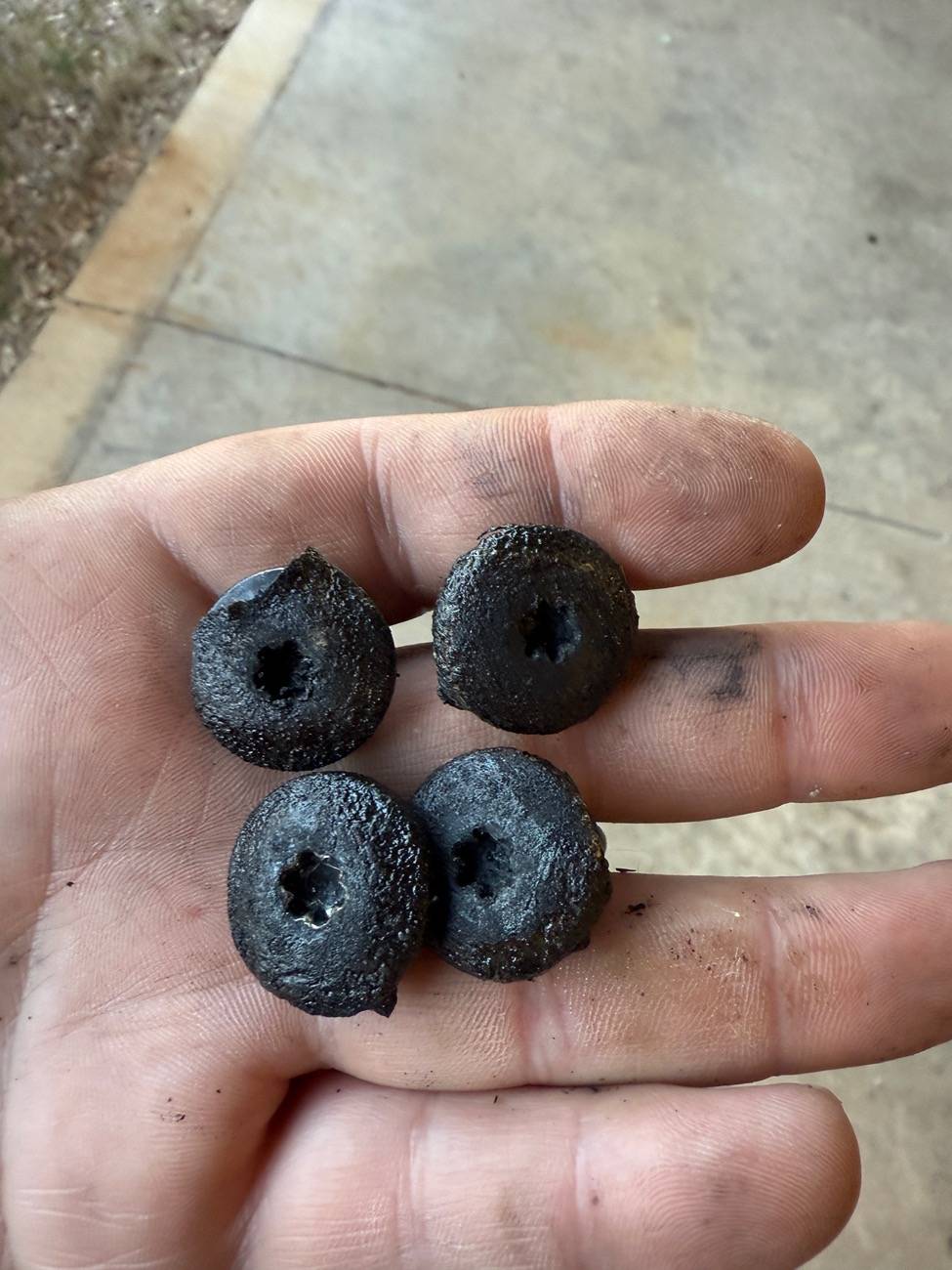

Depending which bolts, I was informed by my installer that most of those bolt holes are not threaded. They are self-taping bolts from the factory and that is why they are such a bitch to get out. Took me time and patience as I slowly heated them. Got them all. One stripped the Phillips screw head, and it was out enough where I grabbed it with vice grips and slowly turned it out.
Just go slow and take your time.
