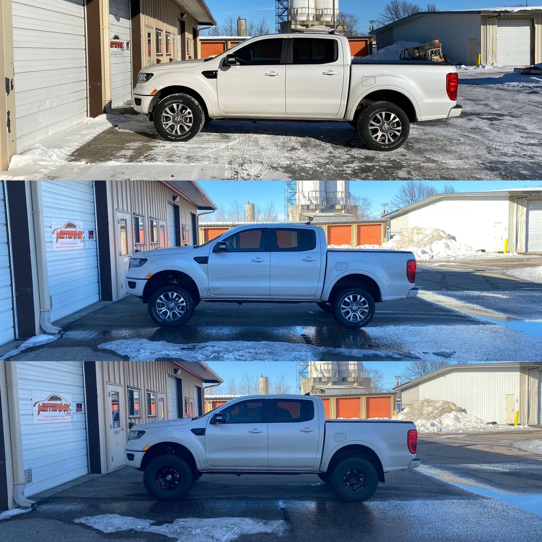

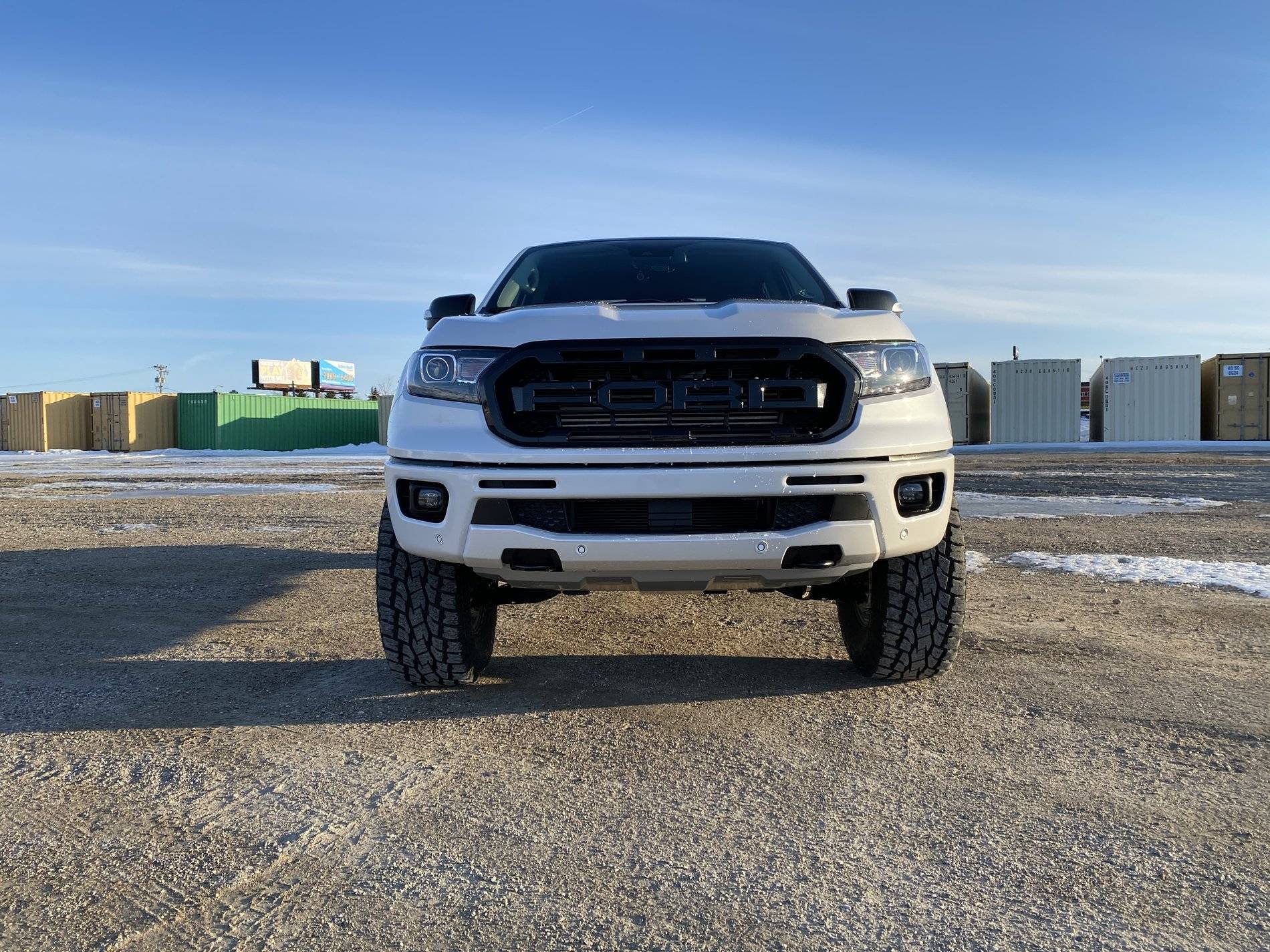

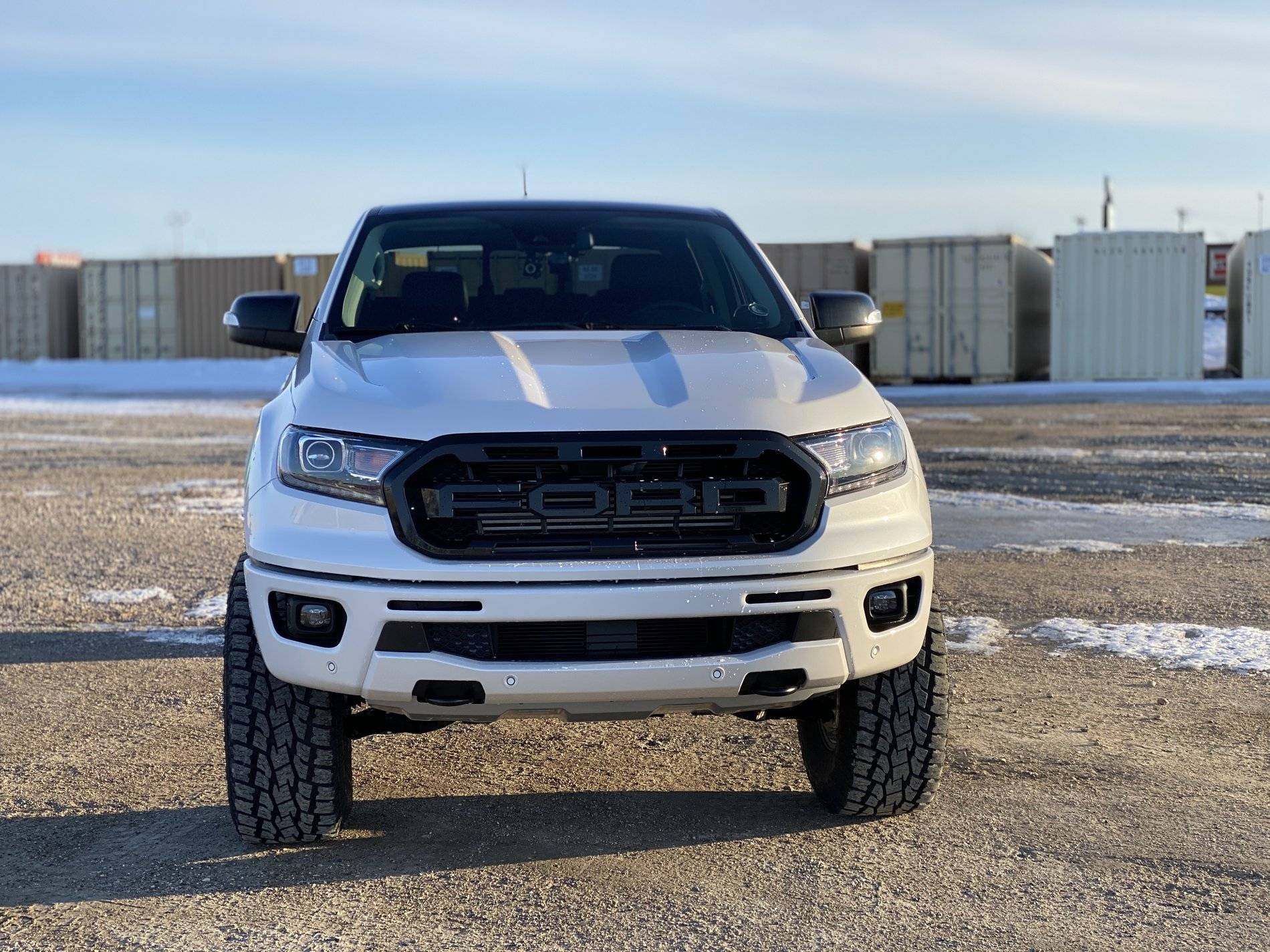

Lift is all finished up, Rokblokz installed along with my aftermarket wheels and tires. I have a bunch of pics but will start with before and after. Top is stock, middle is lifted on stock rollers, bottom is lifted on my aftermarket wheels/tires. Pics will all be kinda crappy due to varying lighting and it’s impossible to keep a vehicle clean here right now.

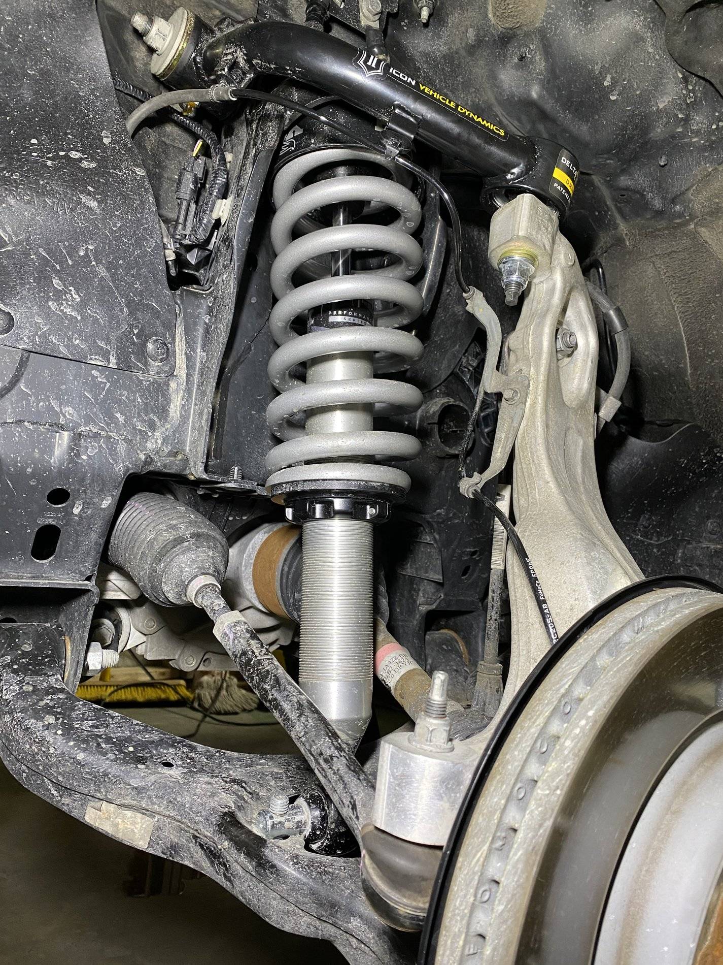

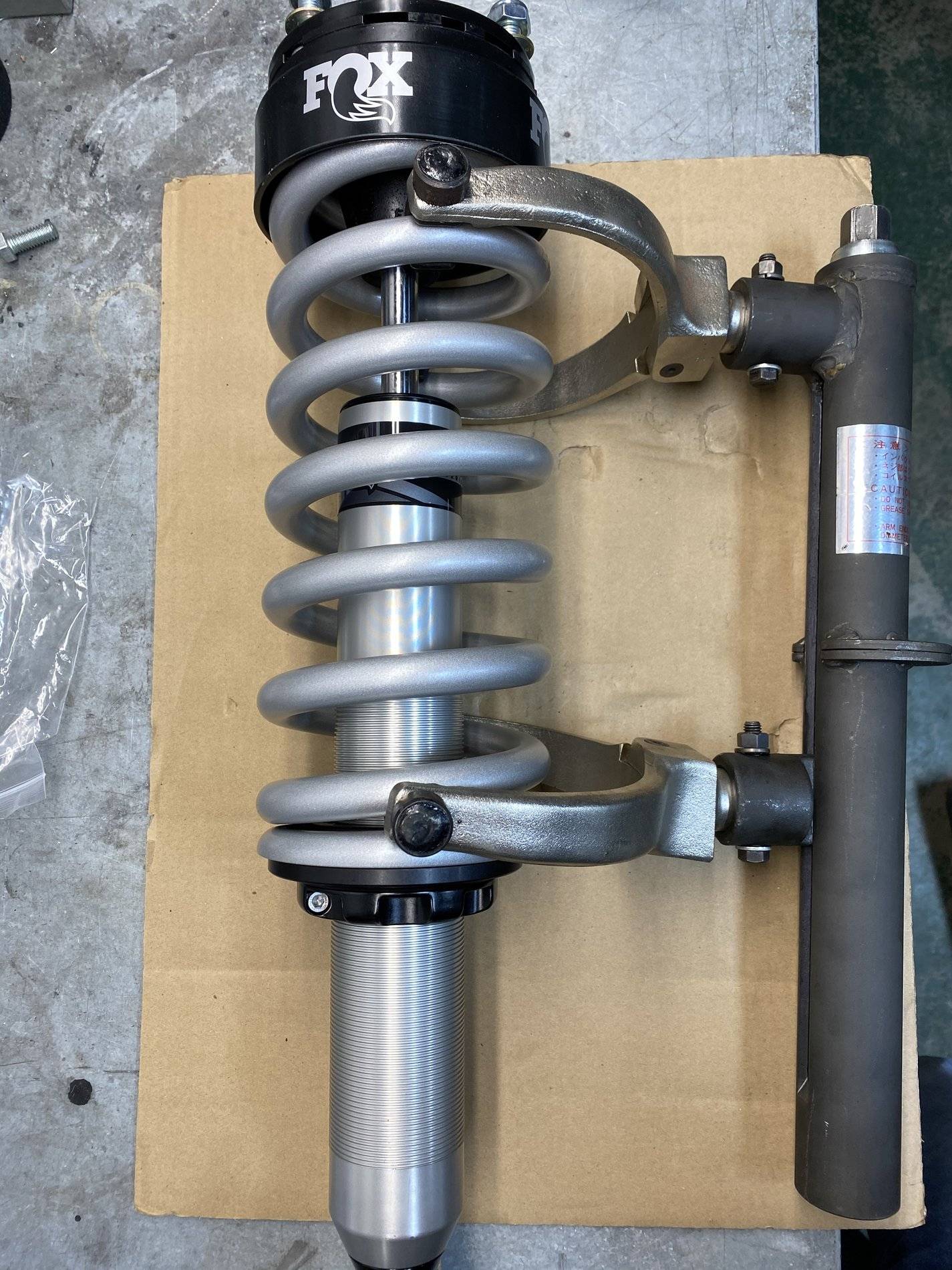

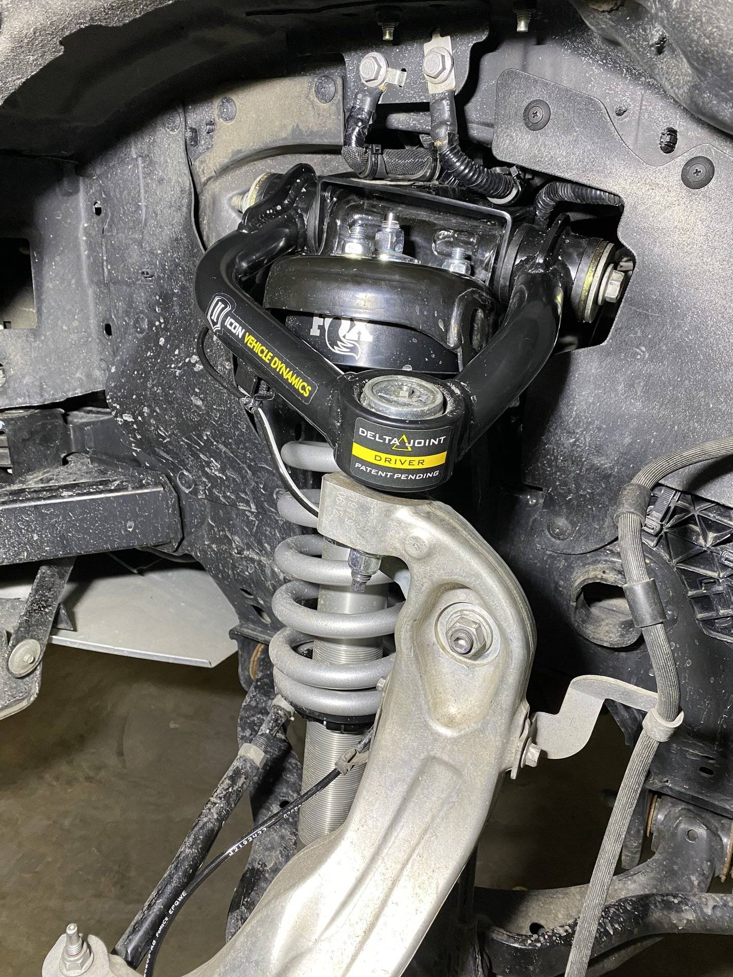

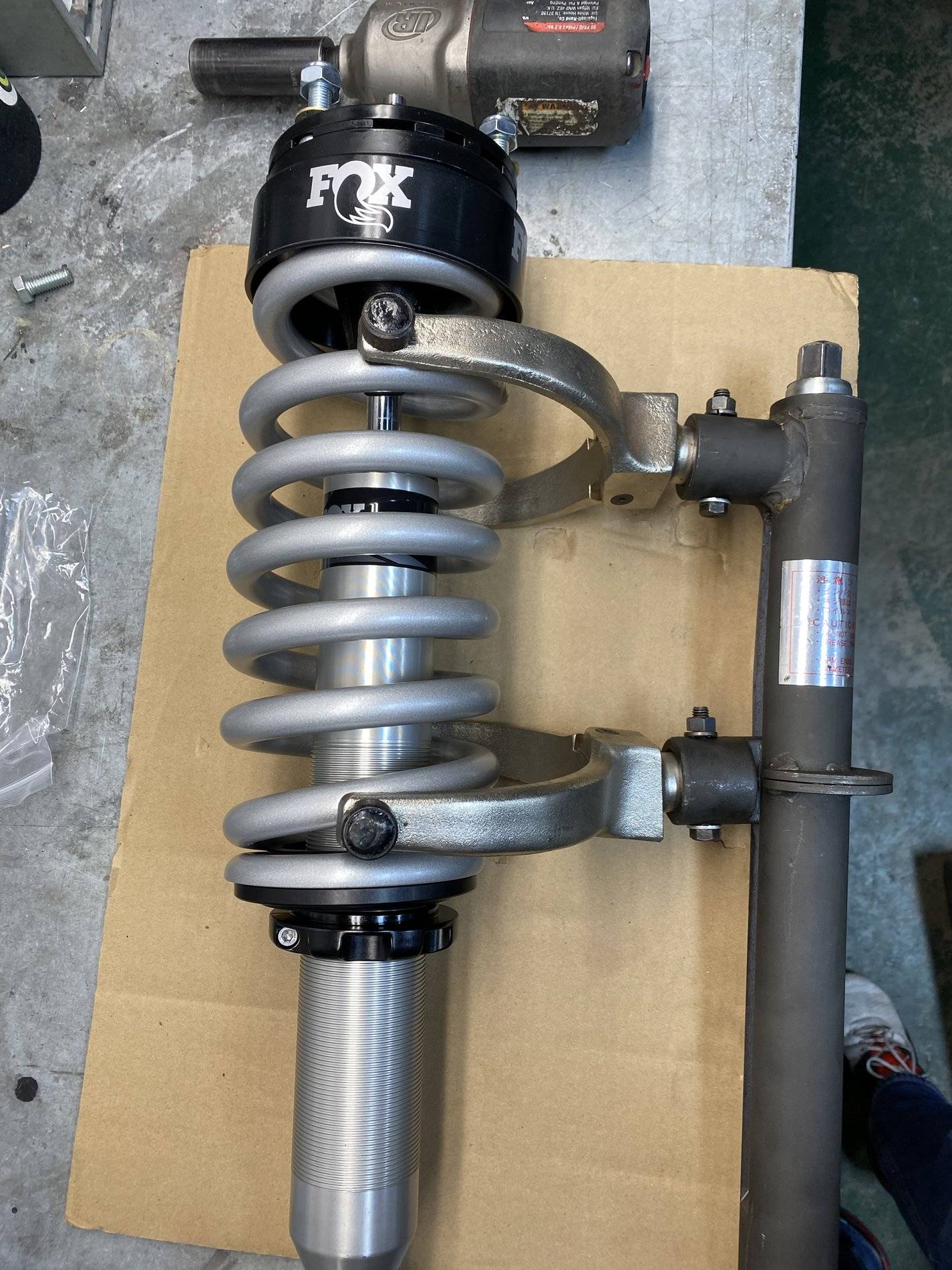

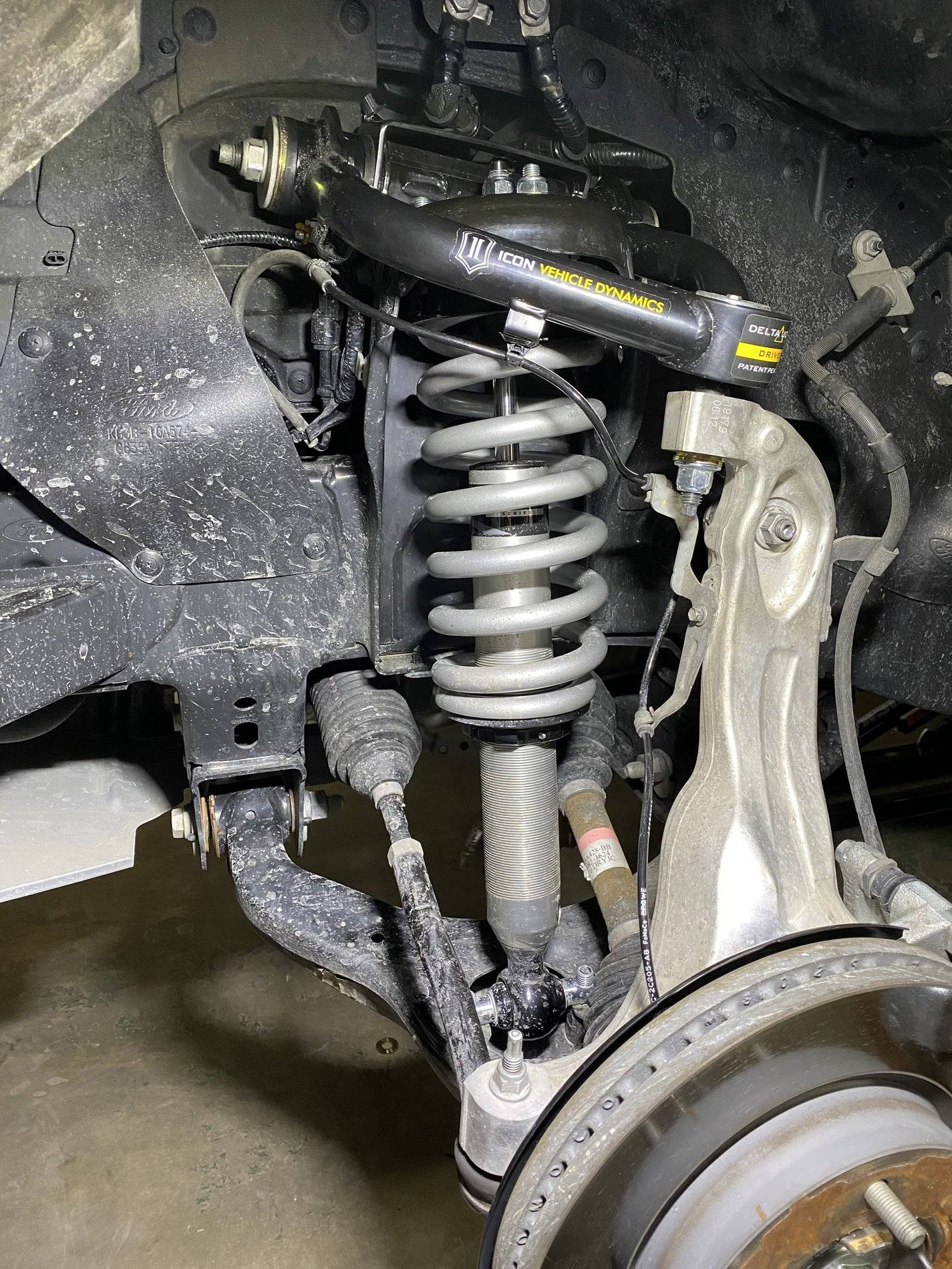

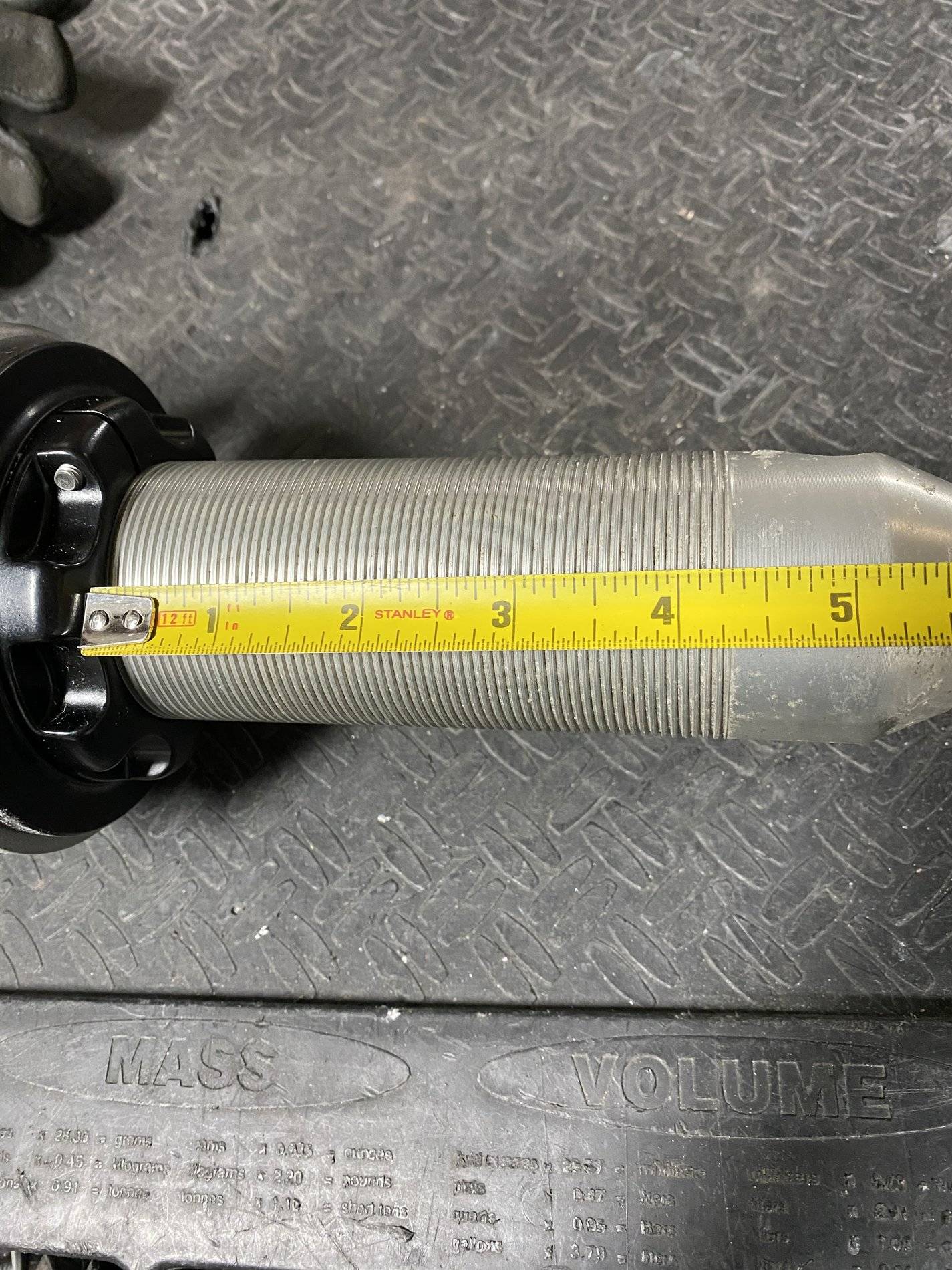

Here’s a few more pics from install and completion. I ended up adding quite a bit more preload to the Fox coilovers in order to achieve 3" of lift. I thought they were supposed to come set at 3" but they were set to 2". Of course I forgot to take measurements of the wheel well heights after lifting but with stock wheels/tires on ‍♂.

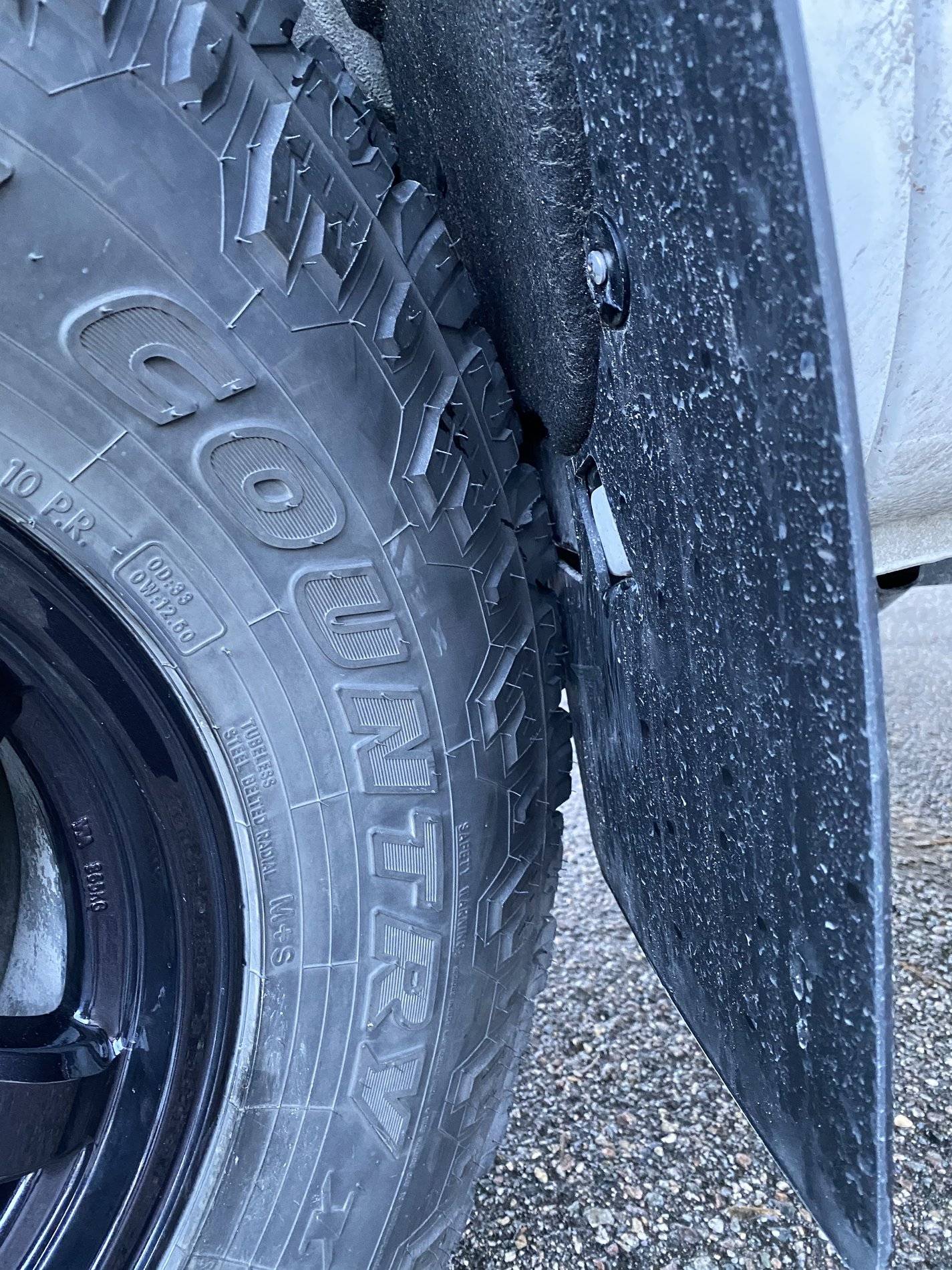

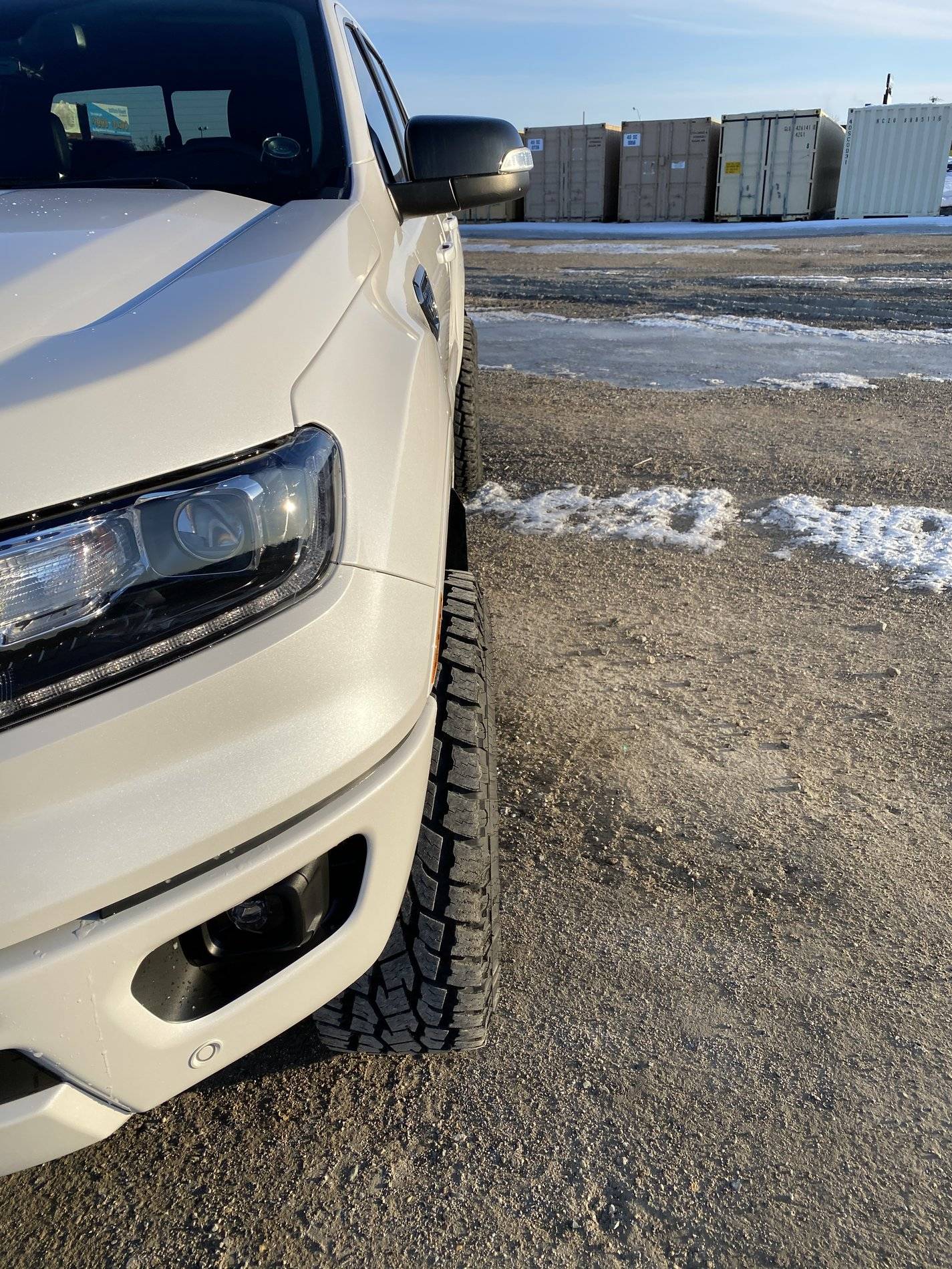

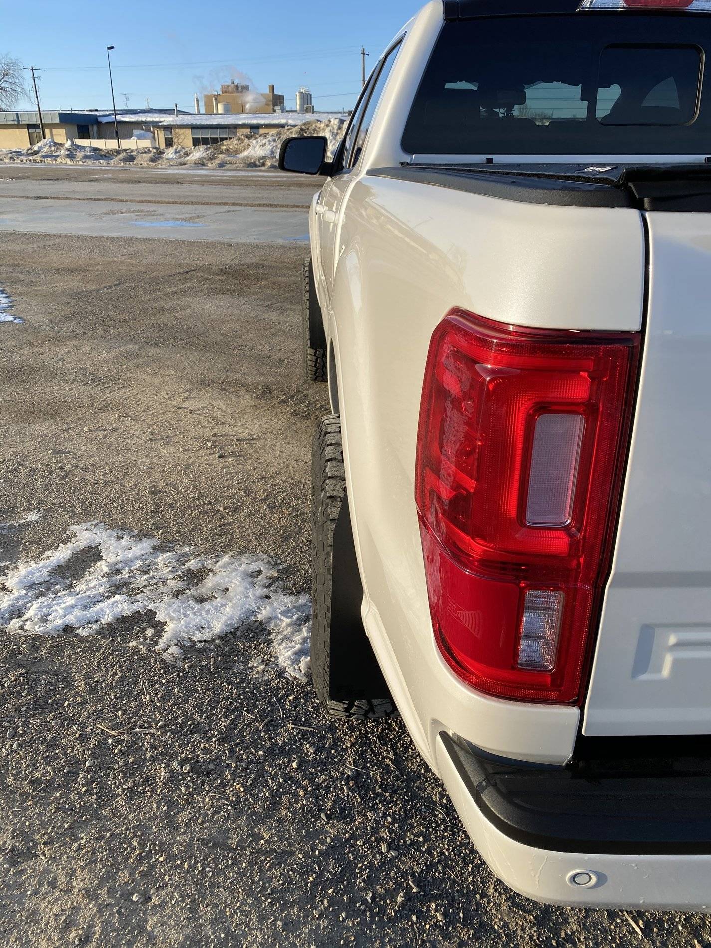

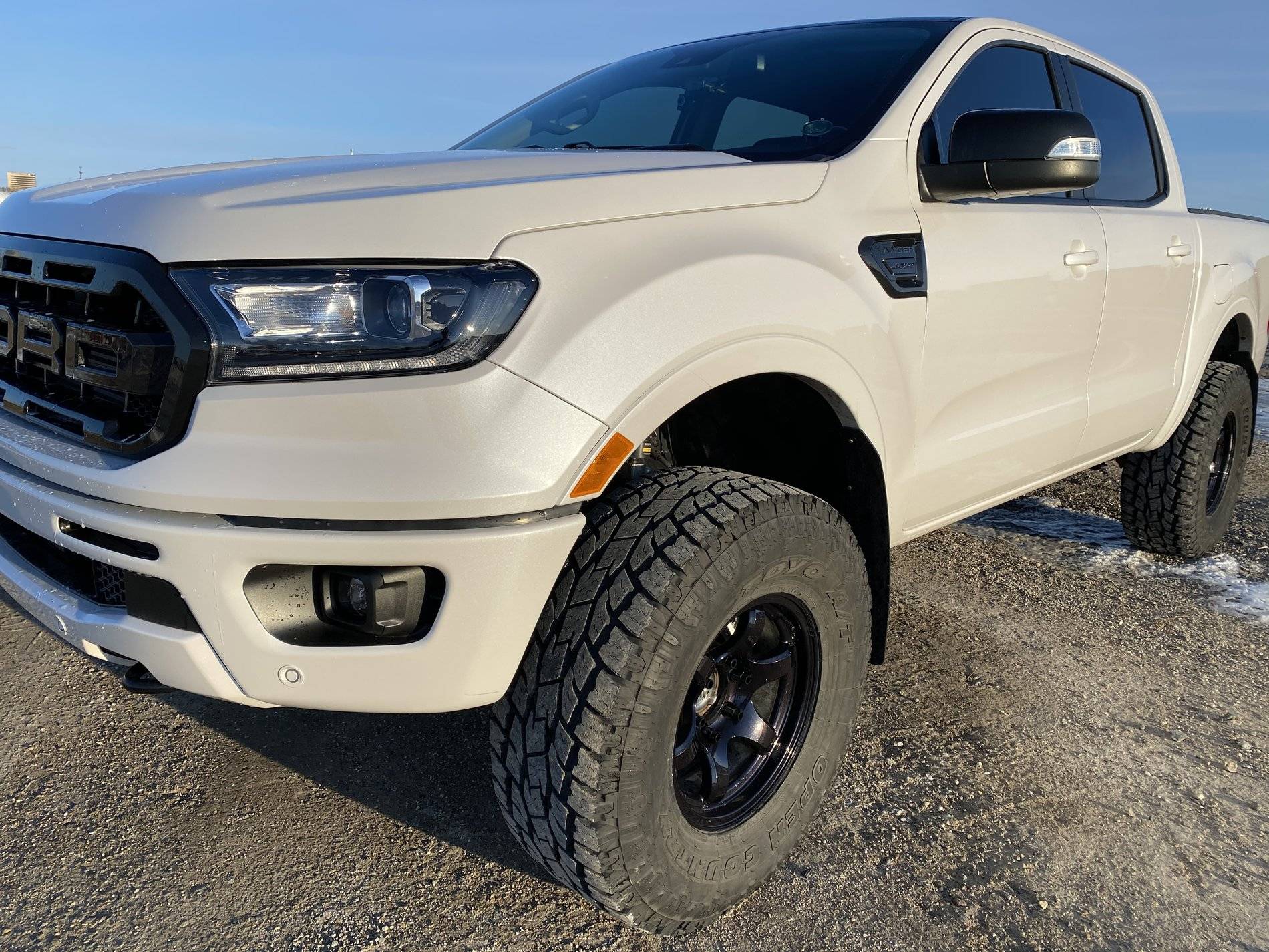

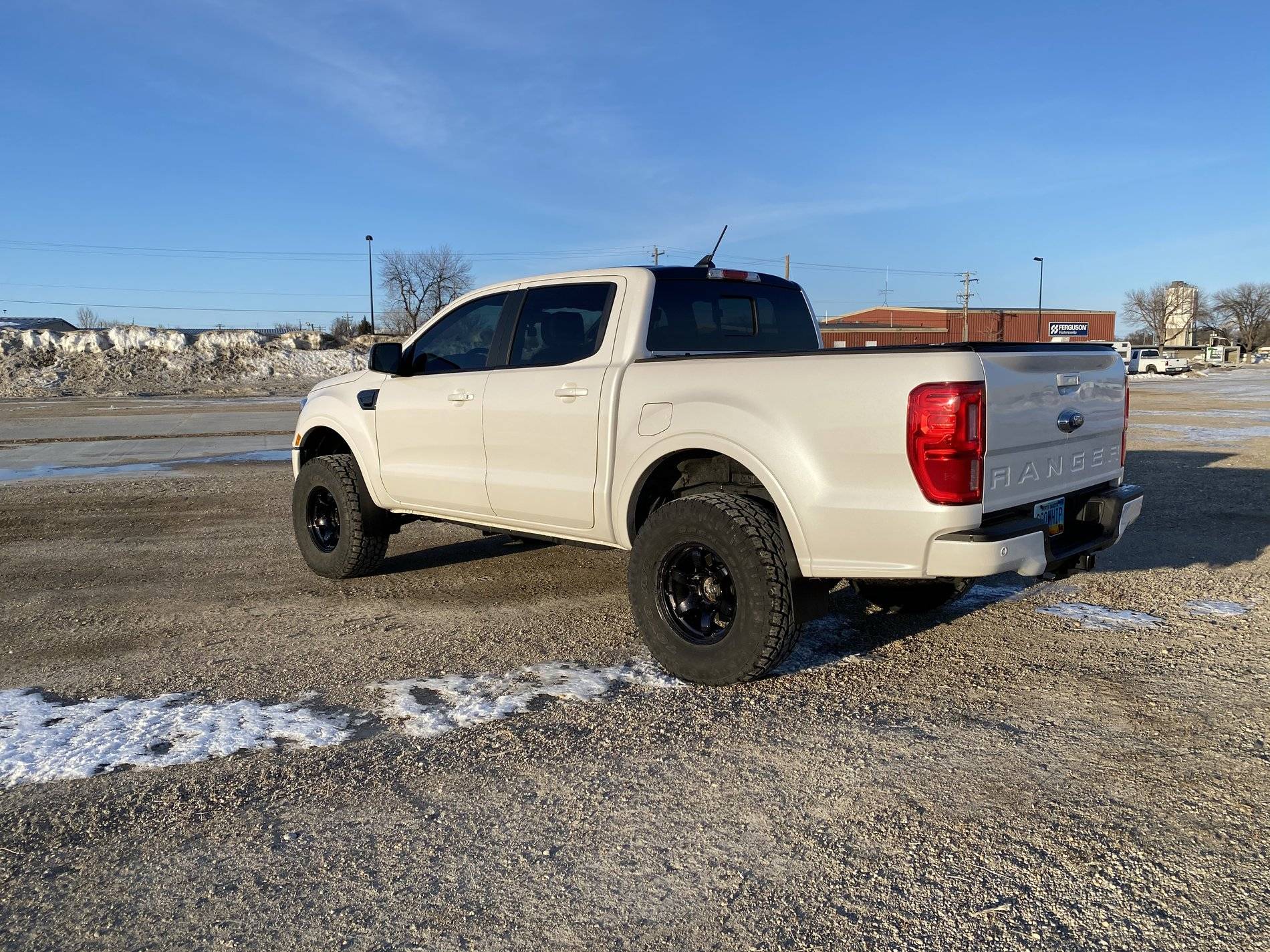

I'll get better pics of the wheel/tire setup so people can see how they fit. The wheels are 16x8 Konig Countersteer Offroad with 0mm offset. Tires are Toyo Open Country AT 305/70/16. Yes they're super wide (too wide) but they fit perfectly on the original truck I had them on (2001 Tundra TRD Offroad). When they wear out I'll step down to 285s. The Rokblokz mud flaps fit well and almost cover the extra width of the tire that is out past the fenders. The tires rub on the flaps at the rear of the wheel well at full lock, so I need to figure out a way to pull the flaps back a little

Ran through the car wash yesterday while it was sunny and snapped a few quick pics

Did you get a 3.5 inch level stance?
I did end up with a 3.5" lift and level stance. Front to back is within 1/4" so I'm calling it good. I had to add quite a bit of preload to the Fox coilovers in order to get them up that high, but it still rides really nice. The front is a bit stiffer than it was when it was at the factory set 2", but it feels great.
