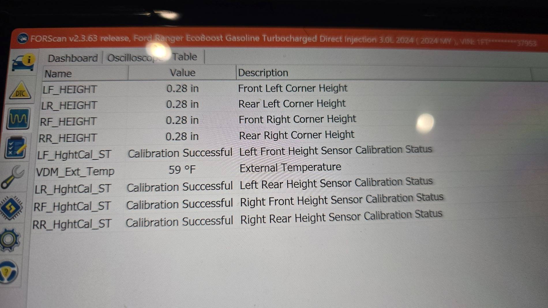

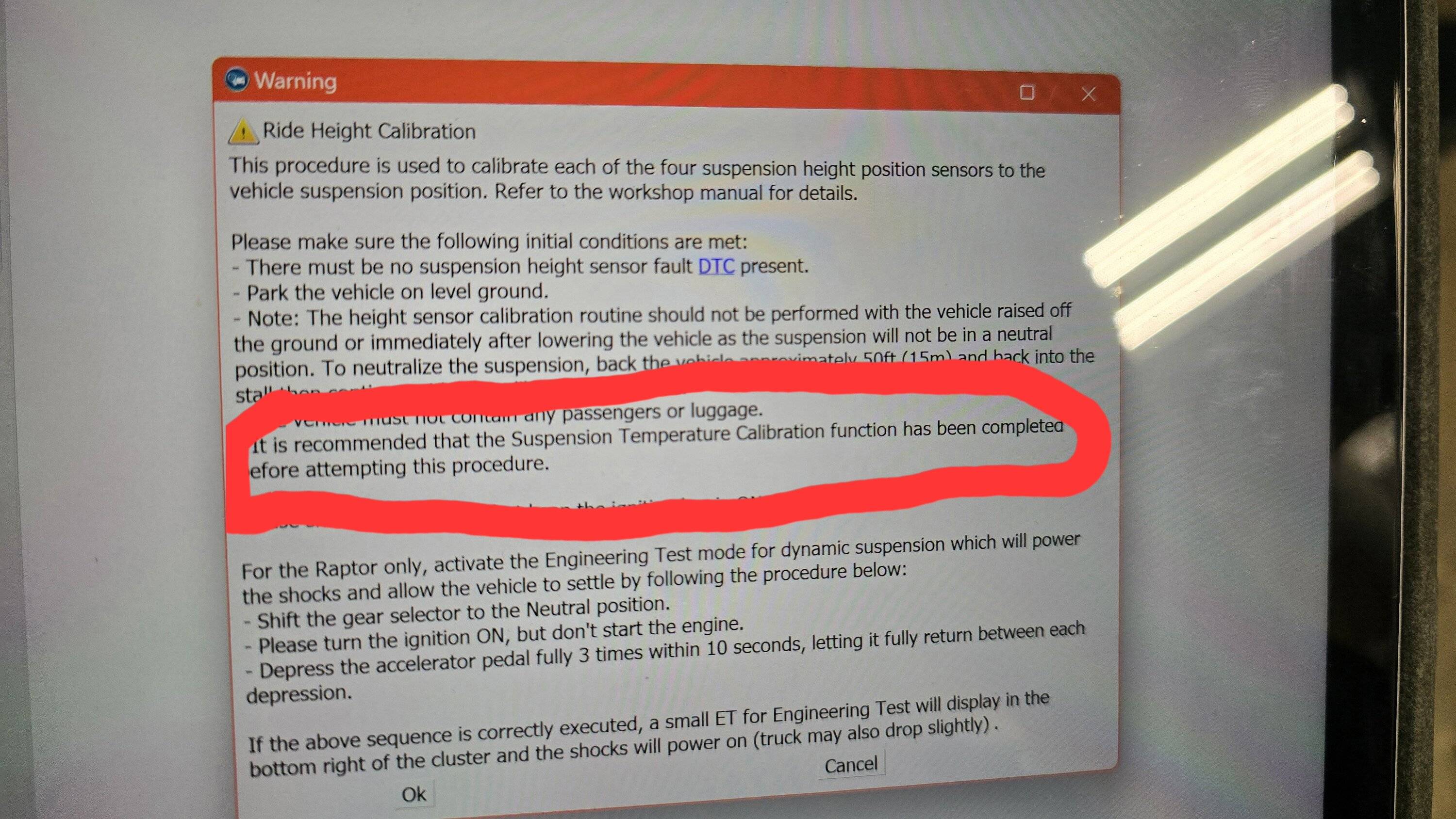

I thought i'd make a post of it's own on this, does anyne know how to do this. Circled in red on pic

In for updates as I did the suspension adjustment with ET mode but not this.
Would love to get mine back to 0mm instead of the current 2mm all around.

Is this a forscan thing? I just did a lift/level kit and even though my shop told me they would take care of re-setting the shock sensors with forscan after installation, they fired the only guy they had that knew how to do it. I was wondering if there’s a way to reset ride height without forscan? Thanks.​

Yes forscan is the only way I know how.

Anyone know the procedure for doing this via Forscan? I did the suspension levelling reset, but had not heard of a temperature reset.
