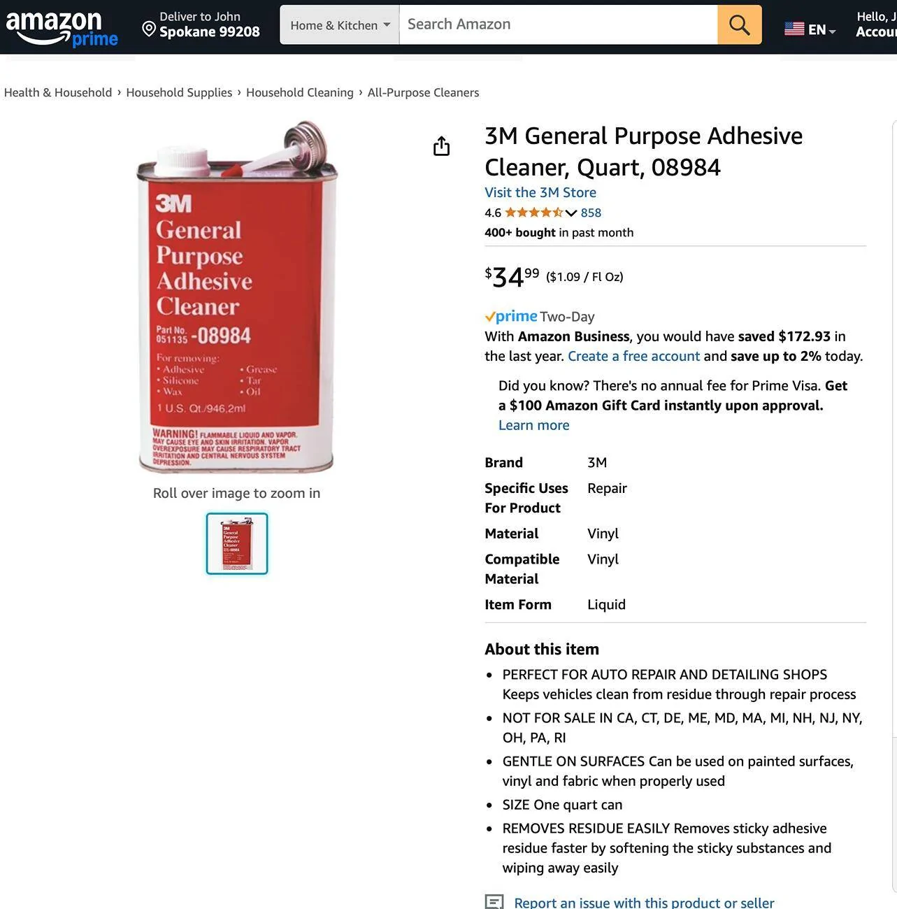

This is great, very gentle on the paint, but it WILL remove wax. Paint shops use it for general pre-painting cleanup. It used to be marketed as "Bug and Tar Remover". I buy it in this size at a local auto body/ paint supply store for $15 per quart. Use with good ventilation, it has some strong-ish solvents, but it won't blow the top of your head off like MEK will.

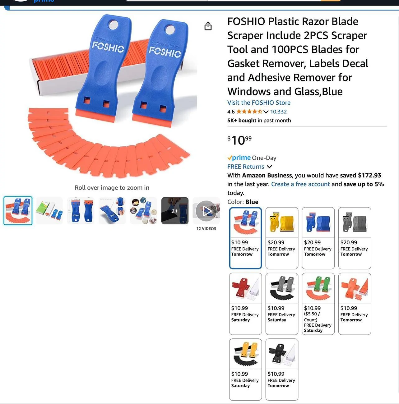

You can chill the sap using ice, it will make it more likely to just pop off with ***gentle*** pressure from a plastic scraper like this:

FOSHIO Plastic Razor Blade Scraper Include 2PCS Scraper Tool and 100PCS Blades for Gasket Remover, Labels Decal and Adhesive Remover for Windows and Glass,
