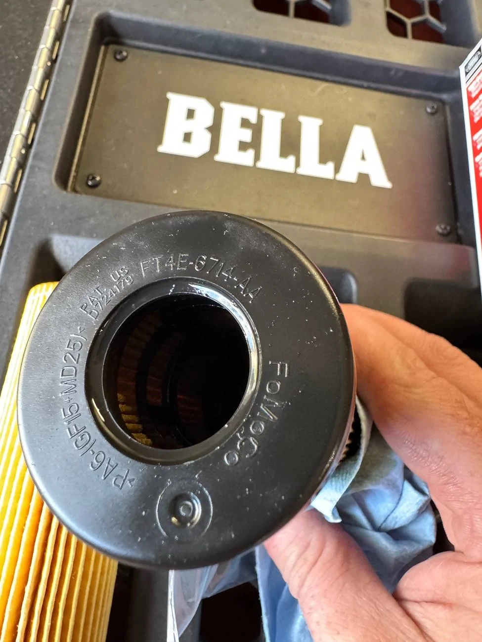

I did find something strange while doing g the change though. The filter I removed was a different part number than what the owners manual calls out. See pic. I took out a 6714, and the manual calls out 2062.
The 6714 part number is the original equipment as built part and the FL-2062 is the Motorcraft service part. They do the same thing on the can filter motors where the original as installed factory filter is a different sourced filter and not a Motorcraft labeled part. It is a easy identifier to the dealership service department if you come in with issues and they can tell if you still are riding on the factory installed oil filter.
