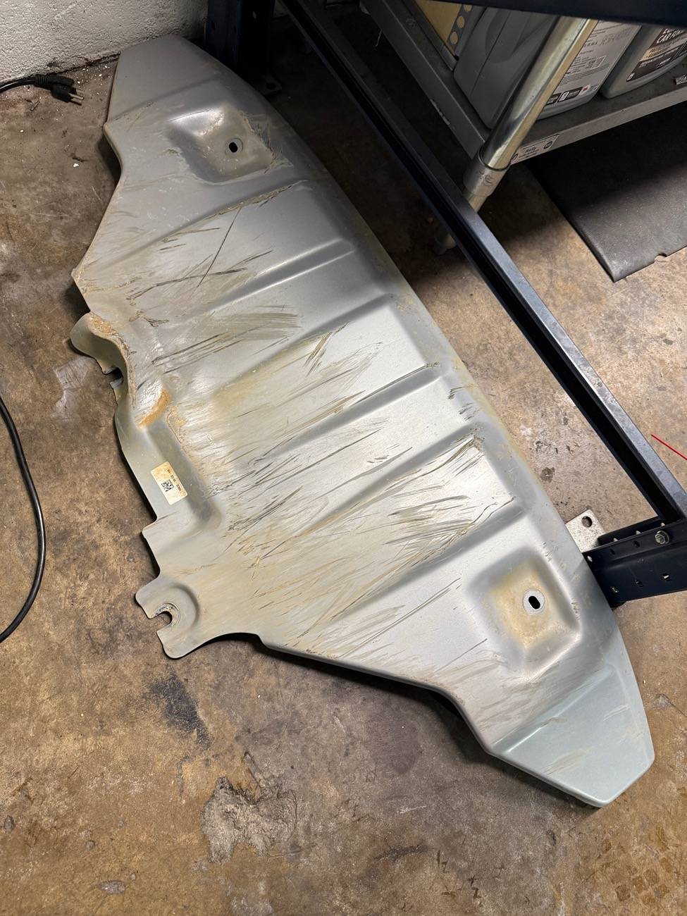

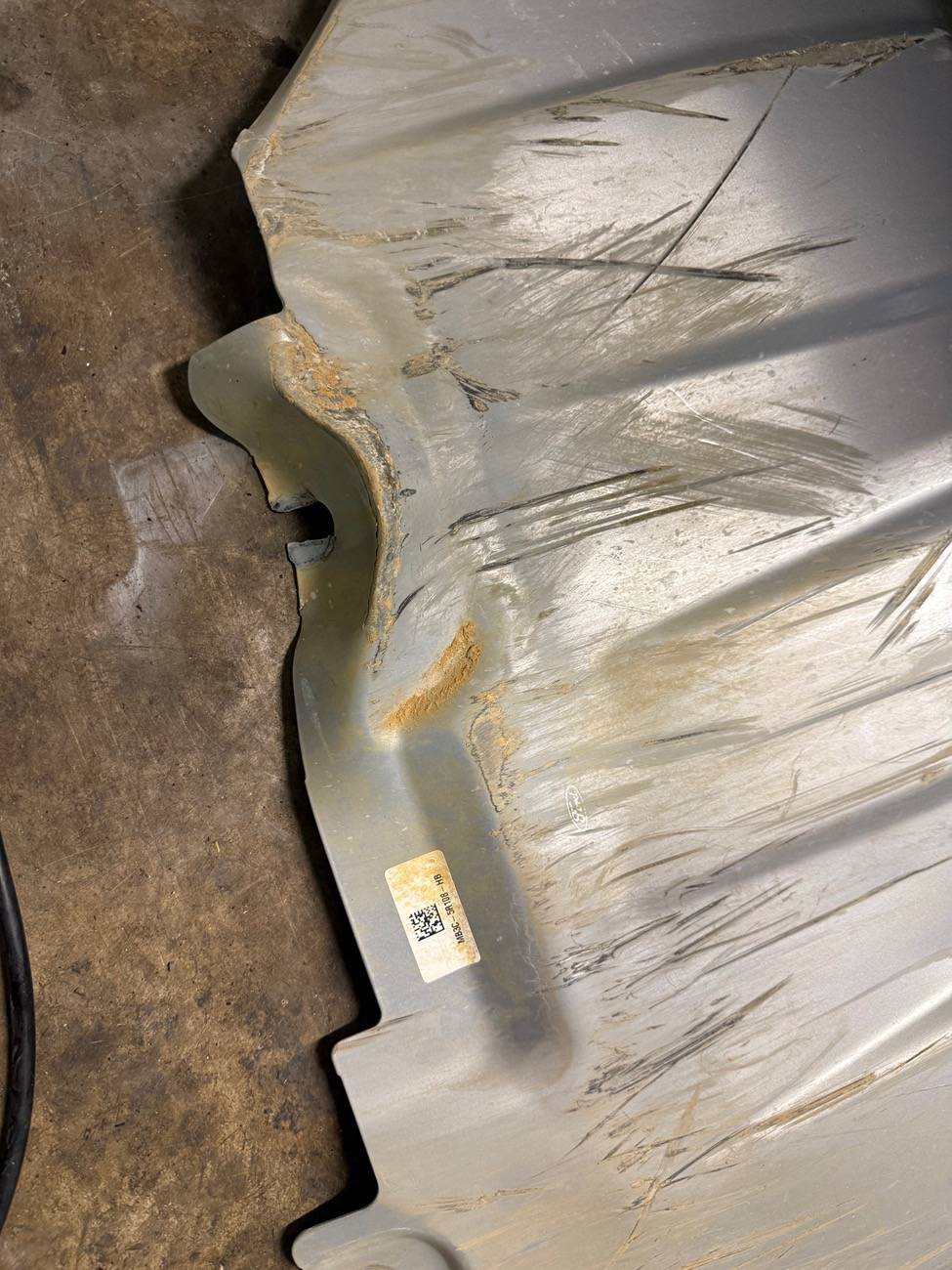

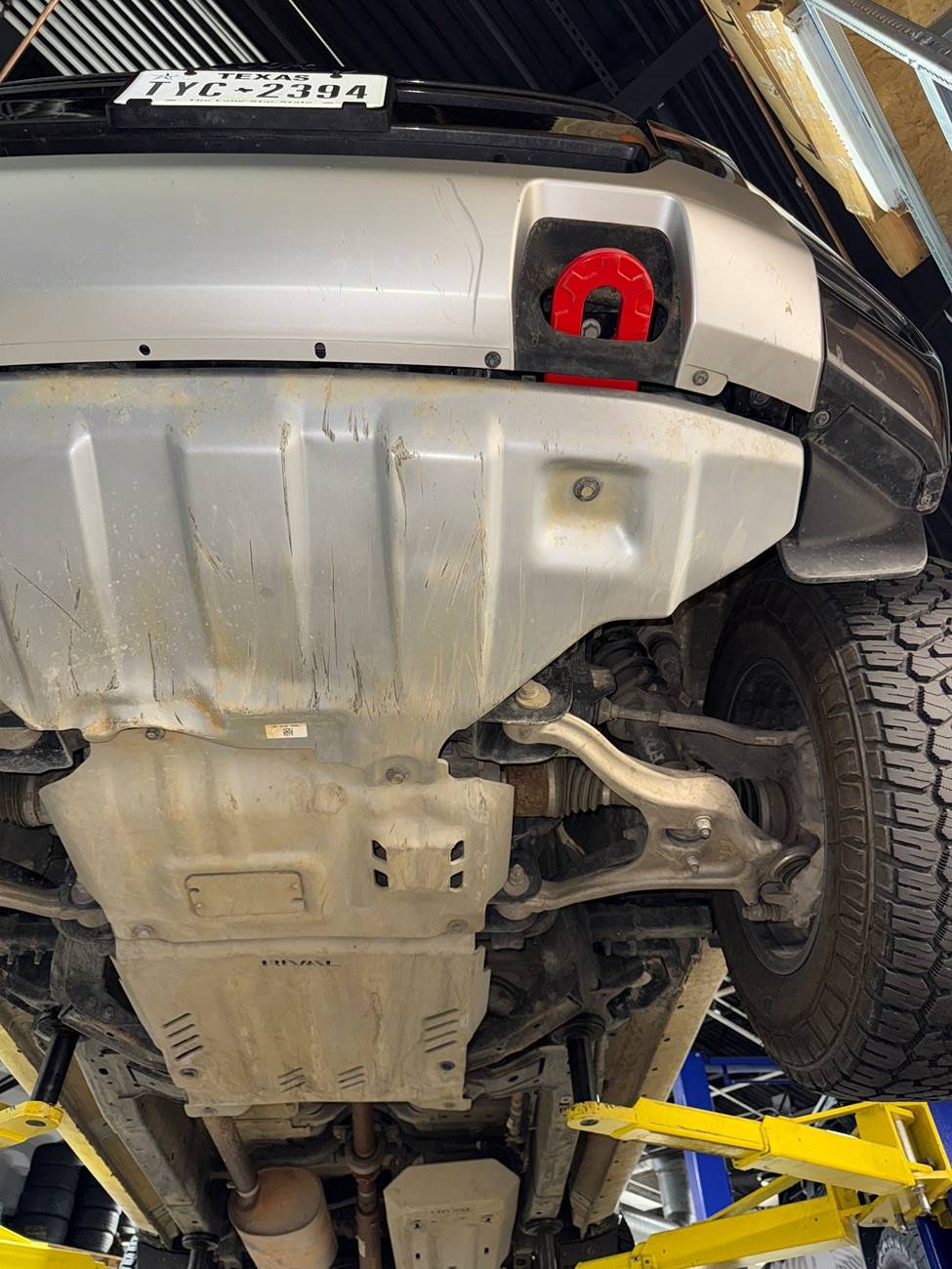

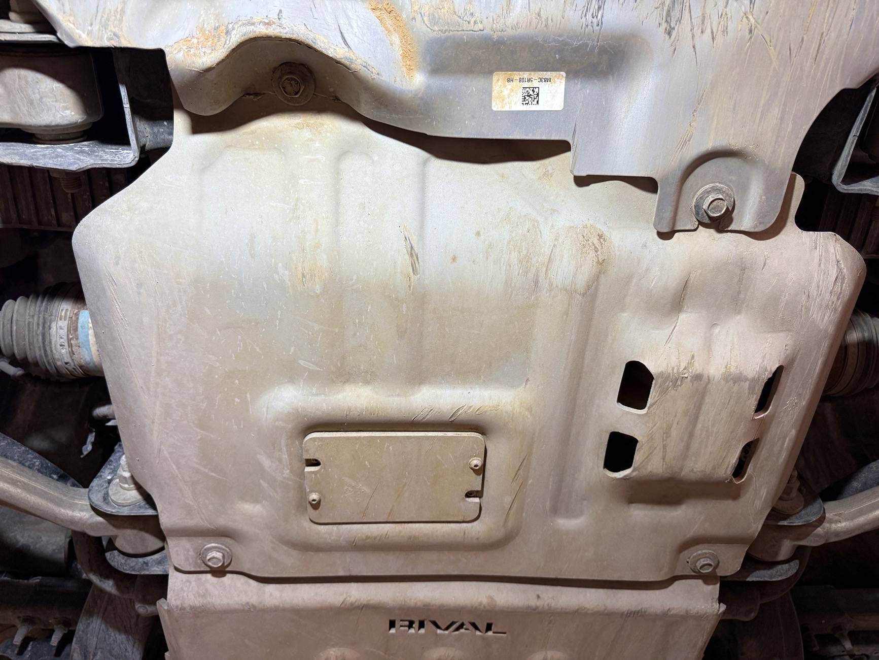

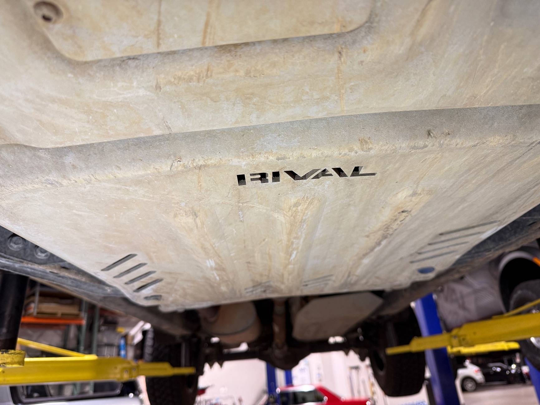

It did. Just got through hells revenge and poison spider with it and I don't think anything has fallen off.
