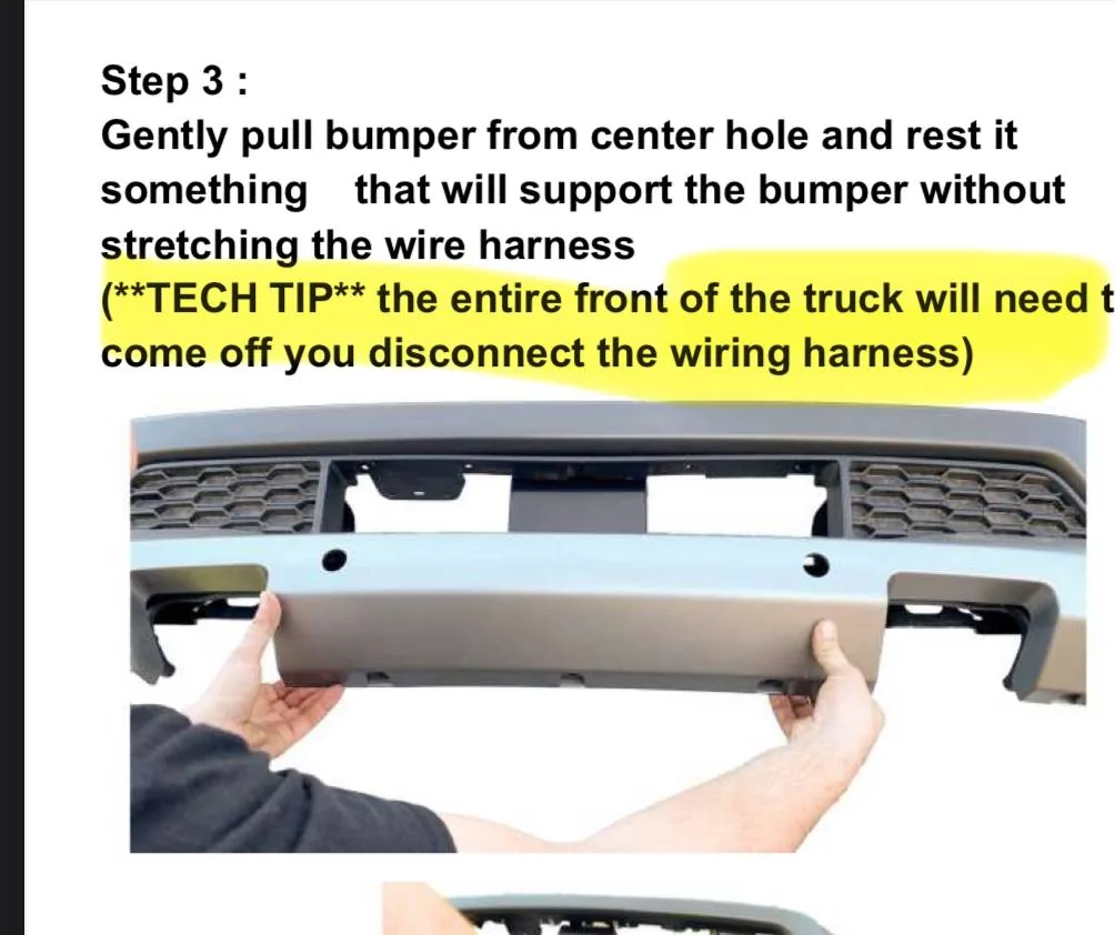

Can you clarify this please? Are you saying the whole front end of the truck will have to be removed IF the wire is unplugged? Or, does the wire NEED to be unplugged? The instructions toward the end say to plug the wiring harness back in. Thanks!
its just not worded well. we will correct that.
what its trying to say is you cant fully connect the wire harness for the sensors etc without having to remove a bunch of other parts on the truck so best to have something you can put the bumper on in front of the truck while you work on it. some milk crates or something so you can keep it close enough to not stretch or pull the wires.
hope that helps. We will get the published instructions updated with a better explanation today.
