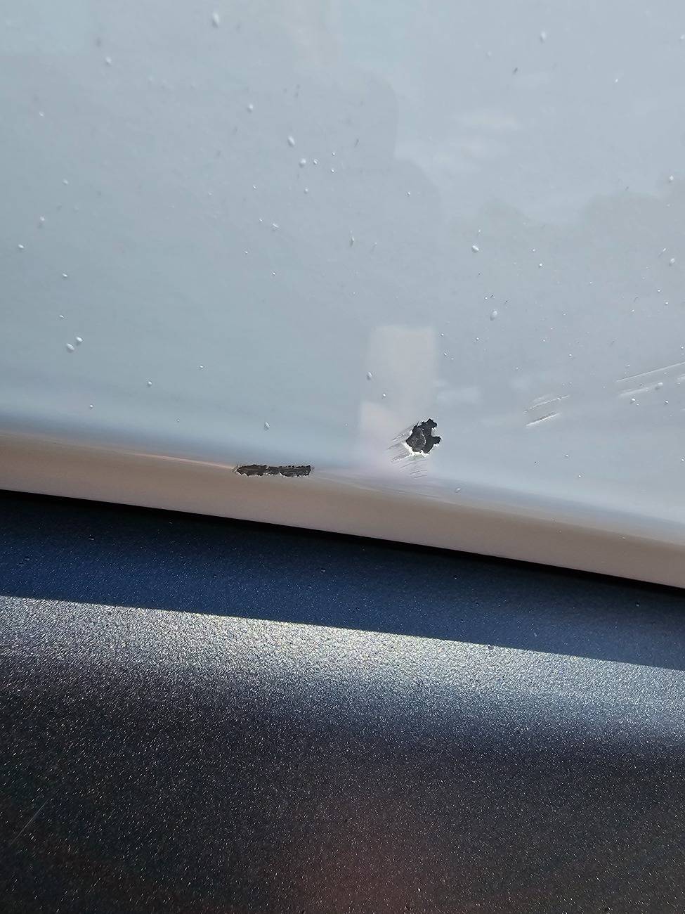

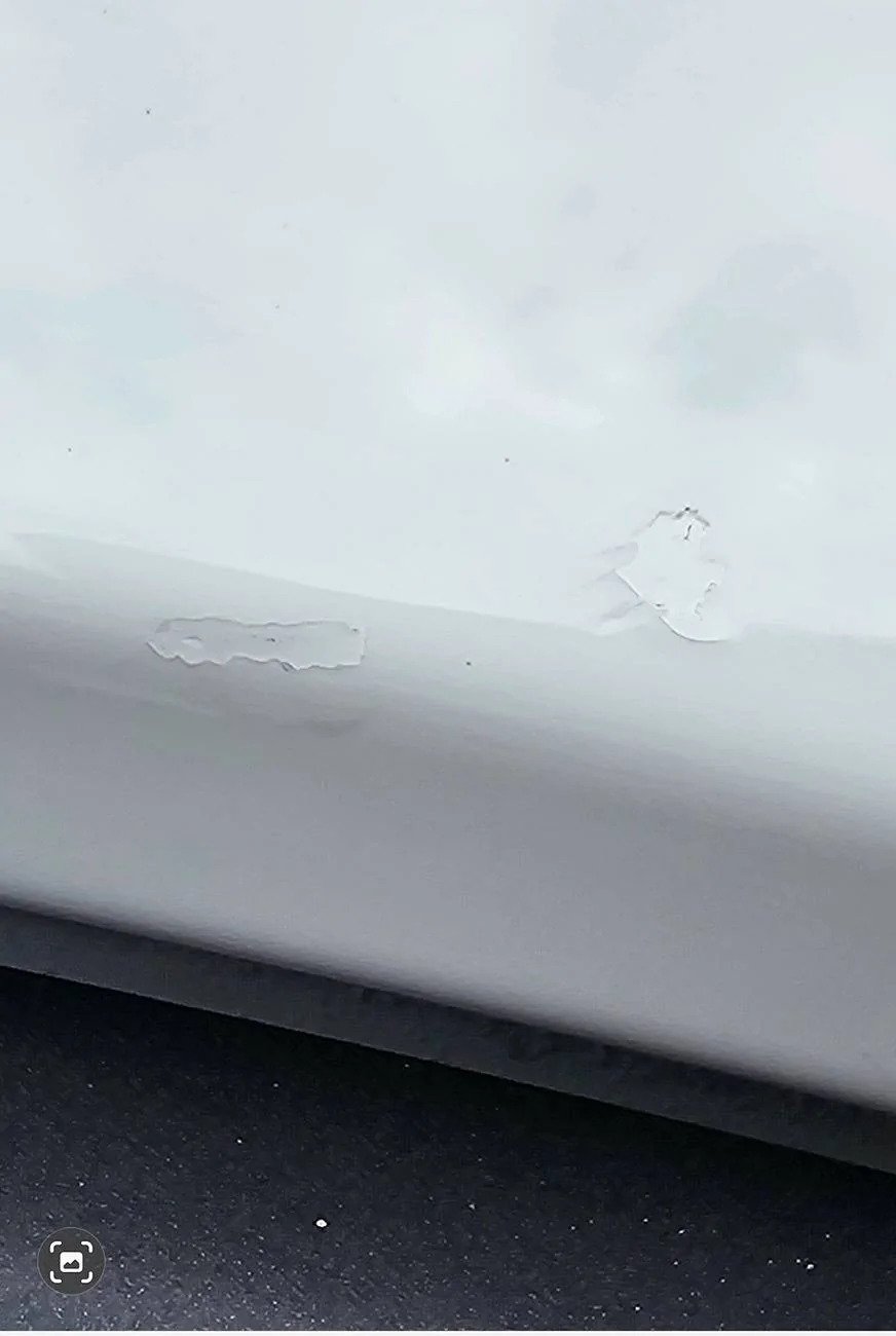

I hit my wife's ranger raptor fender with a car wash wand and put a chip/scratch in it. I Googled "professional paint chip repairers" and the first company that came up was a ceramic coating company that is going to put iconrocklear paint protection on both of our Ranger Raptors this spring, now.
The guy had this little insrument that resembled a small weed pipe with a small hole/spout at the bottom of the bowl part. After cleaning the crater super super good, he fills this thing up with my touch up paint tube that I bought from the dealer (the amount of paint that comes out of this thing, cannot be replicated with any small brush or anything for that matter), and he goes into the scratch and dabs tiny amounts of paint into the cavity/gouge, being careful to keep the fresh paint in a concave shape and let it dry. He did this in several coats, until he thought the next coat would make the fresh paint convex in relation to the factory paint. I think he said it took 3 coats of paint on mine. Then he uses the clearcot part of touchup paint tube to make the surface convex slightly above the surface of the factory paint/clearcoat. Then he sands with super fine grit sandpaper ever so slighty. Then hand polishes it.
You can see his work in the picture, but standing next to it, you can only see it if you know its there.
I pulled my wife's wipers up the other day to keep them from sticking to the window with the freezing sleet we had coming our way, and the edge of the wiper took some paint off the edge of her hood. Be careful if you do this with your ranger, I'm not anymore. Gotta go back and have that touched up as well. My guy said the edges are the hardest to do, but if it's not in a spot where you notice it, it doesn't really matter, to some people.
Anyways, I just thought I would share this in case there's anybody out there, that's anal about they're paint chip turning into rust eventually like me.

Just to let everyone know, the suface is perfectly smooth. You just can't tell because it's clear coat.
