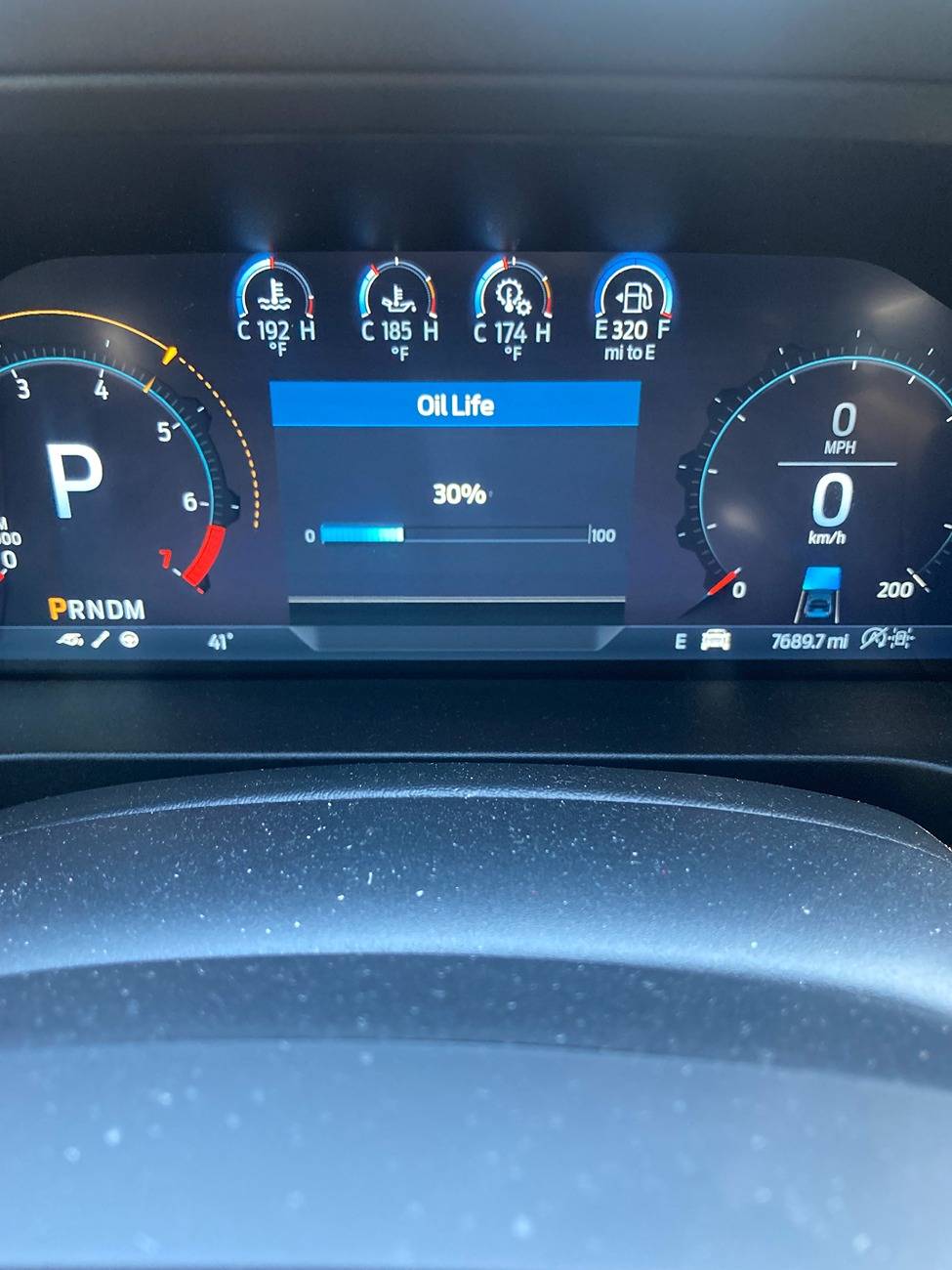

I am having issues resetting the oil life indicator from the Vehicle Maintenance -> Oil Life menu. All of the instructions I could find say that I should have an "OK" button there to reset similar to what you see on the trip odometer or resetting the mpg which both work fine. I am not seeing that button and can't for the life of me figure out how to reset it. Am I missing something that should be obvious?
I have tried with the truck running, with the truck in accessory mode, holding down the brake, nothing seems to work. Any help would be appreciated.

You're awesome, I never would have found that.
Many months ago I changed the Oil Minder Menu from Disabled to Enabled and it must have removed the reset option. This was my first oil change since then so I didn't make the connection to the IPC module that I changed.
Much appreciated for the help.
