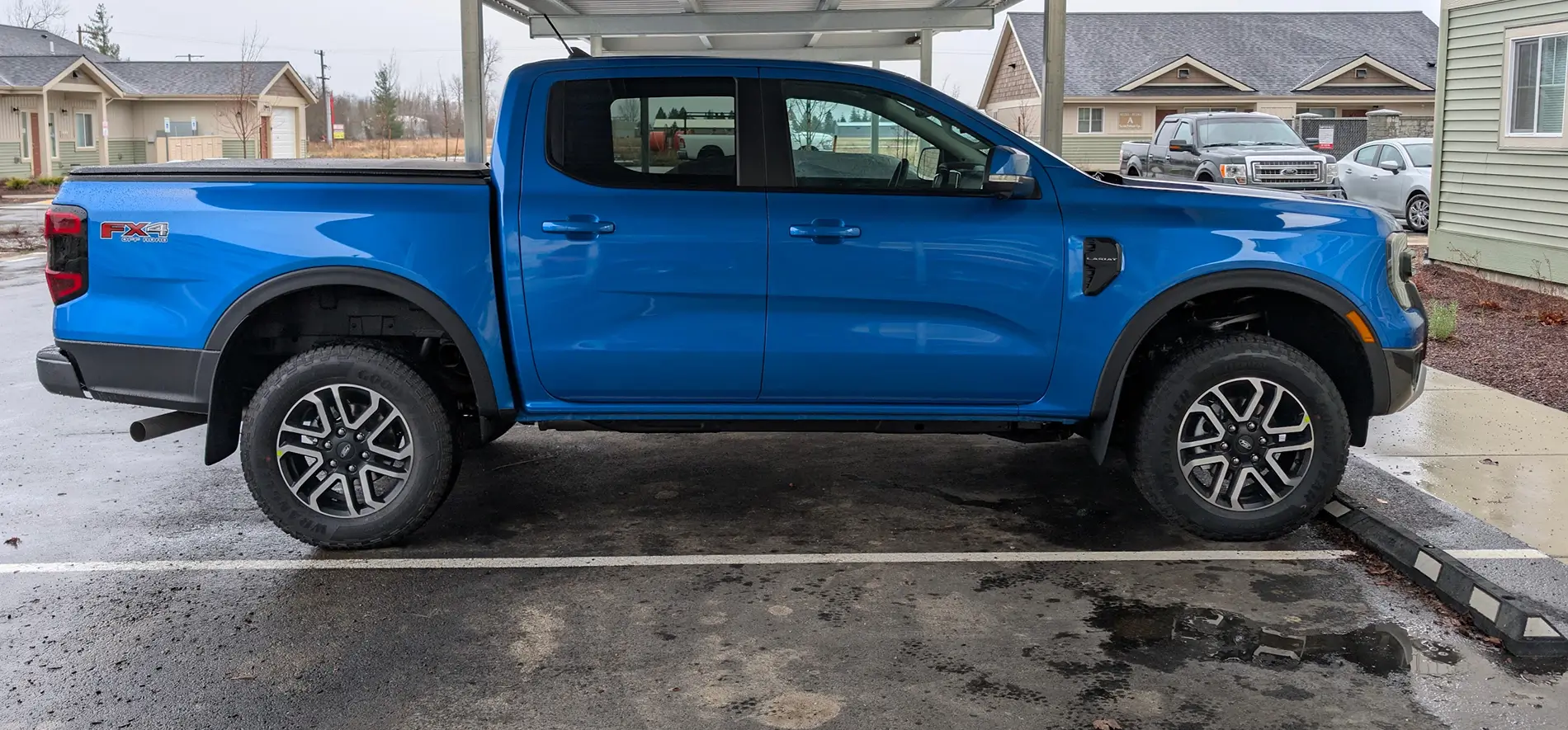

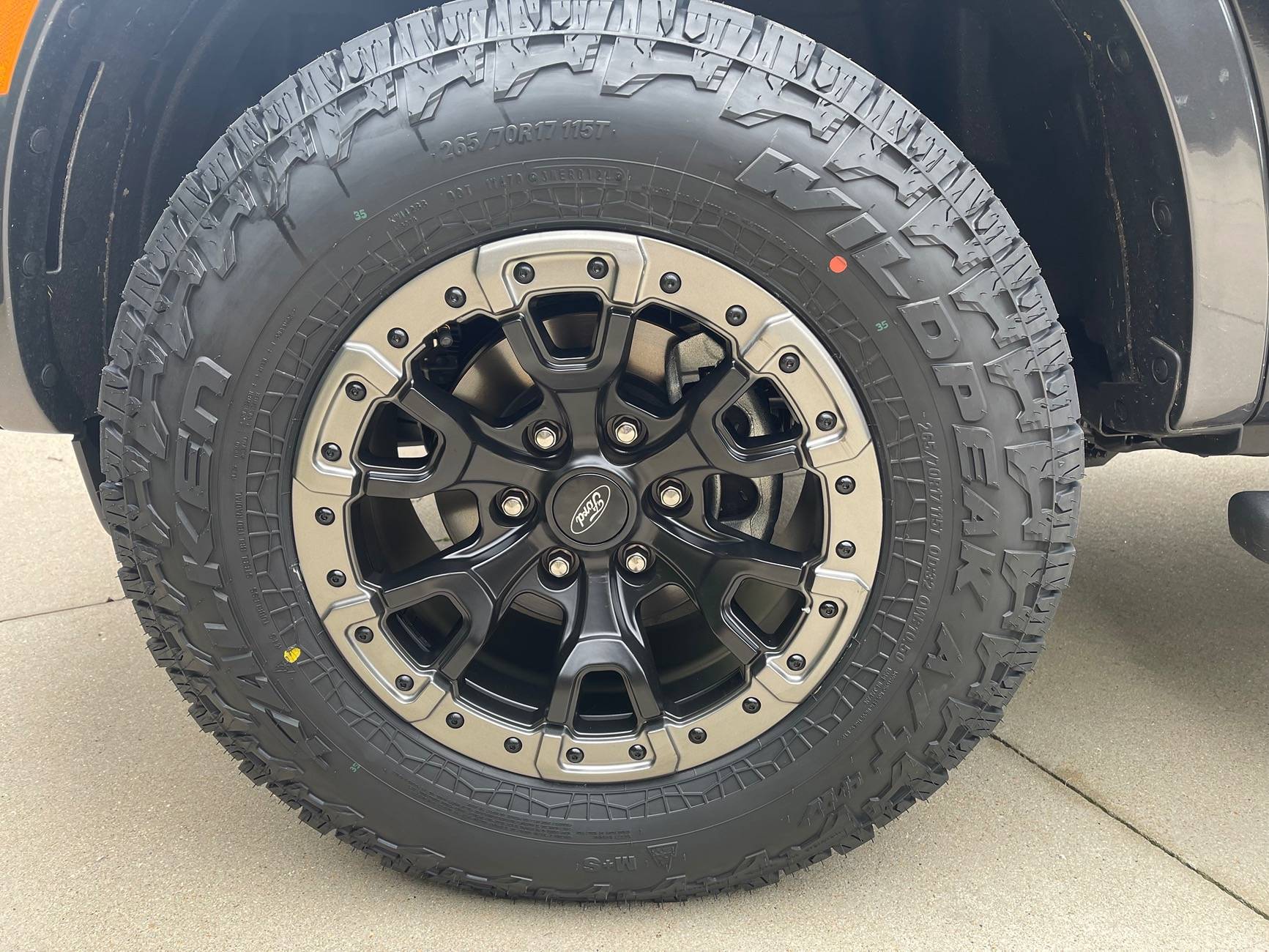

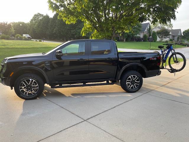

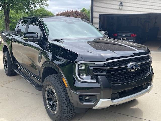

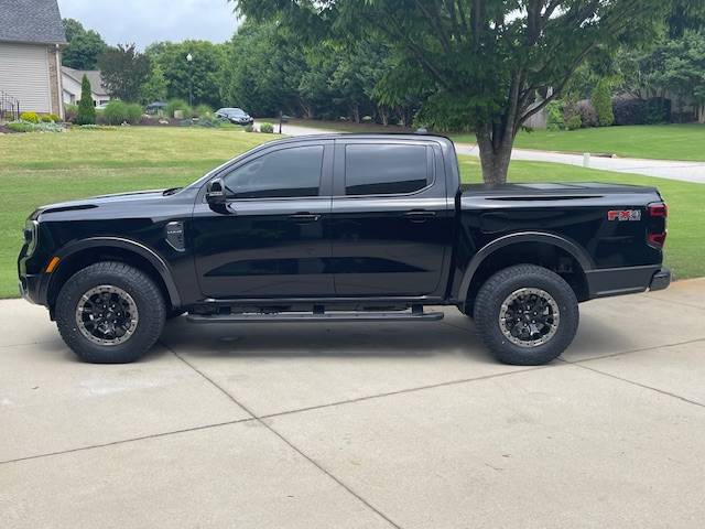

Finally….took delivery of my 24 Ranger last week. Ordered in June last year! I can’t believe it took Ford this long to build and ship, but that’s another topic. So, I wasted no time and upgraded my OEM wheels and tires, see below before and after pics. I wanted a bigger more aggressive tire and wheel while keeping the suspension stock. Also, we were able to use the existing Ford center caps, TPS sensors, and lugs with these aftermarket wheels.
Wheels-
Factory Reproductions FR99 17 x 9. Lug pattern 6 x 5.5 with a 18+ offset
Tires-
Falken Wildpeak A/T-4 265/70/R17
Wheels-
Tires-

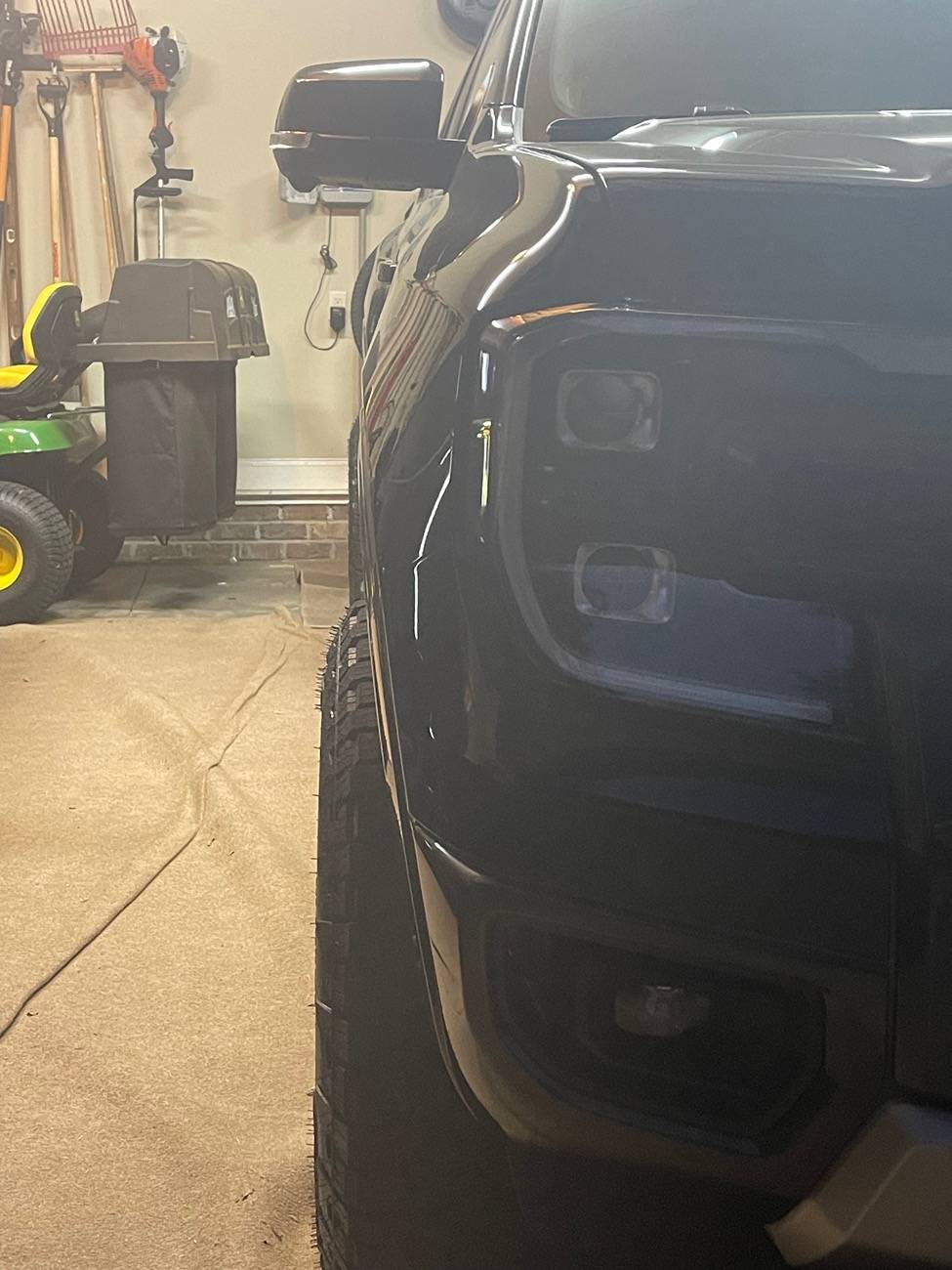

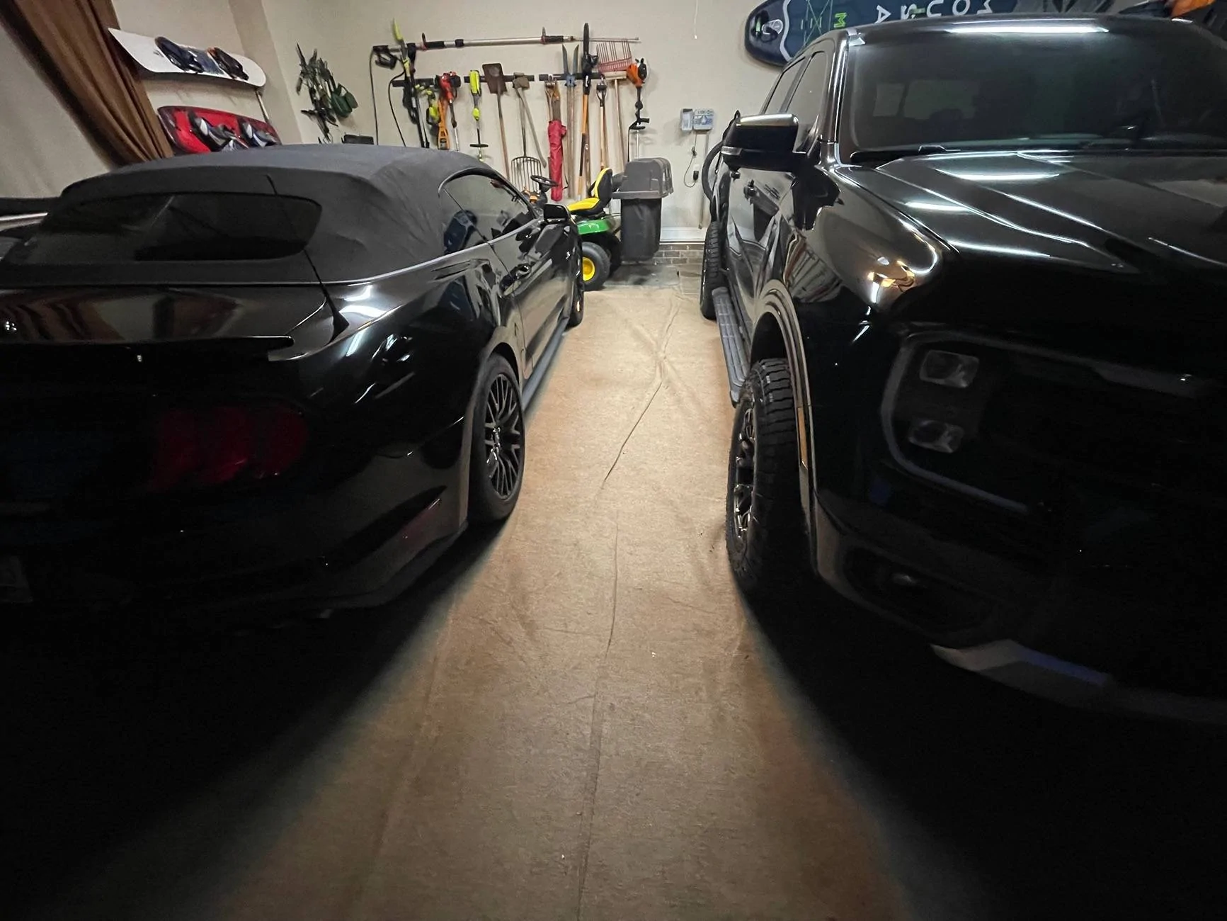

How close are you to rubbing when you turn in front and rear? Would you mind taking some pictures when the tire is the closest in front and rear of tire?

Yes, definitely has some poke

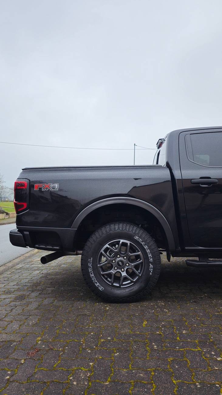

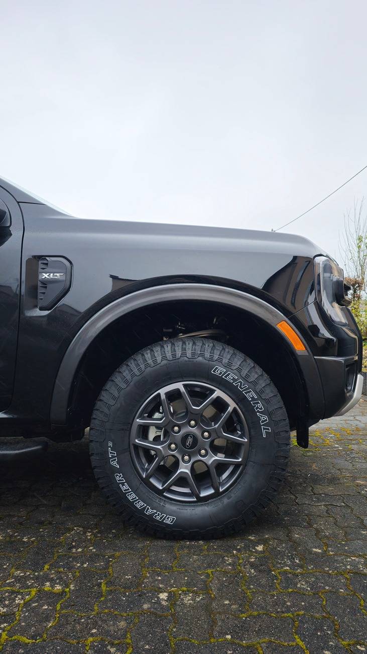

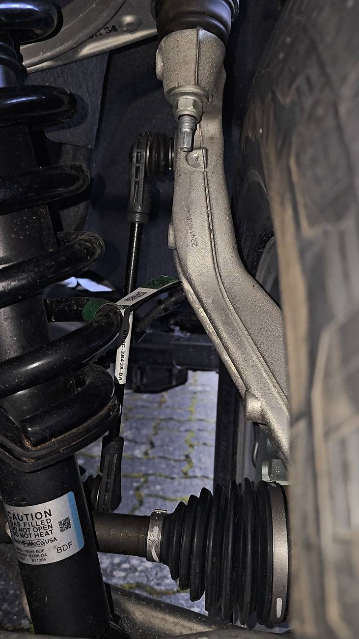

Since nobody confirmed then here it is. Stock everything, 265 70r 17 fits with no rubbing or clearance issues. Gap between the control arm is barely enough to fit a finger but everything clears even at full lock. I wouldn't go thicker unless you push the wheel out with spacers or with negative offset wheels.
