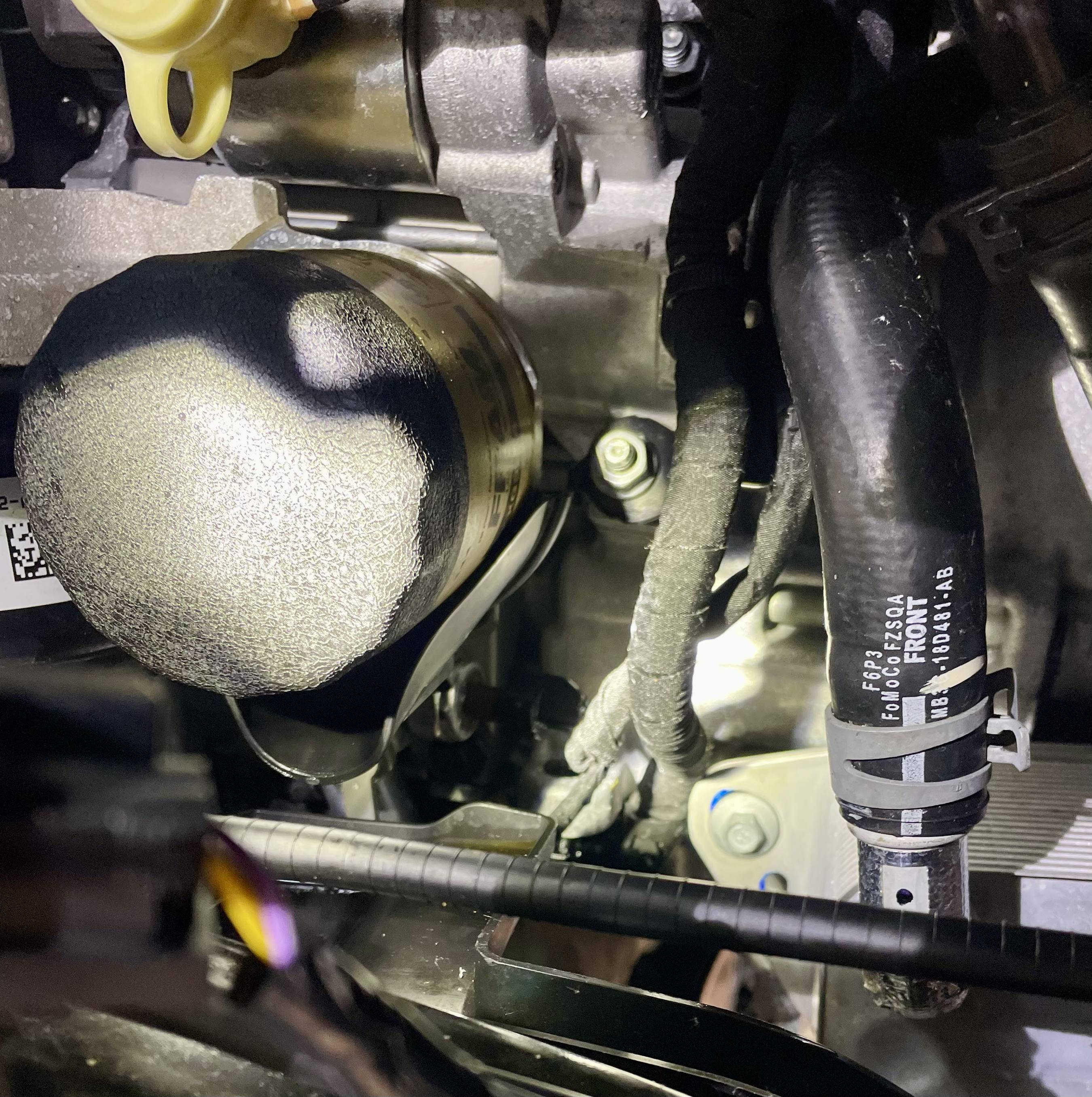

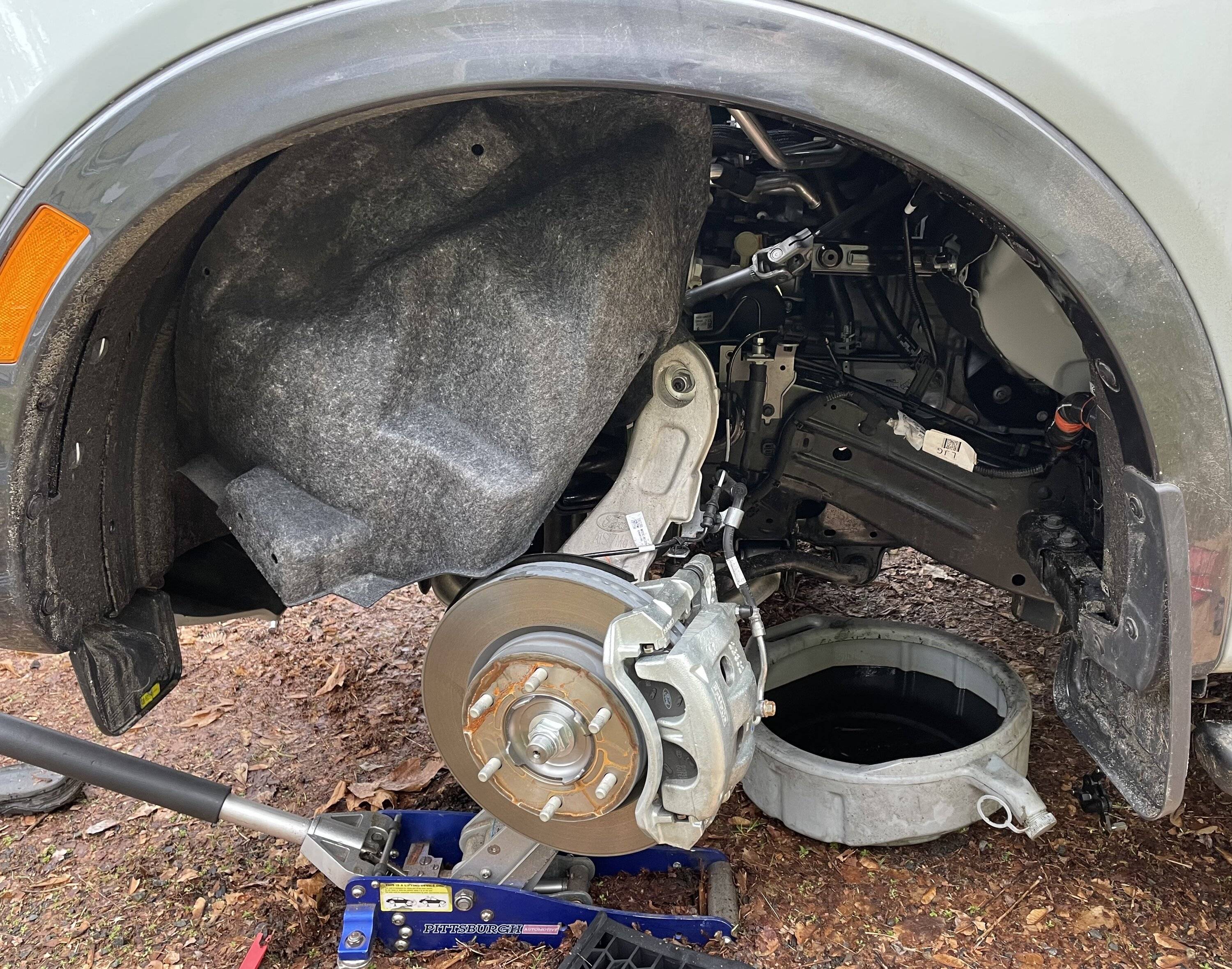

Did my break in oil change yesterday at 966 miles. Went with Mobil 1 5w-30 full synthetic and a Fram Ultra Guard.
The skid plate for the FX4 has 4 bolts. All 15mm. The front of the plate is slotted, so you only need to remove the rear two mounting bolts. Drain plug is also 15mm and the pan is aluminum.
Access to the filter was a pain. Tried to remove the one pin and lift up method but decided against it. Removed the rear liner pins, and 7mm screws and folded the liner forward for access. My problem was that the factory oil filter was on extremely tight. Eventually removed the wheel so I could get two hands on it. Not kidding when I say the filter was on tight.
Backed the filter off halfway and let it drain. With everything moved out of the way, filter access was fairly decent. The drain chute for the filter worked well and when I fully removed the filter, didn’t spill a drop.
Cleaned up the chute drainage system with brake cleaner spray after the new filter was installed.
Overall it was a learning experience and took much longer than I had planned

Where is the filter in your first pic? Thanks. I am thinking pull the wheel also for easier access. It takes 1 minute with a cordless impact.
If you think of that center bolt on the aluminum arm as the center up a clock, follow it up on the 1 o’clock axis and you’ll see it. And right beneath the steering knuckle The Fram has the black coating for gripping, makes it harder to see.
Ok yes I see it. It looks like that brake line is right in font of it?
