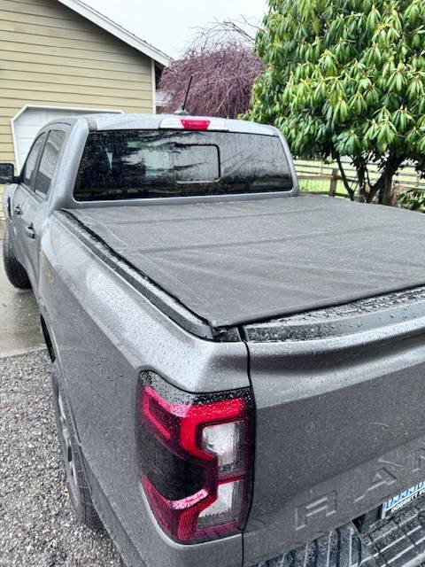

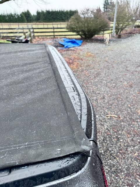

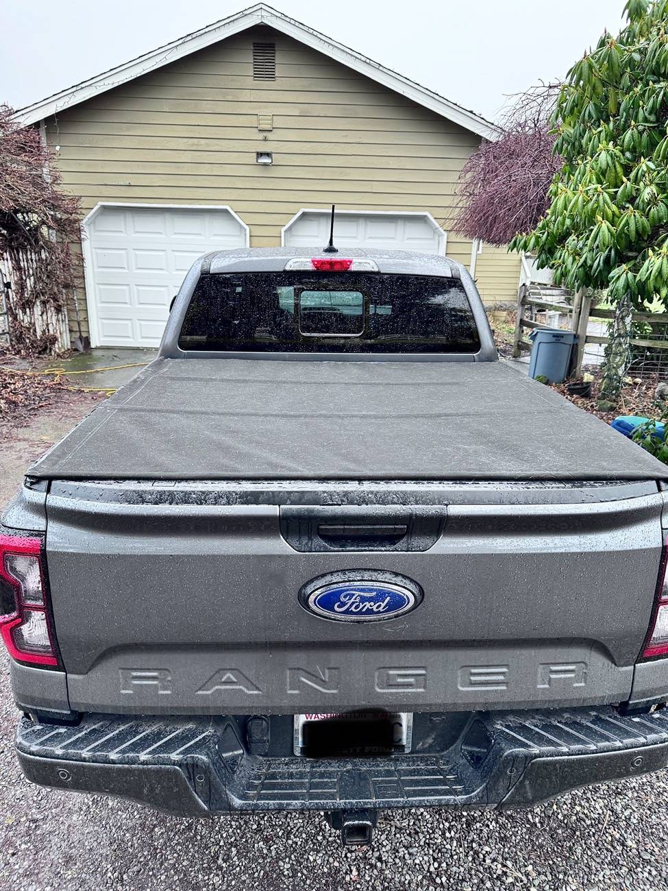

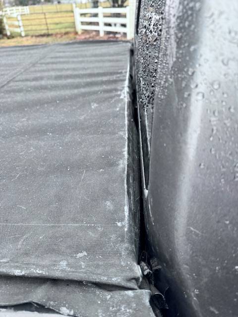

Still finishing but turned out alright for a first project like this.
Made out of awning fabric with 2" aluminum flat for support in the center.
2" velcro at cab end and snap buttons on tailgate and sides. If count what my time is worth plus $67 materials it would have been cheaper to buy one off Amazon... but there is no satisfaction in that.
