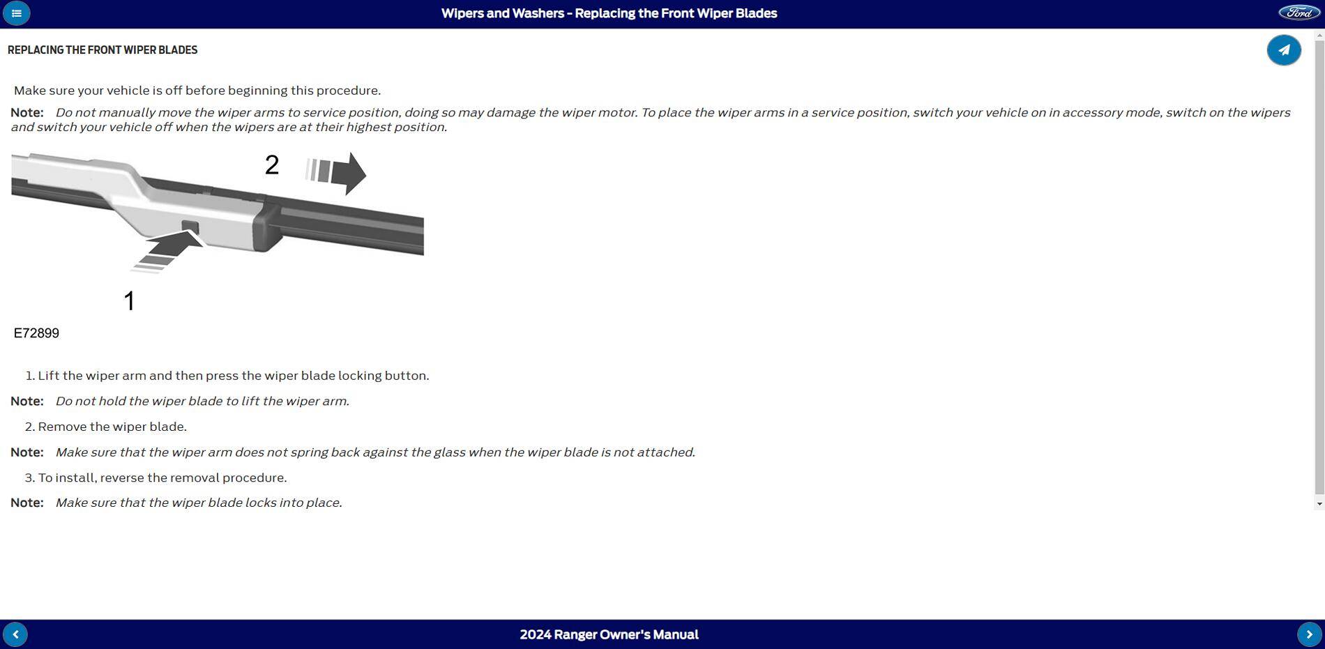

I'm not familiar with the wiper motor internals but it's usually not advisable to move by hand. Also note per the manual:
Ford Ranger Lifting windshield whipper's scraping paint off the hood Screenshot 2025-02-11 142952
These motors have a lot of torque but moving by hand at the end of the wiper arm, you have a lot of mechanical leverage that can strip gears, especially if they are plastic. Just fair warning!
