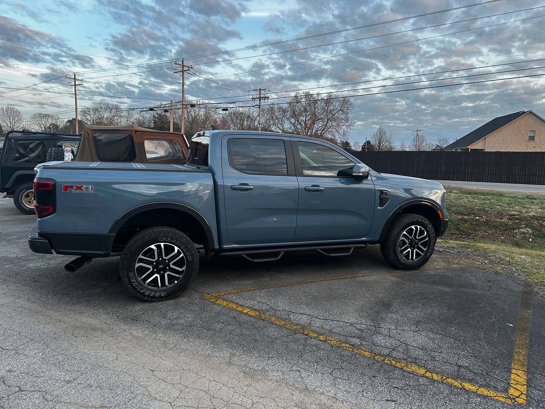

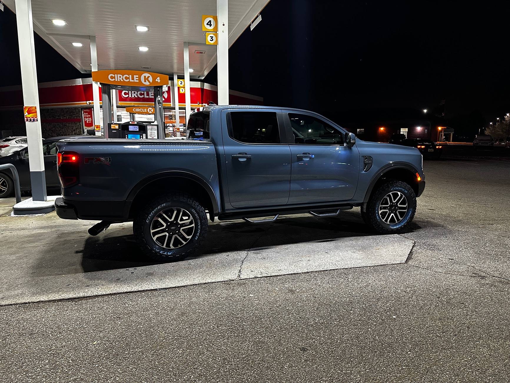

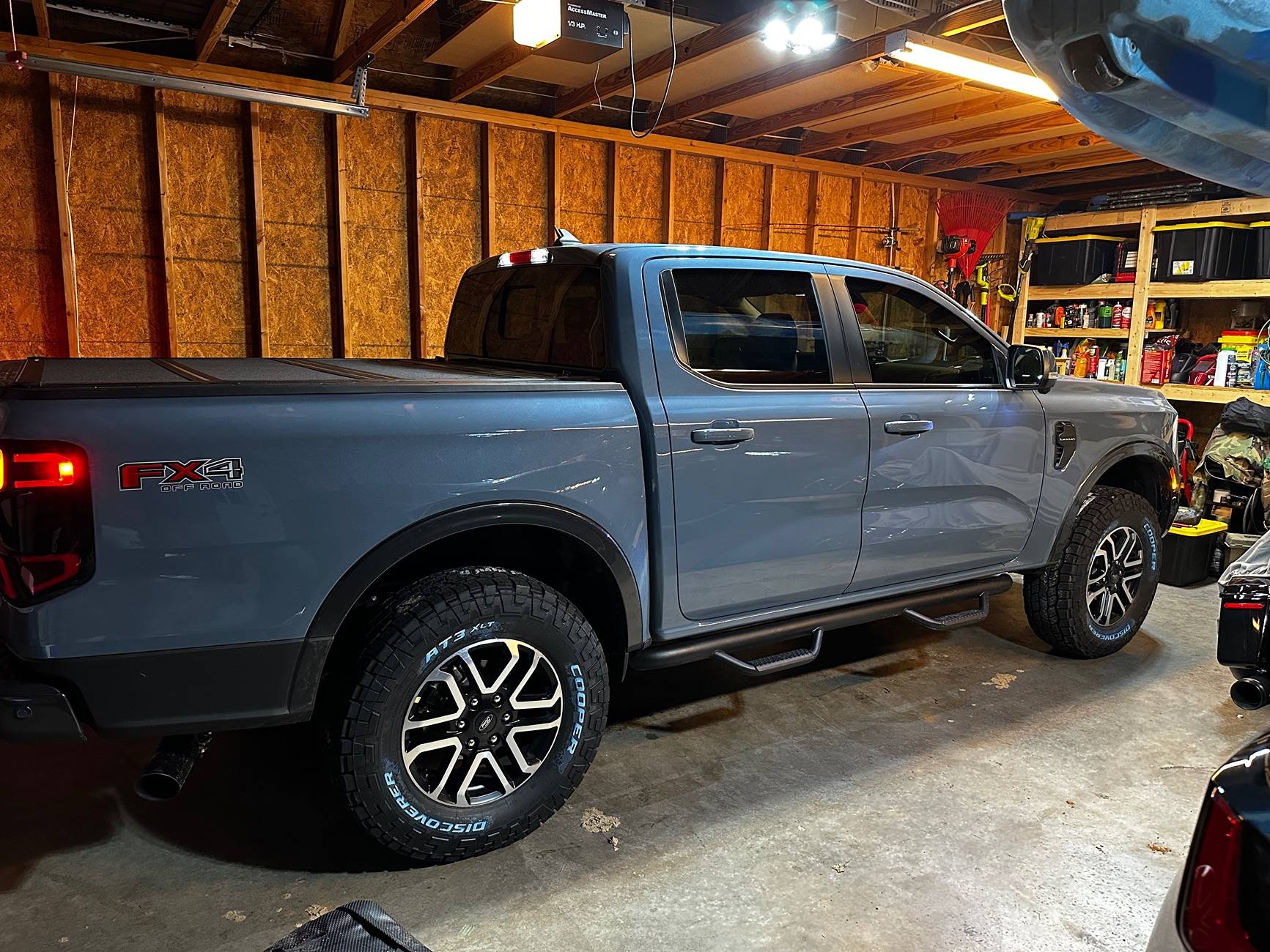

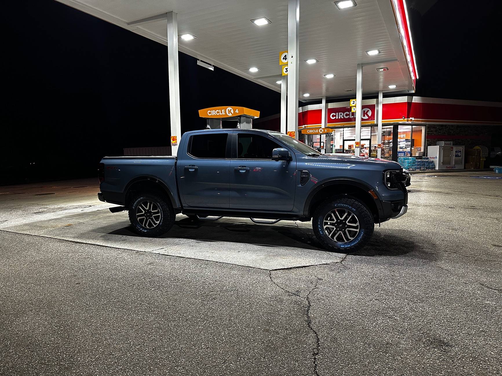

Before and after pics. Was dark when I picked her up so had to take em at the gas station and in the garage. Happy with it but am now thinking I want another inch in the rear. Measuring from the top center of the tire to the bottom center of the wheel well the front is about .25” higher.

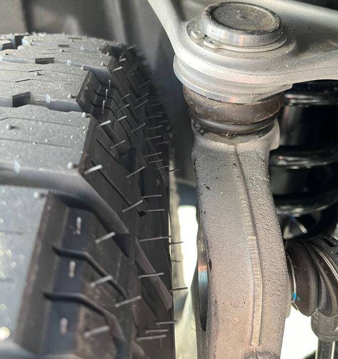

Any rubbing? How close is the inside of the front tire to the knuckle?

I'll try to get a good pic. It's close, but no rubbing.

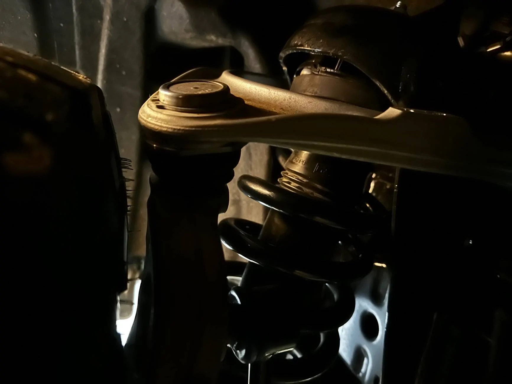

No idea what wheel offset is. No spacers. Best pic I could get.
Stock wheels on the Lariat are:
7.5Jx18 ET55 offset: 53 - 57 (55)
Bolt Pattern (PCD): 6x139.7 (6x5.5)
Thread Size: M12 x 1.5
