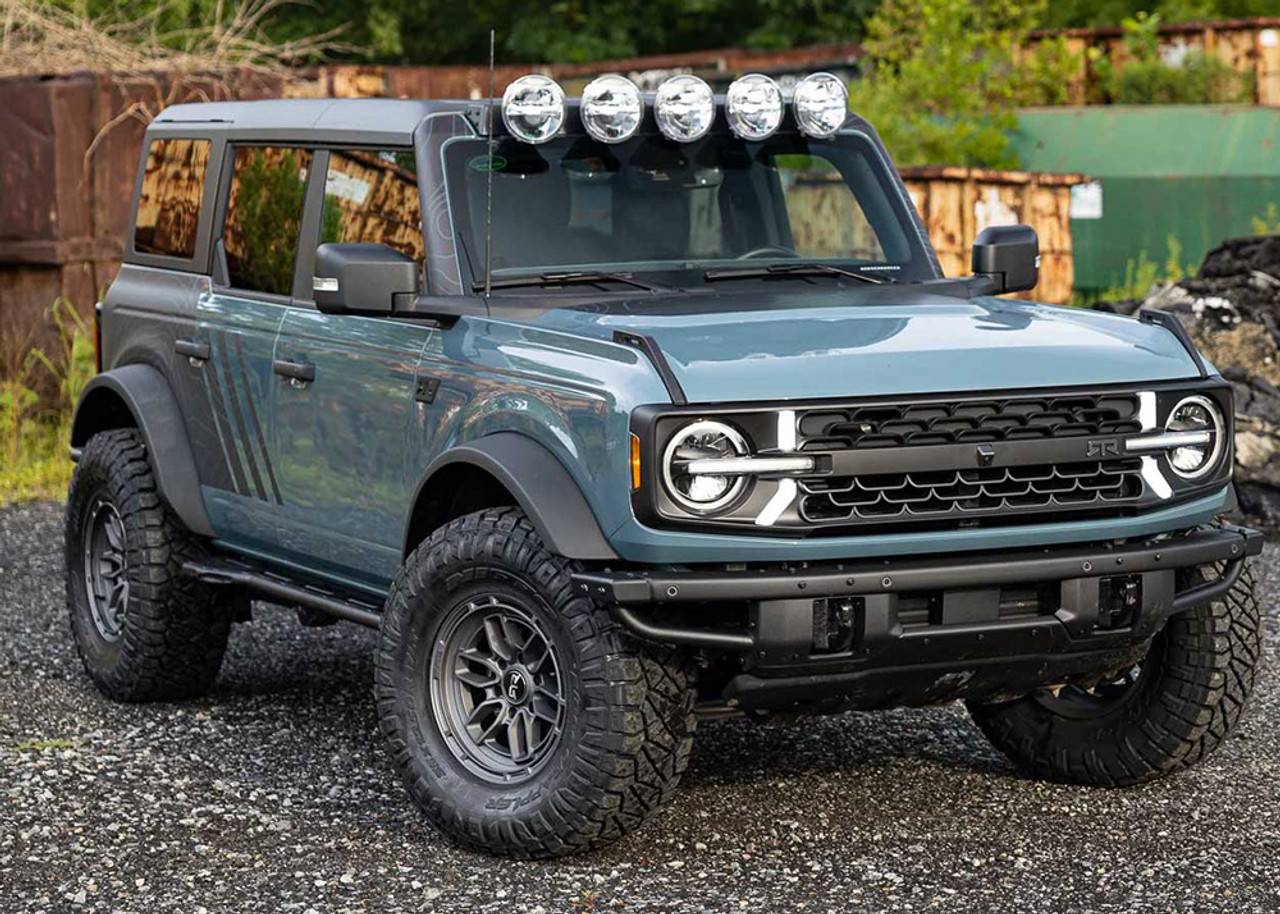

The 15% code is just WELCOME15.
The charcoal gray satin DOES NOT match the fenders so beware. They are much lighter and a primer looking color in person.
Thanks ... After some research on youtube that gray is too light of a color and definitely not Charcoal like the name. Weird they would call it that when it should be called as you stated "primer gray"

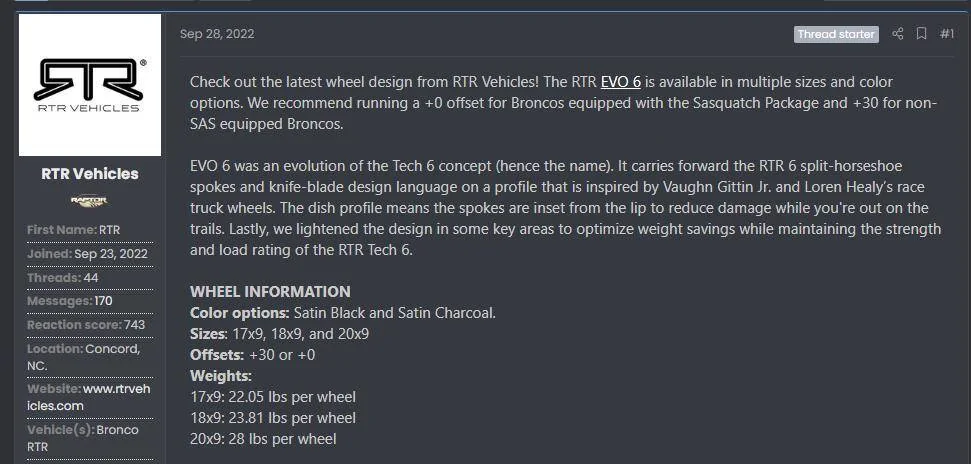

RTR did get back to me on the weights yesterday. I read on reviews that they were 21 lbs which would be a big selling point and ........ no. Still less the stock non beadlock wheels.
From RTR
Please see wheel weights below:
RTR Evo 6 Wheels in 17x9 are 24.5lbs. per wheel.
RTR Tech 6 Wheels in 17x9 are 27.5lbs. per wheel.

Another selling point of the RTR are the 9inch width which widens out the contact area of the tire tread a little. Not sure if it's enough to notice a difference but it is what it is. I've read everywhere the 17x9 RTR EVO 6 are 22lbs, even said by the RTR rep on the Bronco6G forums. Not sure why they told you 24.5 or if they changed recently. They might have given you the weight of the F150 Raptor / Bronco Raptor version of the wheel.
https://www.bronco6g.com/forum/threads/rtr-evo-6-wheels.55249/
