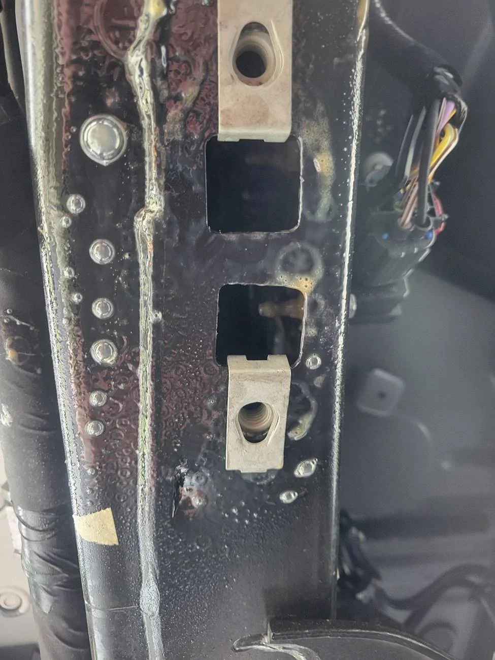

The the nuts are already part of the frame. You don't need to provide them. The bolts go up to the already existing welded in nuts in the frame.

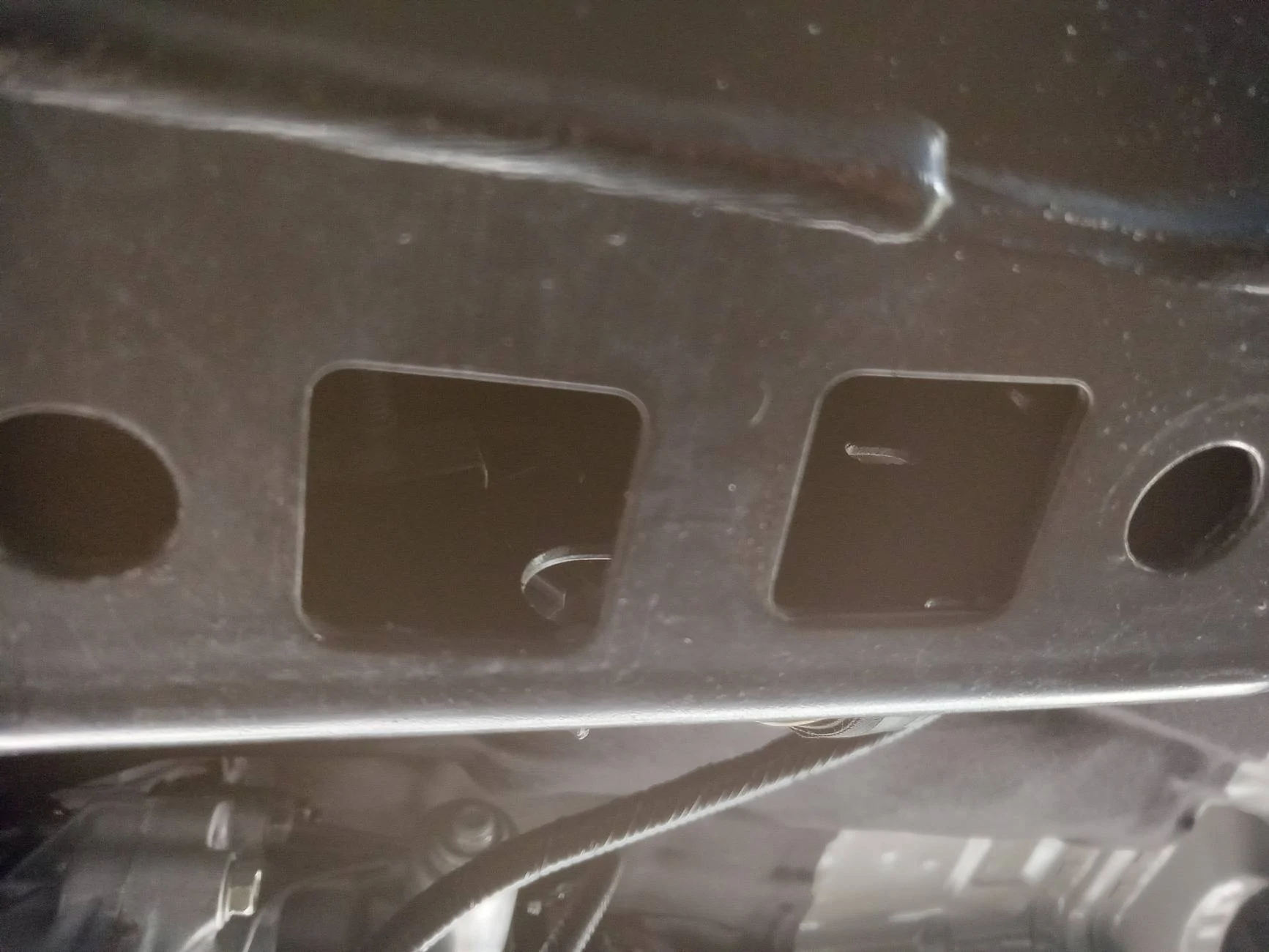

Hey RangerDangerStranger, with the transfer case skid that's only on the cross member in the middle, but where it bolts on the main frame there's 2 holes for the bolt and in the middle of the holes for the bolts there's 2 small squares holes I can't hold the nut to tighten, the plate covers the squares, I'm thinking I need clip nuts that slide in the squares holes pushed to the bolt holes ,but don't know what bolts and clip nuts I need !!

I'm going back outside and look again at the frame

RangerDangerStranger I don't know how to send photos of my pickup ,I'm new at this

all the plates bolts are the same thread. think there may be some variation in the head type between the front plate and the rear ones, but, honestly, I don't think it'll matter in a real world application. Threads are the same.

You should have the Skid plate brackets, being it's a 4x4. there are some bolts already installed holding the plastic pieces on that can be used to install the steel plates. Get a few extra though, i think i was short 2. same blots hold the transfer case on, 2 bolts.
