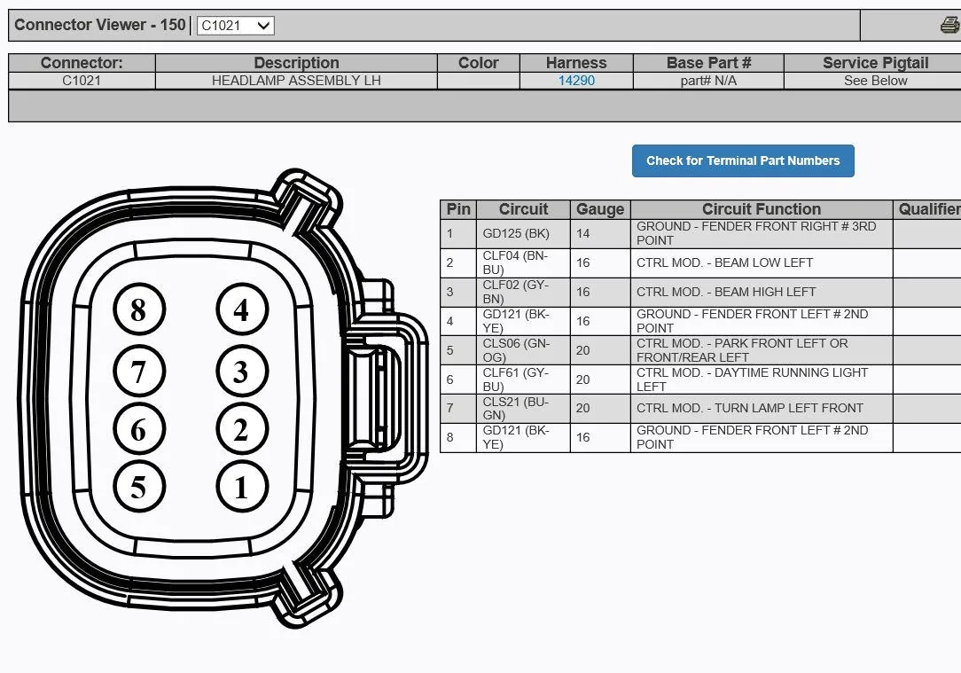

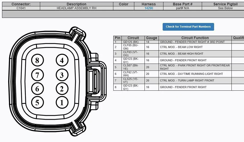

I'm trying to find out which wire in the headlight harness plug is the one for drl. I have an LED grille I want to hook up to the harness and solder to but I don't know which one it is. Would it be the same as the Australian and British rangers?

Did you ever get the info your looking for? I'm in the same boat, I got some grill lights from ebay and trying to figure out which wires to tap into.

I basically prayed and hoped for the best that the wires were the same as the international ranger. Turns out it was. If you look up on YouTube ford ranger nighthawk grill installation, the video will tell you which ones to tap into for the DRLs. I did the process exactly how it says and it worked perfectly.
