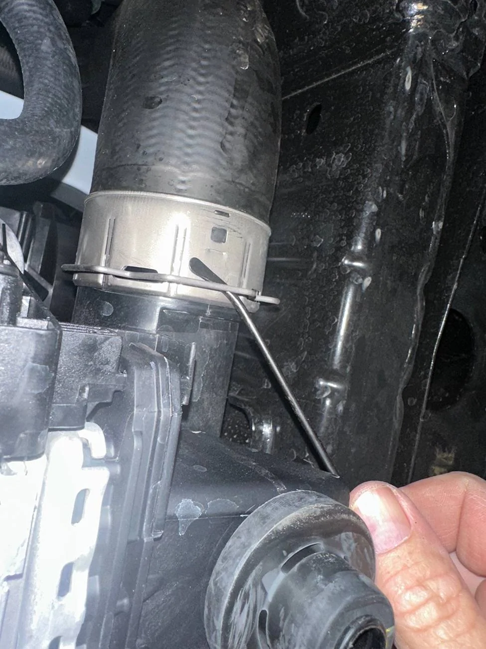

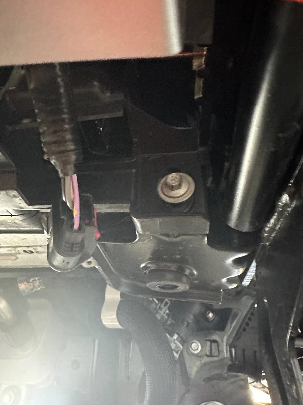

Ok, finally had the time to attempt this again. Found the two screws that were holding me up the first time (see picture). Literally got it done in a half hour. I did not install the louvers or the top brackets. No lights on the dash after startup.
See easy peezy

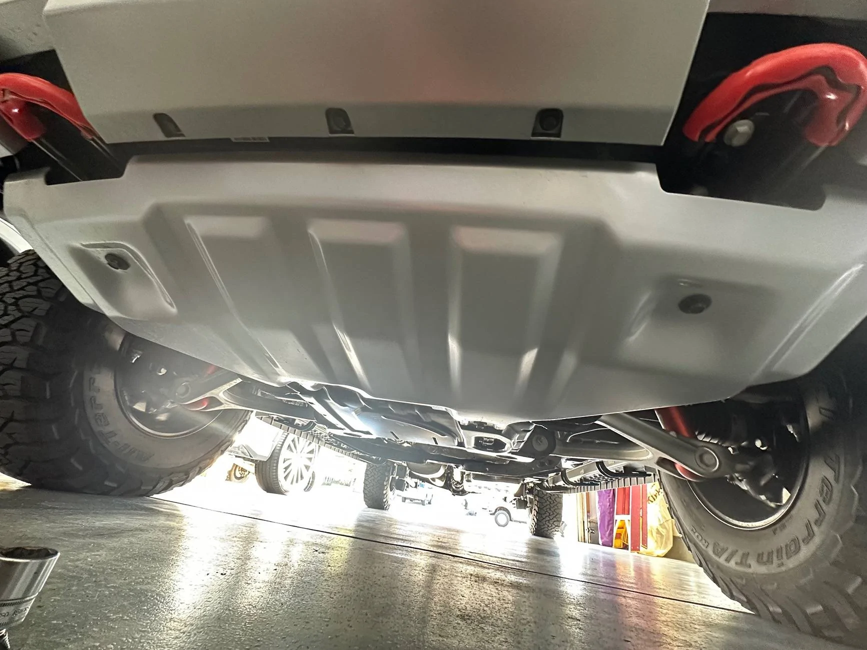

Ok just finished my Wagner intercooler, the directions are garabge. Doing this from memory so bear with me.
Remove skid plate, 2bolts in the front, 2 rear, these can be taken loose and the skid plate has a slotted hole.

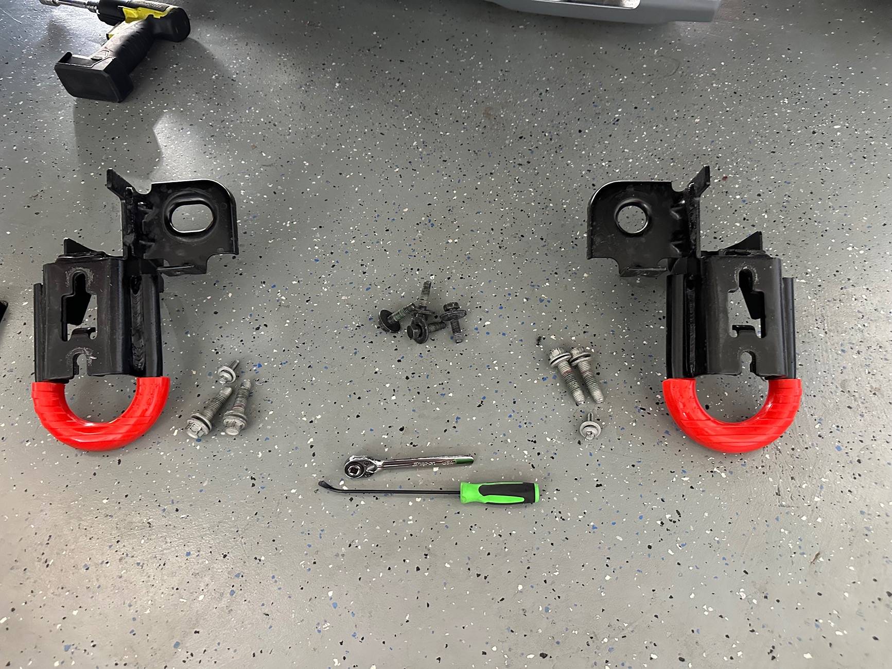

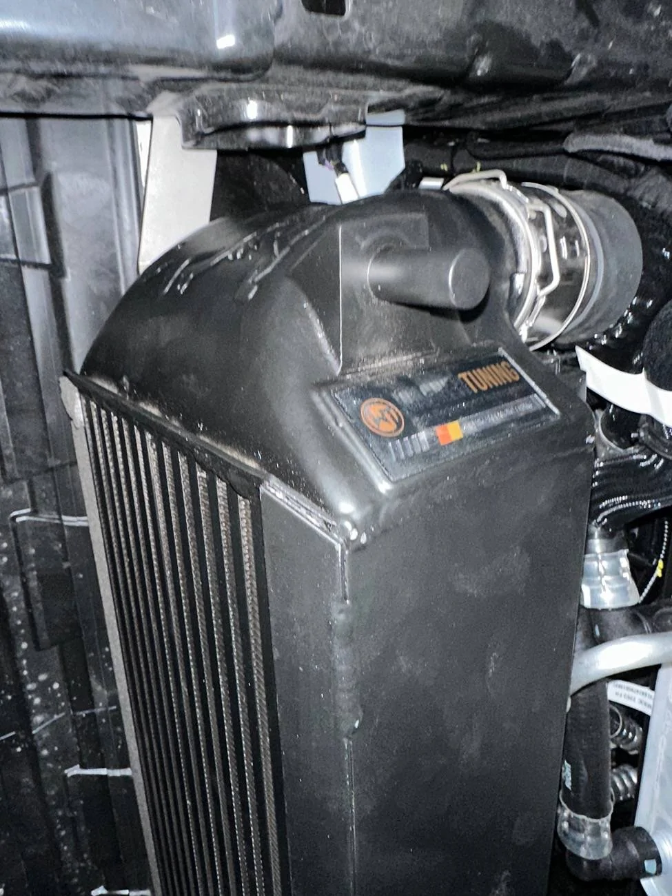

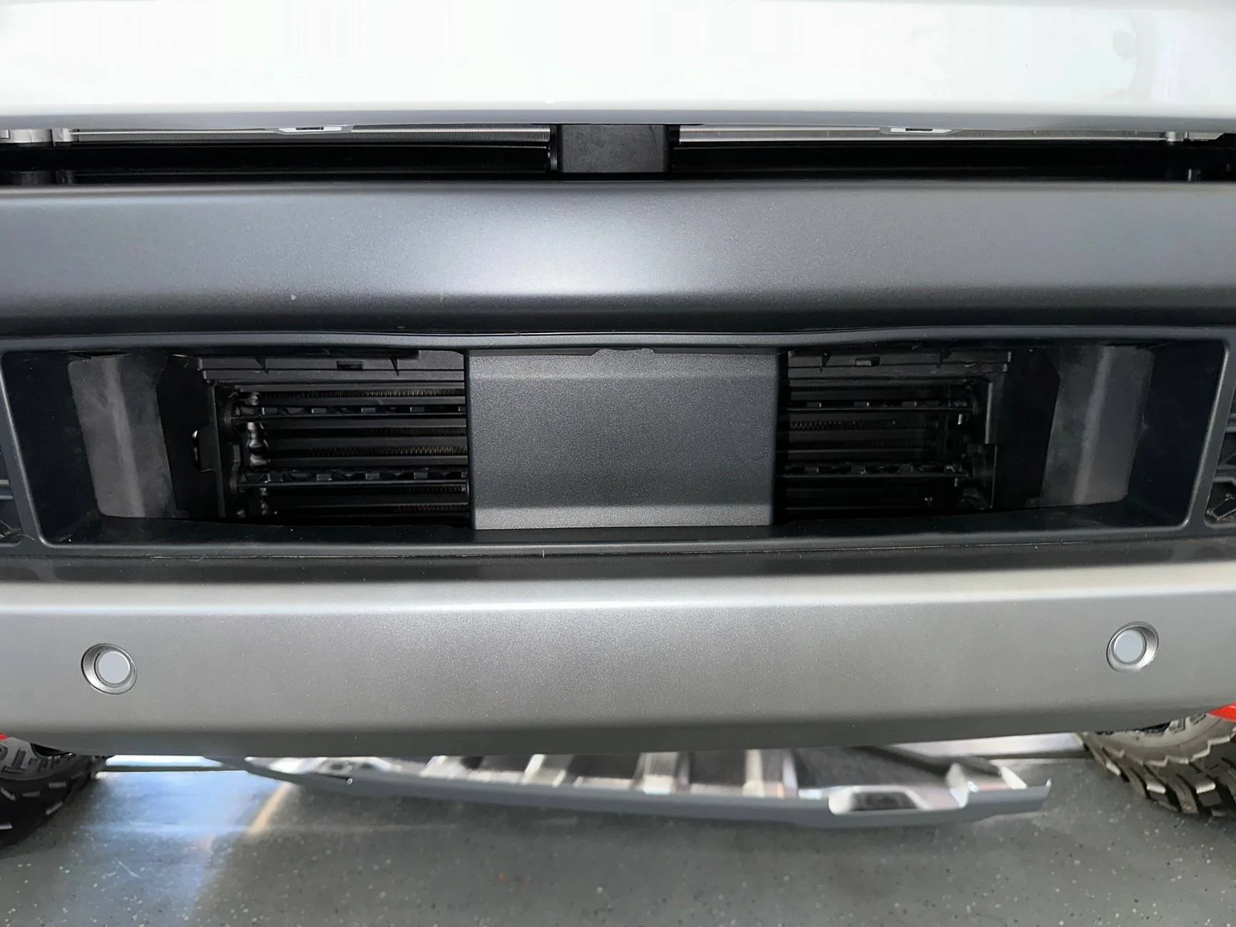

Installed my Wagner today was one of the easiest intercoolers I have ever installed I install the rear flaps and removed the front ones as the instructions said but you could leave the front flaps on if you wanted they clear I just think more air all the time would be better I’m Sure Wagner agrees.
I installed the Pro Tune today too that was quick and EZ too
Ford Ranger Has anyone installed a new intercooler on their own yet? IMG_7526
Ford Ranger Has anyone installed a new intercooler on their own yet? IMG_7531
Ford Ranger Has anyone installed a new intercooler on their own yet? IMG_7544

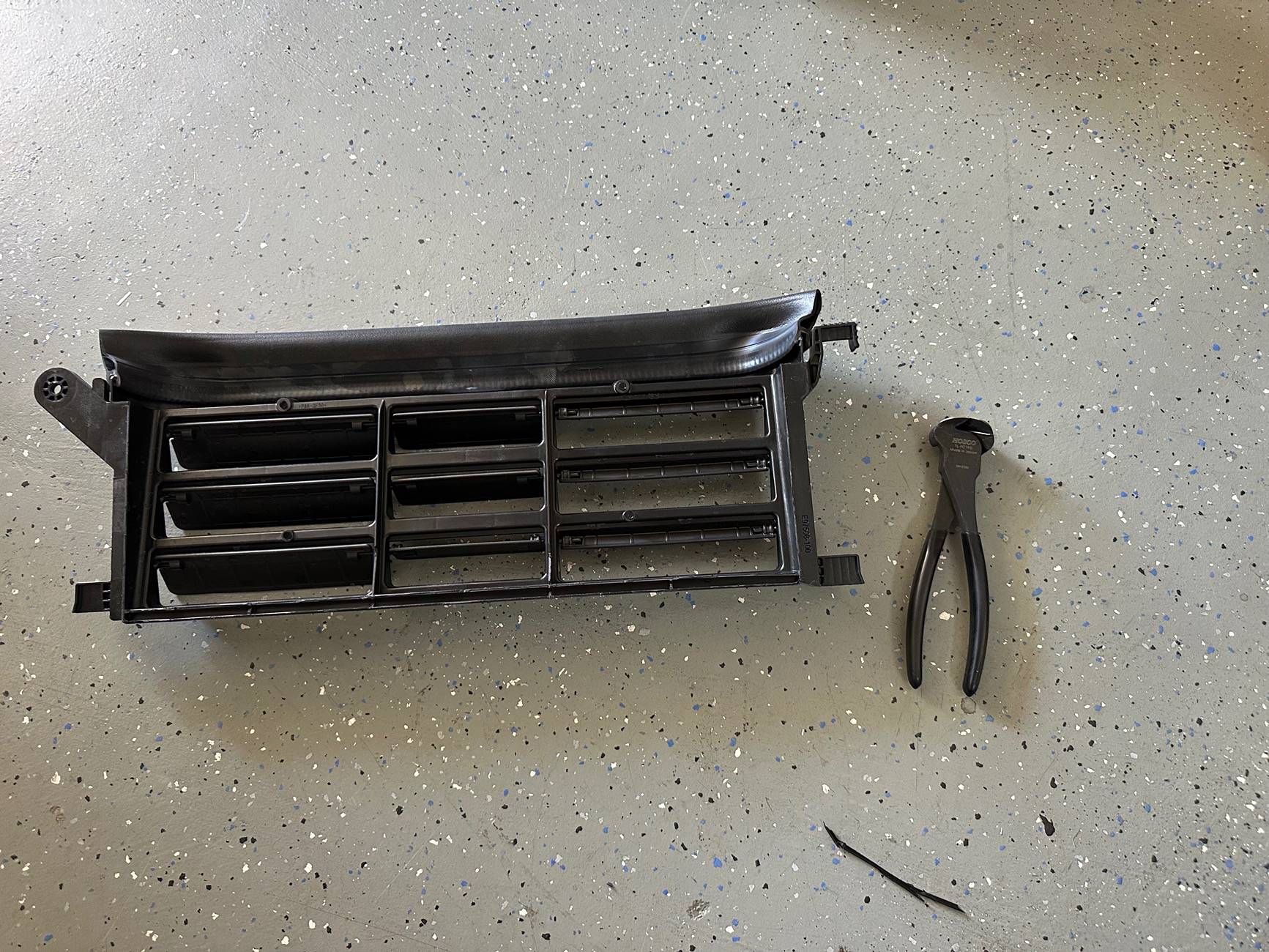

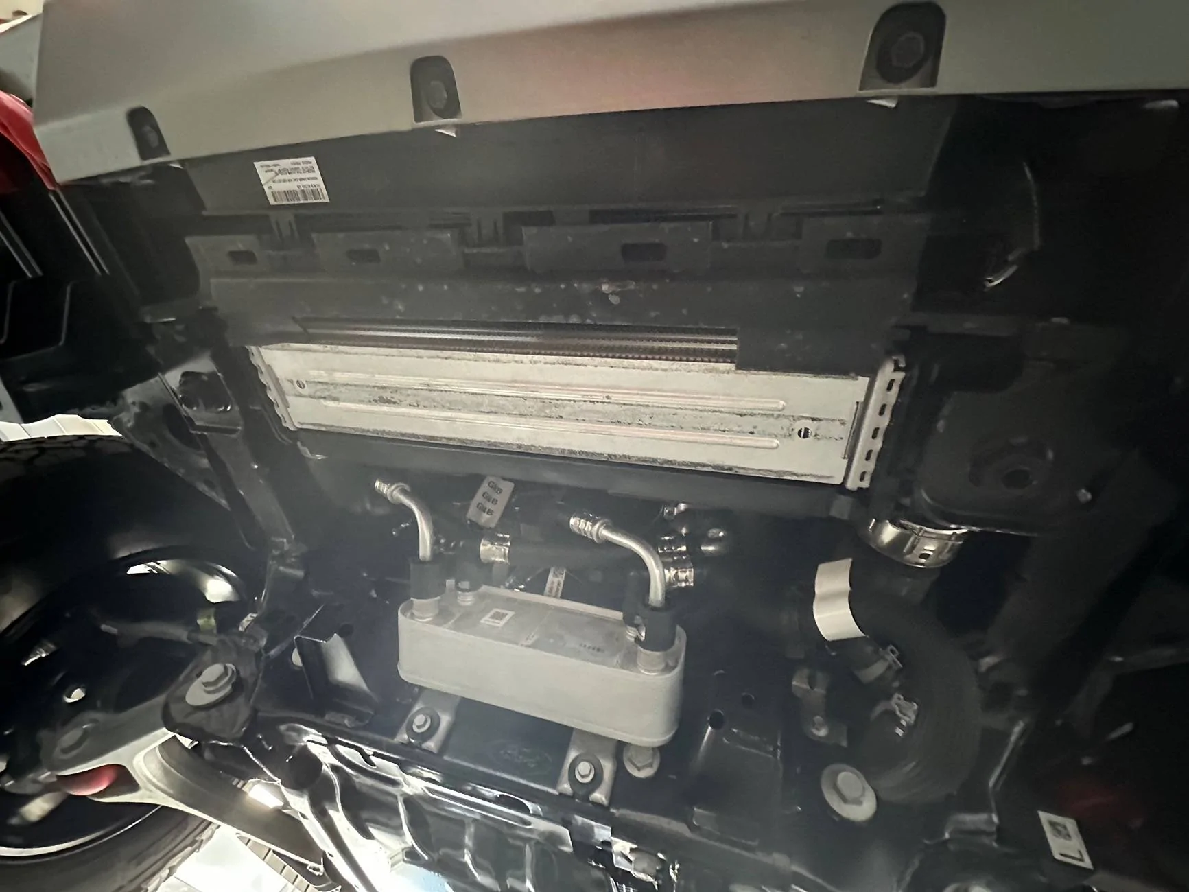

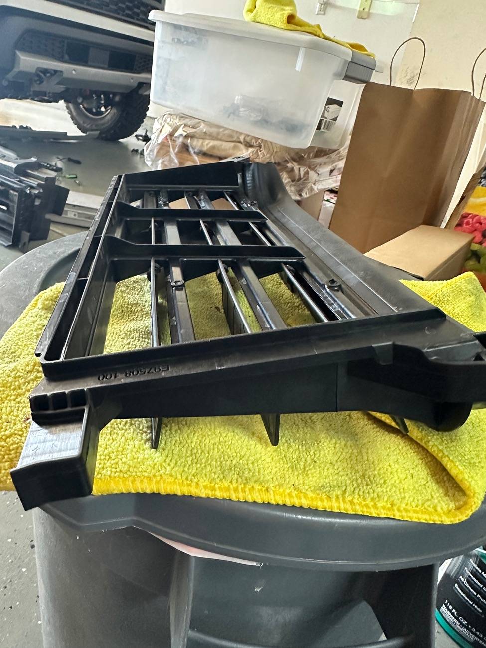

What did you use to trim the plastic off of the louvers on the back so it would fit on the Wagner?
What was needed to be removed in order to get the front louvers out?

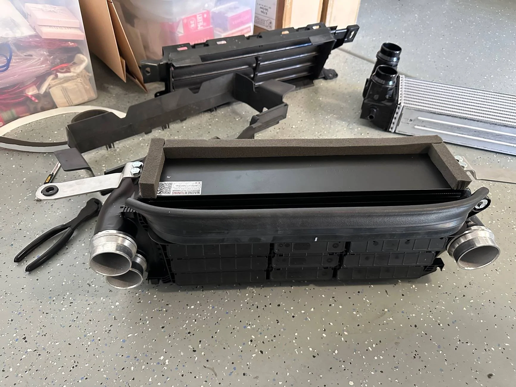

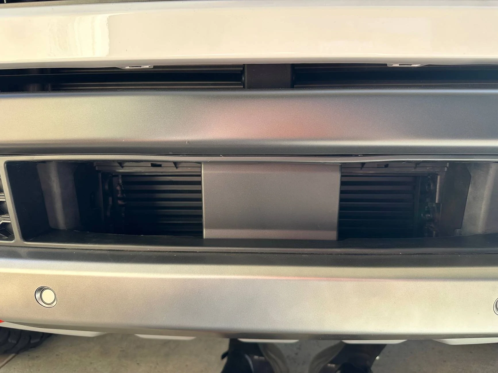

I Used Hosco Fret cutters they are sharp and cut flush easier than grinding
I left mine in to see if they worked with the Wagner and they did but seemed to be closed most of the time when I got out & looked at them so I removed them take the center clips that connected all the flaps then I just pushed in the middle to curve them and they will come out
Ford Ranger Has anyone installed a new intercooler on their own yet? IMG_7519
Ford Ranger Has anyone installed a new intercooler on their own yet? IMG_7534
Ford Ranger Has anyone installed a new intercooler on their own yet? IMG_7521

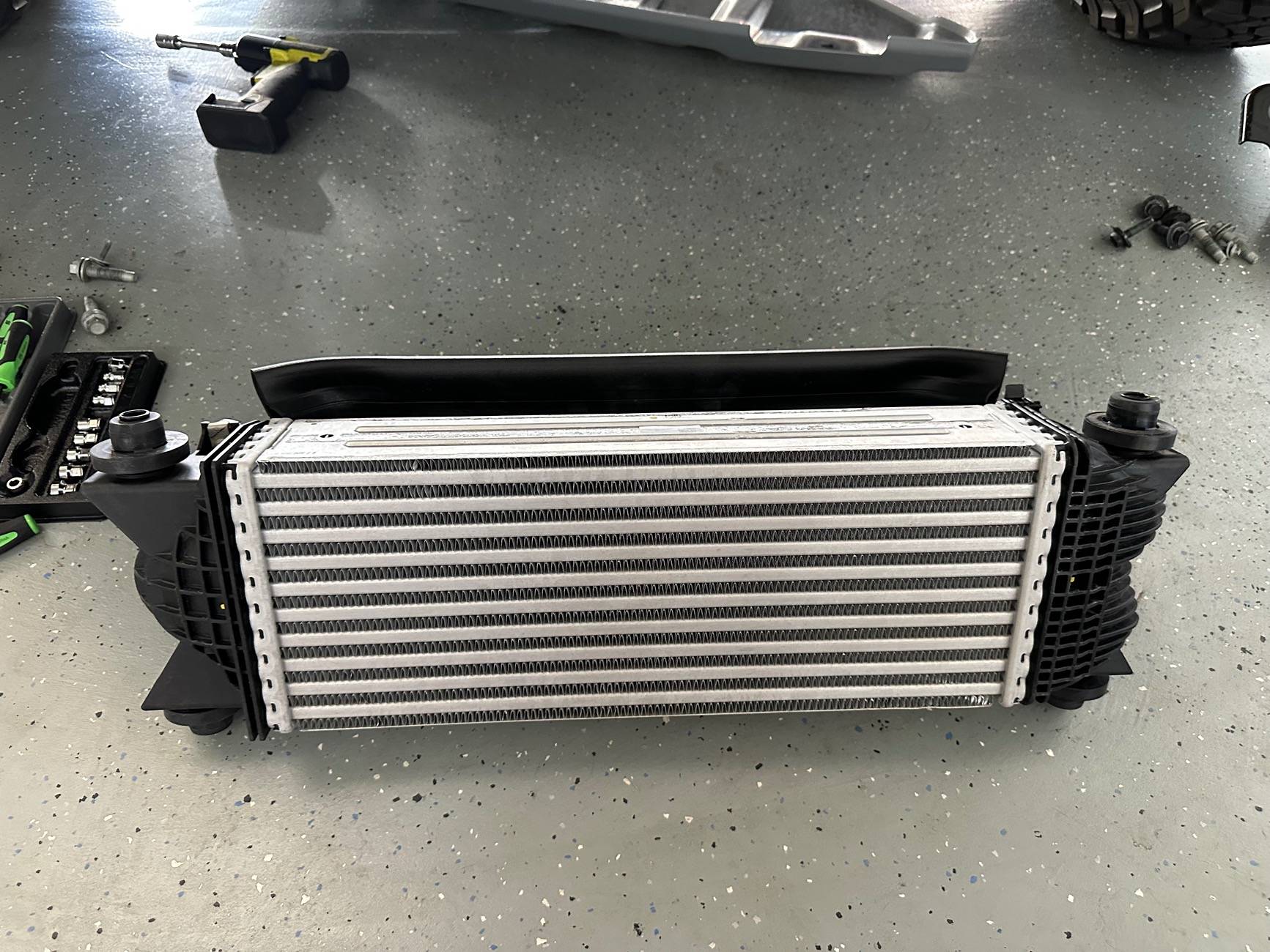

Did yours come with the foam tape you put on top of the IC? Mine came with some real thin stuff and I thought was to go between the fins and that back plastic piece?
Also did you reuse and of the front plastic shroud? I took the entire thing out but wondering if I could of reused part of it.

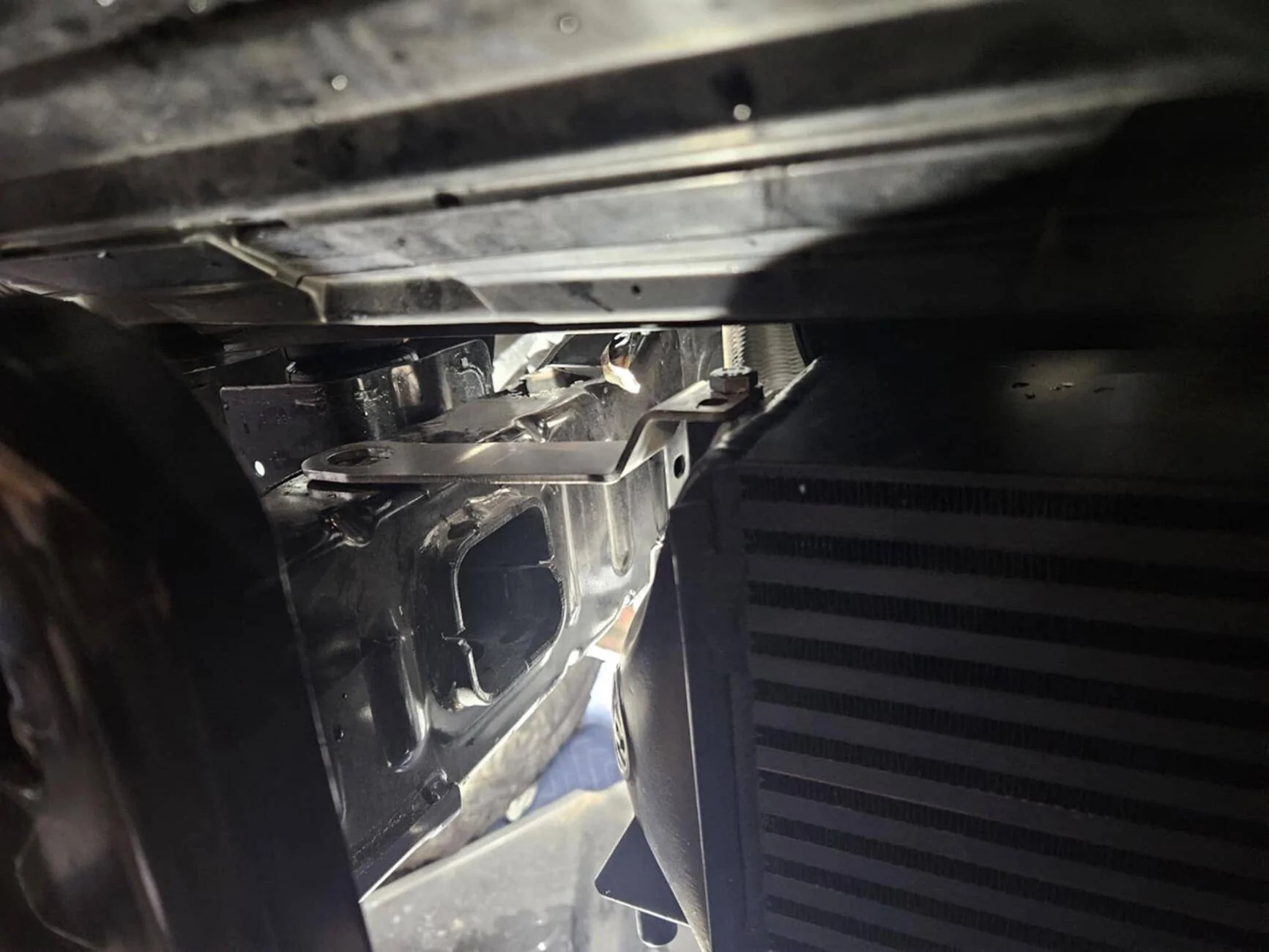

Ford Ranger Has anyone installed a new intercooler on their own yet? 1734360522339-x
I think this is the only image we are missing from a full wagnar install. This is the bracket from the IC to the frame. I think I have it on the wrong side in this pic, I flipped it later. The orientation is the one that puts the IC closest to the front of the truck.
Also I did install that other bolt I left one out and it loose to slide it around if needed. The bolts on the IC are SUPER close, I couldn't use a ratchet on it.
On the drivers side one of my holes wasn't tapped right and had to retap, otherwise everything else was super good quality.
Yeah, I couldnt fit the IC up there with the brackets attached. So I just used the tow hook brackets to keep it mounted in place.
