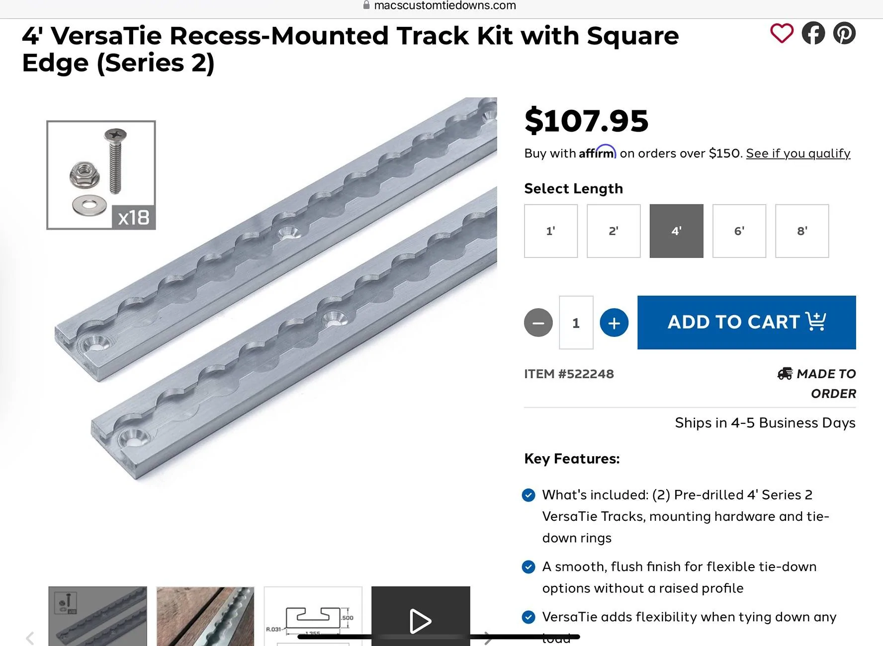

I dislike the unobtanium factory cargo rail system, it looks as if it would be dead simple to through-bolt track sections to the inside edges of the plastic trim, into the steel. You would just need to add spacers of the correct thickness to prevent the plastic from getting damaged. Adding a track to the front bed cross rail would be easier yet.

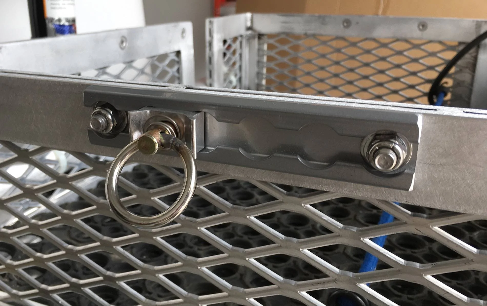

I have used these track kits on many different vehicles and trailers, the results are excellent, and the welded ring tie downs are rated at a whopping 2000 pounds at a 45 degree pull angle.
I am unsure about the floor tracks, I haven’t crawled around under there to see if you could use nuts for some of the screws. You might have to use steel rivnuts, which I am fine with. I have that tooling… I would probably hold off on the floor tracks, since I may buy a Decked drawer system, and that would block them (but the Decked would add its own tie downs along its top edges.)
https://www.macscustomtiedowns.com/track/l-track-versatie/kits/c/214/
10% off if you sign up for emails. Comments are welcome.

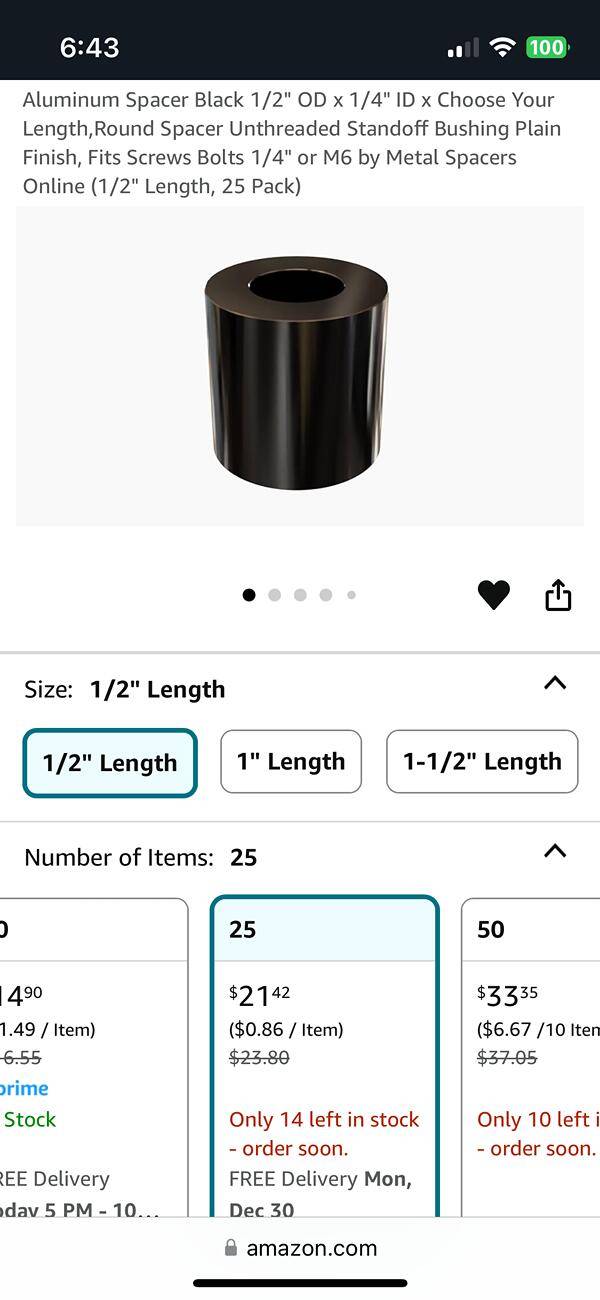

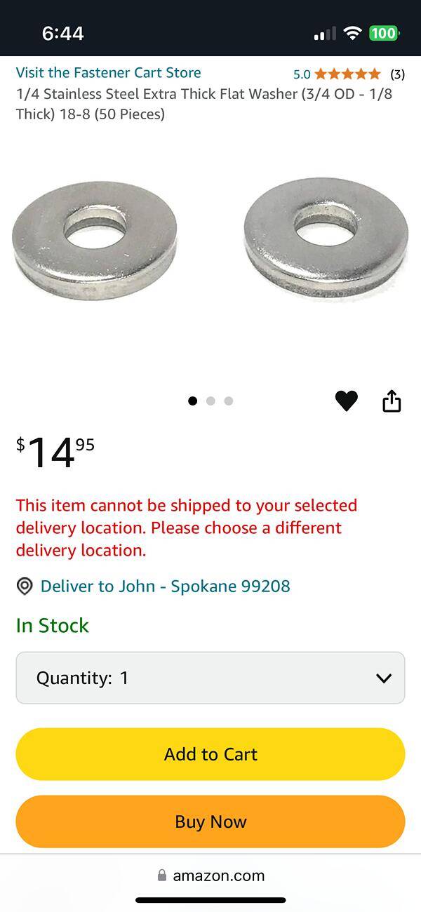

Cool, FYI I was going to use 1/4” stainless bolts and these washers and spacers for the plastic rails. For the bed, be sure those fender washers are thick, the thin versions are useless.
Extra thick flat washers
Anodized aluminum spacers
I am not sure why the washers won’t ship to me, I have seen that Amazon warning before with health related items like bulk full body wipes that don’t have individual safety warnings, but never for hardware …! Does anyone know the reason?

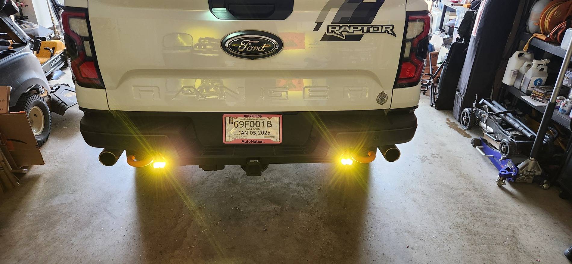

So I have used larger fender washers for years including our trip to Baja and they work perfectly. I will install the L track tomorrow because I ran out of time. I did however install chase lights.

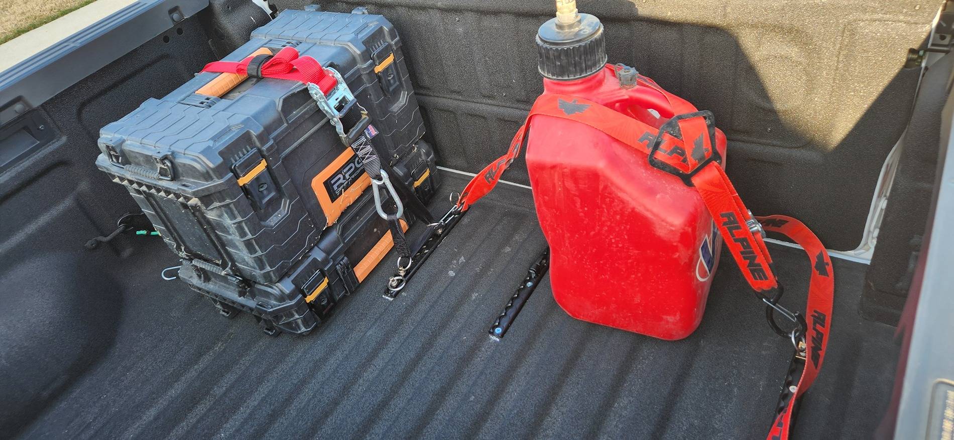

I've done 4 x 1.5m L track rails from front of bed to the tailgate.
tie down everything and everything. jerry cans, recovery gear, xmas tree LOL
just got big washers.. drilled straight through the tray and bolted it on. fantastic.

Any chance you could share pictures, including where you bolted it underneath?
