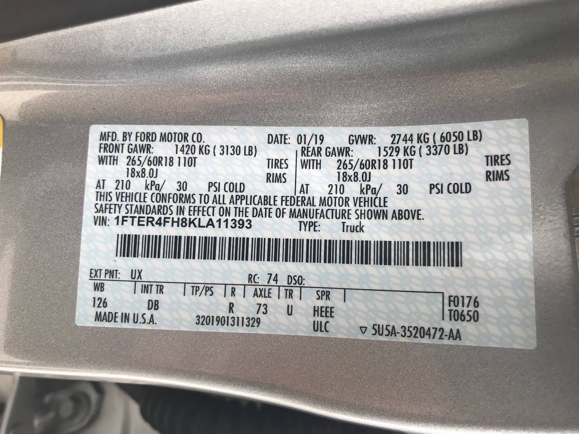

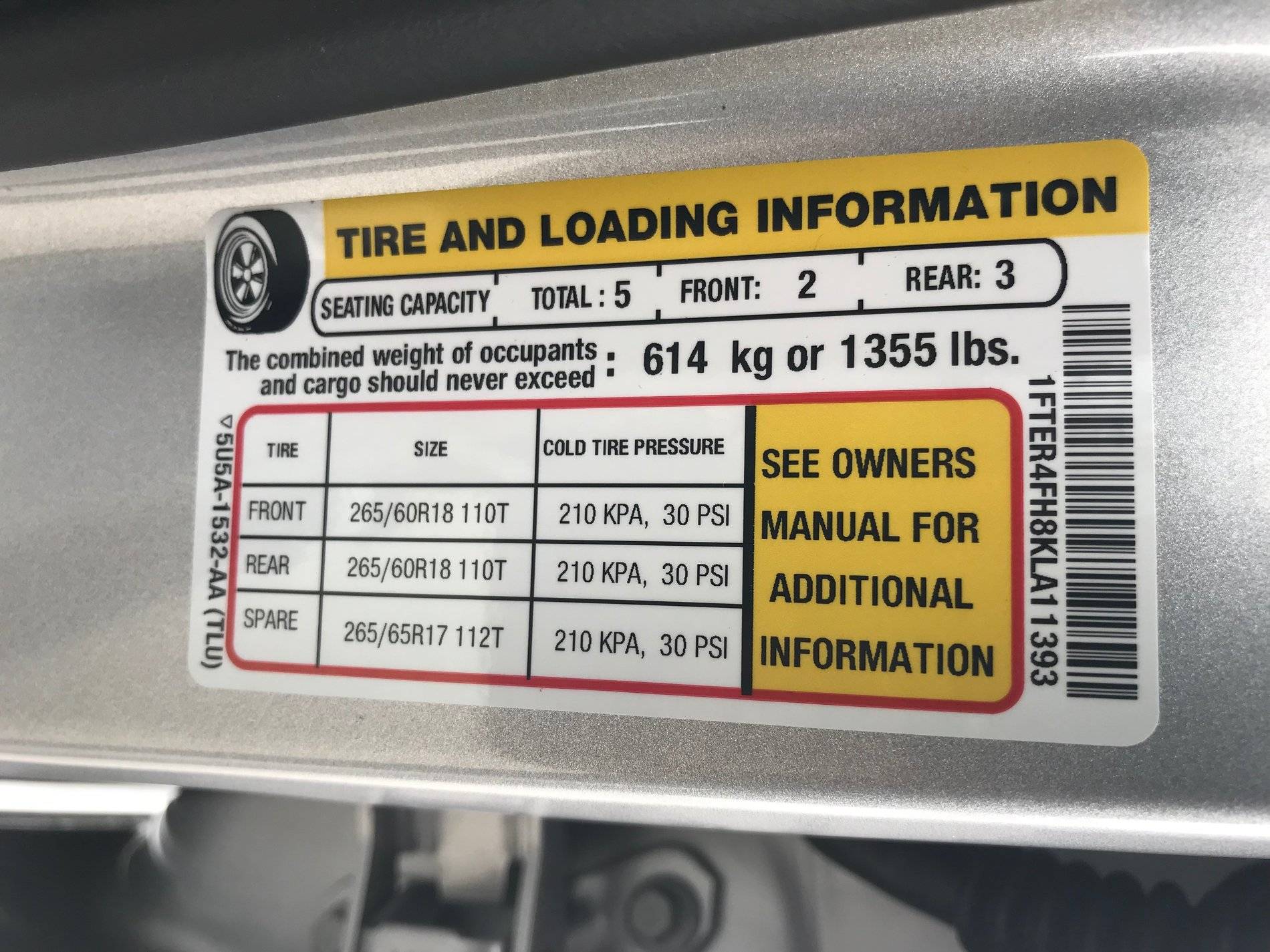

FINALLY ! This is the same size tire I have! No sticker on my truck, so I called my dealership - they suggested 35-39 psi. I just called Ford's main number on their website . They had no idea for this size and suggested that I call a different dealership. FINALLY the answer I needed - 30 psi. Mine came with 48 psi, btw.
How do you not have a sticker? The certification label is required, so you're either looking in the wrong place or need to have a conversation with the dealer.
