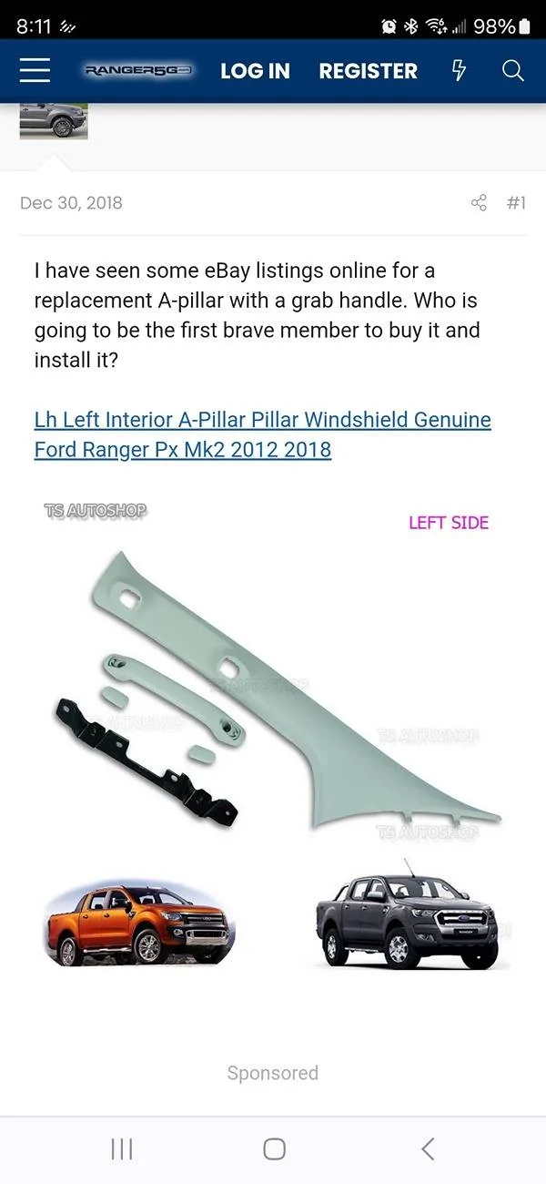

So I've spent a little time on this, and I think I know some things, and I know I don't know some other things. Going through the parts list, here's what I think I know:
  • There is a valid part number for a bracket that fits the driver's (LH) side. From some of the discussions here and on other threads, North American Rangers do not come with this bracket installed, but from all of the Ford parts sources I have seen thus far, part number N1WZ-26312A49-D is correct for this bracket for the driver's side (N1WZ-26312A48-C is the separate and distinct part number for the passenger [RH] side). This bracket is attached to the A-pillar with bolt W720168-S439, so the question is whether NA rangers have the hole drilled/tapped in the A-pillar on the LH side. Seems reasonable to assume this would be the case since the part is sold by Ford, there should be a prepared mount point to attach the part.
  • There are multiple part numbers for the A-pillar trim under callout 03598. There seems to be two part numbers per side (LH, RH) for three trim levels, XL/XLT, Lariat, and Redback (Raptor), an early part number, and then a superseding part number after 8/01/2024. The latest part numbers for the LH A-pillar trim as of this writing are:
N1WZ-2603599-DB - XL/XLT
N1WZ-2603599-ED - Lariat
N1WZ-2603599-EC - Raptor
Since these are the only LH part numbers for all three trims (after the supersession on 8/1/24) for North American Rangers, it is unlikely that they contain the molding for the handle to fit.​
  • There is only one callout for the handle (31406) under two part numbers (KB3Z-2131406-AB - ebony, KB3Z-2131406-AC - gray) which means there is only one handle manufactured for NA Rangers, assuming it is a RH part only (not specified in the part description).
Those are the main three parts needed to make this conversion work. Other than the bracket, I do not believe any of the trim pieces are available in the NA market. I will continue to look to see if I can find any ROW Ford parts distributors and research their part numbers as well.

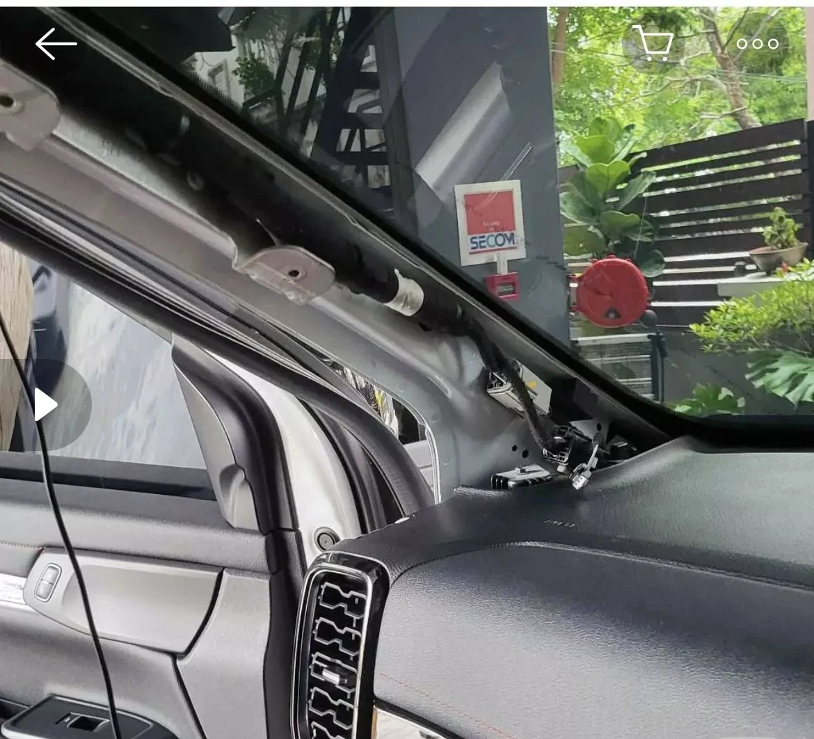

I had it smart when I dropped the head liner, no dice! No mounts and an airbag.

I know there's an airbag. There's one on the RH side too. I think it fits under the bracket on the RH side and should be similarly situated under the new bracket mounted to the LH side. The question is whether there's a bolt hole for the bracket to mount on the LH side.
Nope

Do you have a picture of both sides so we can put this to rest finally?
I don’t but on the passenger side there is a bracket the handle attaches to, on the drivers side there are two plastic T clips that mount to the A pillar and help hold the pillar cover in place. It’s a bitch to get hooked up after removal.
