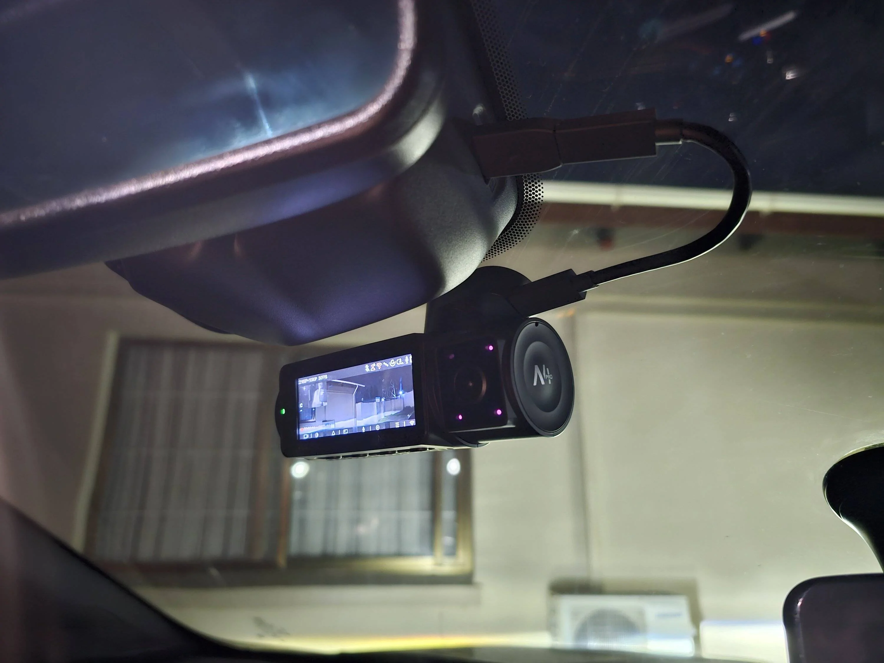

The Ford offered options are just 3rd party dashcams.
Better off doing a bit of research and buying the best for your money.
I use the Vantrue N4 Pro as it's one of about 3 dashcams that can actually read plates at night.
And yes, there is a USB port but it is only powered when the car/accessory power is on. I believe this is region dependant as the South African spec and Zambian spec do not come with the port. They just have a cutout where it was supposed to be 😂
