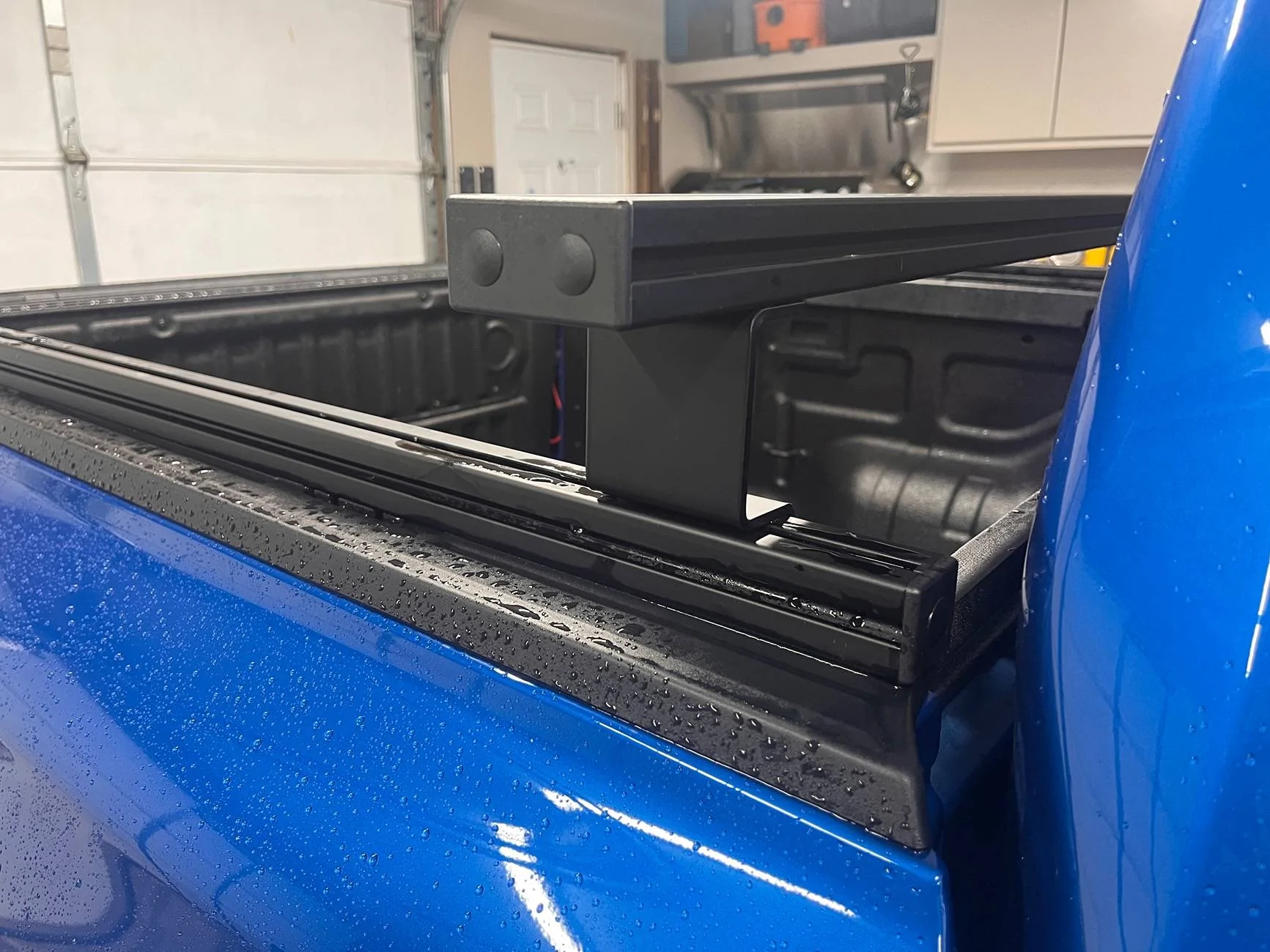

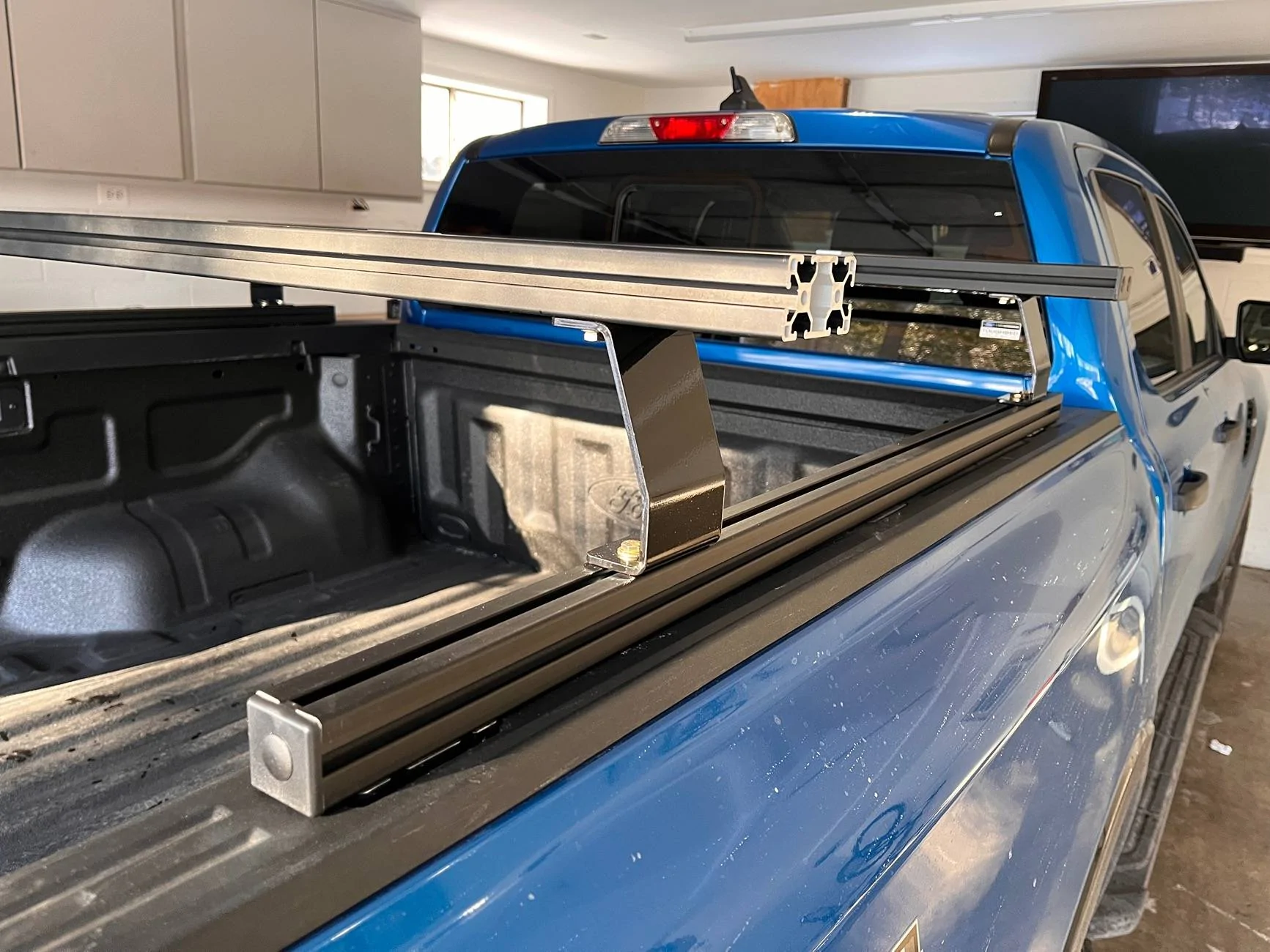

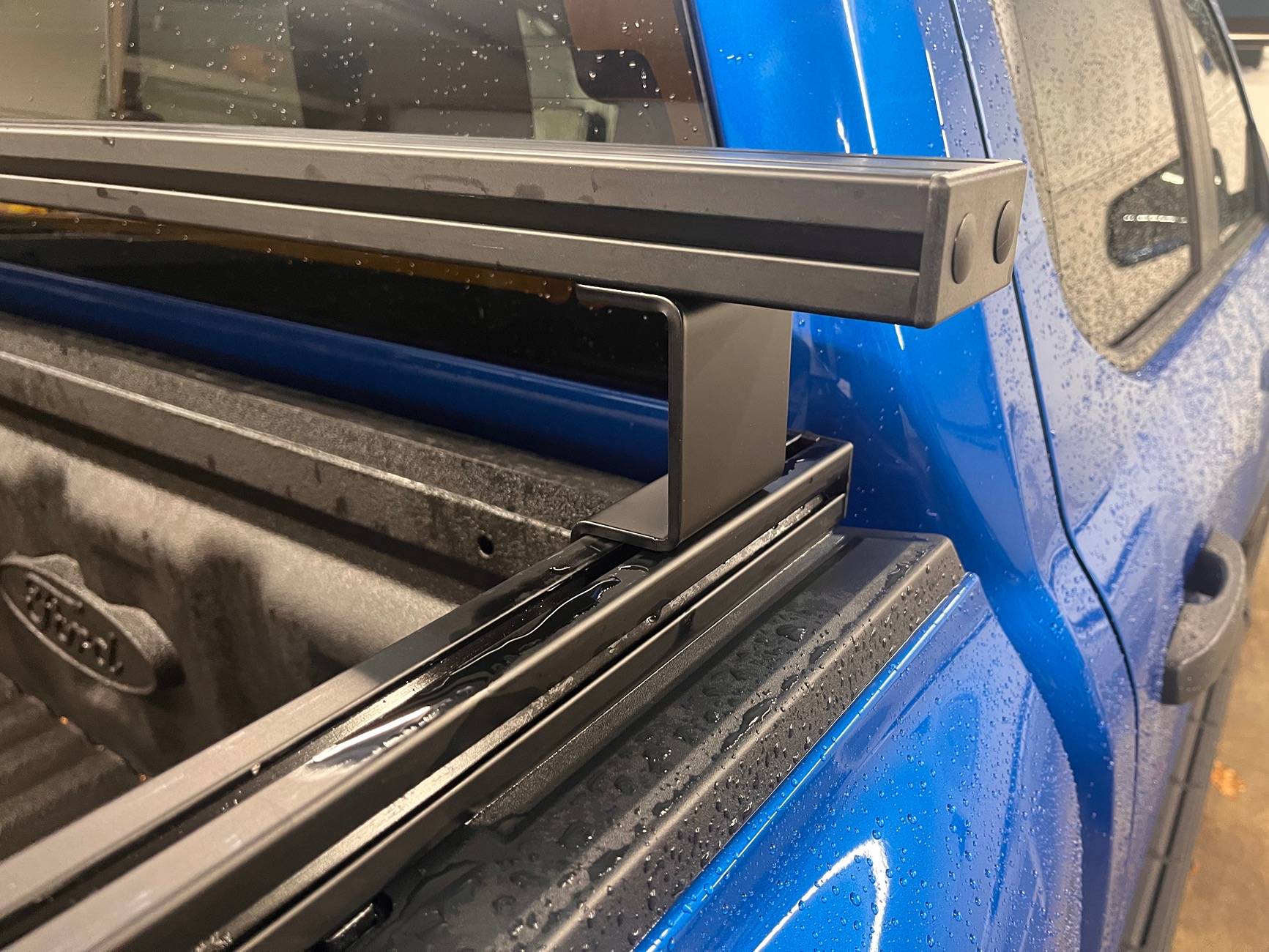

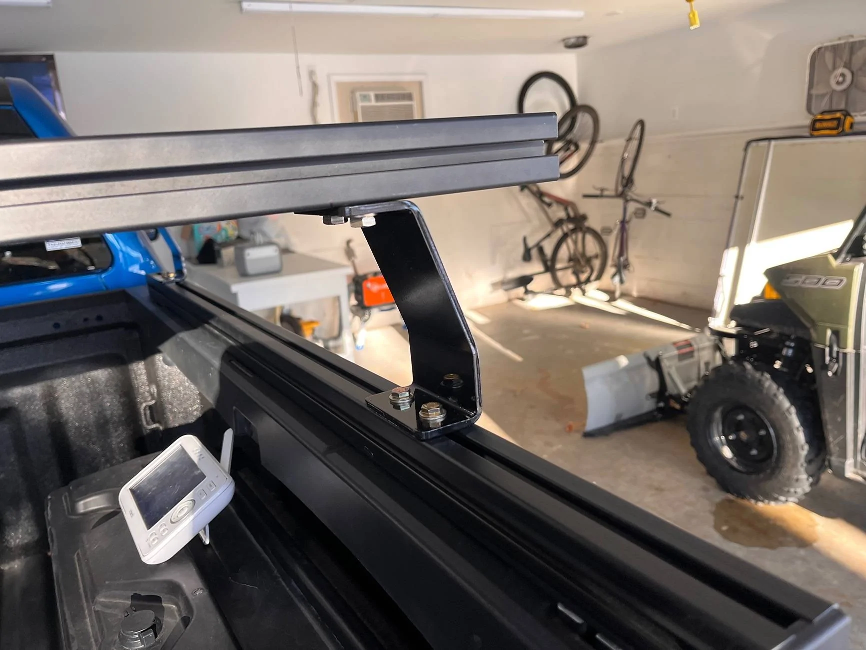

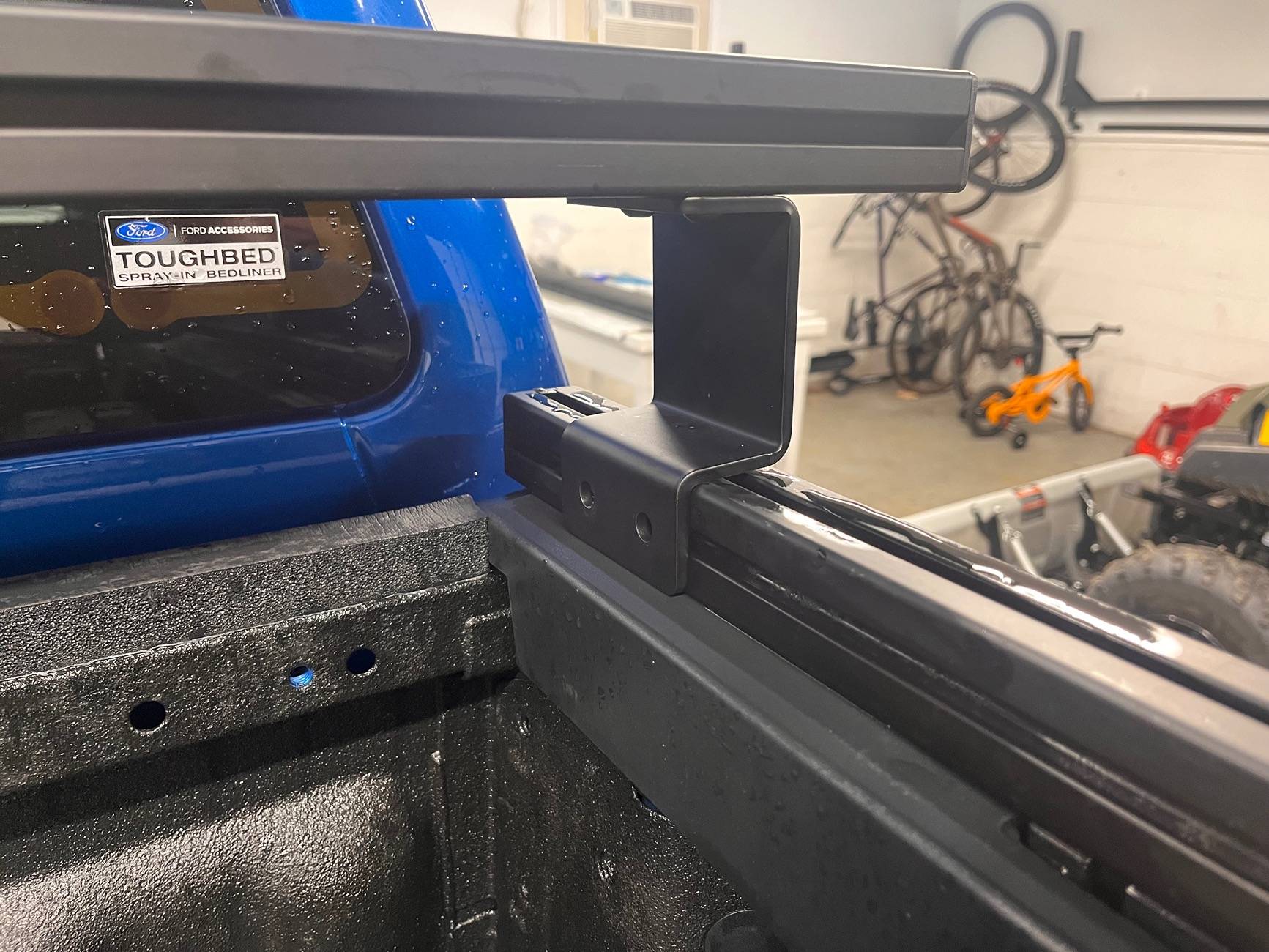

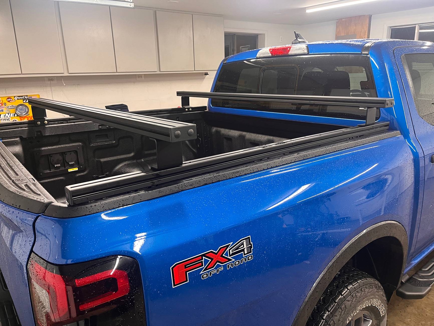

made some revisions.
load is spread out better, more adjustability, and quicker removal.

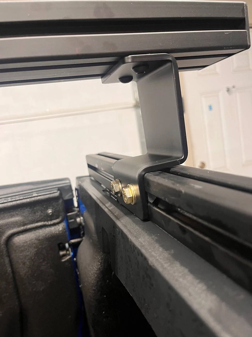

basically i made two spacers out of 1530, opened the holes to 5/16.
front spacers are 7/8, ones by the rear are 3/4. i haven’t done the middle set, haven’t felt it’s needed, but i may. those spacers are 13/16.

That V2 design is really nice. It should let you adjust spacing or add another bar for whatever you want on top down the road. I will probably do something similar with 8020 uprights of some sort when I get time.
Did you weigh it? Curious of the total weight? Those extrusions are beefier than they appear from my experience.

i think it’s around 50, based on shipping weight.
i wish i went full length with the 1515, but at 47” it was 16 bucks to ship. at 58” it was 56 bucks to ship.

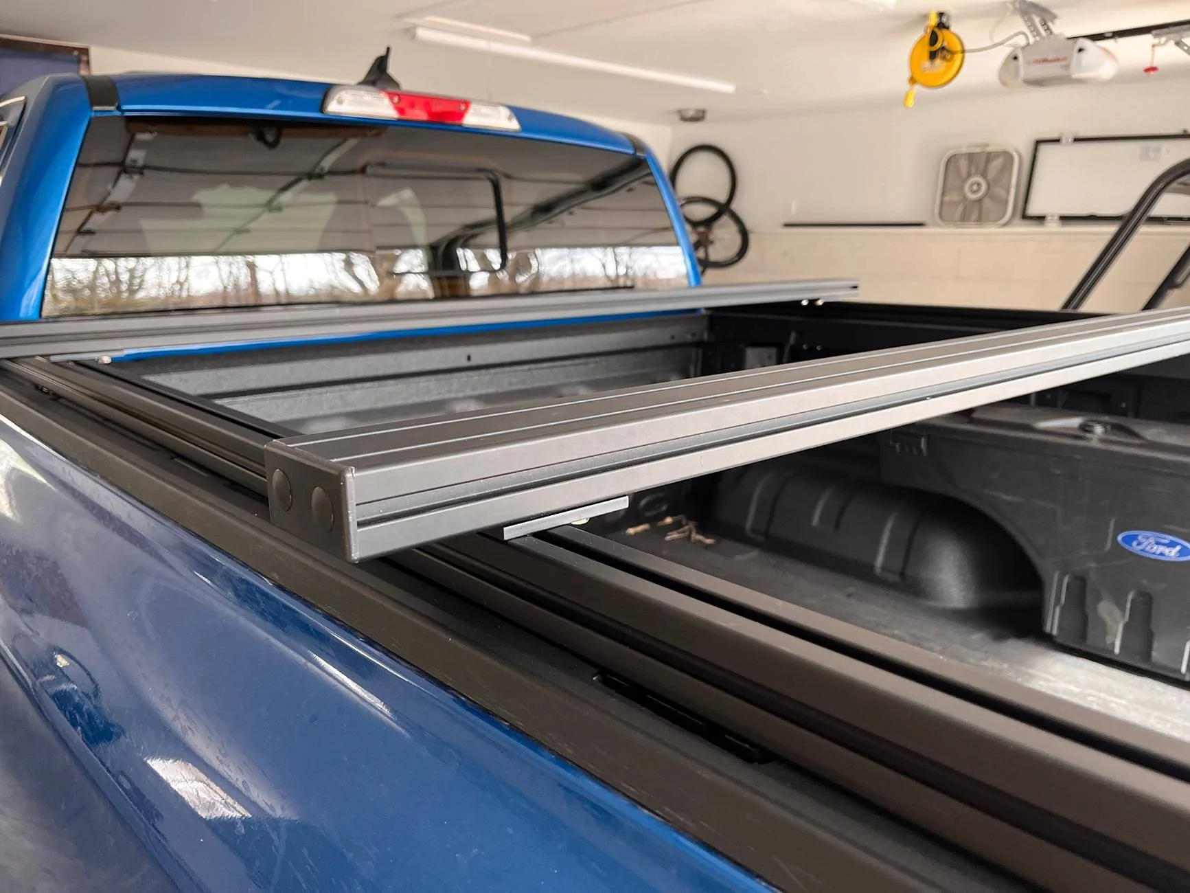

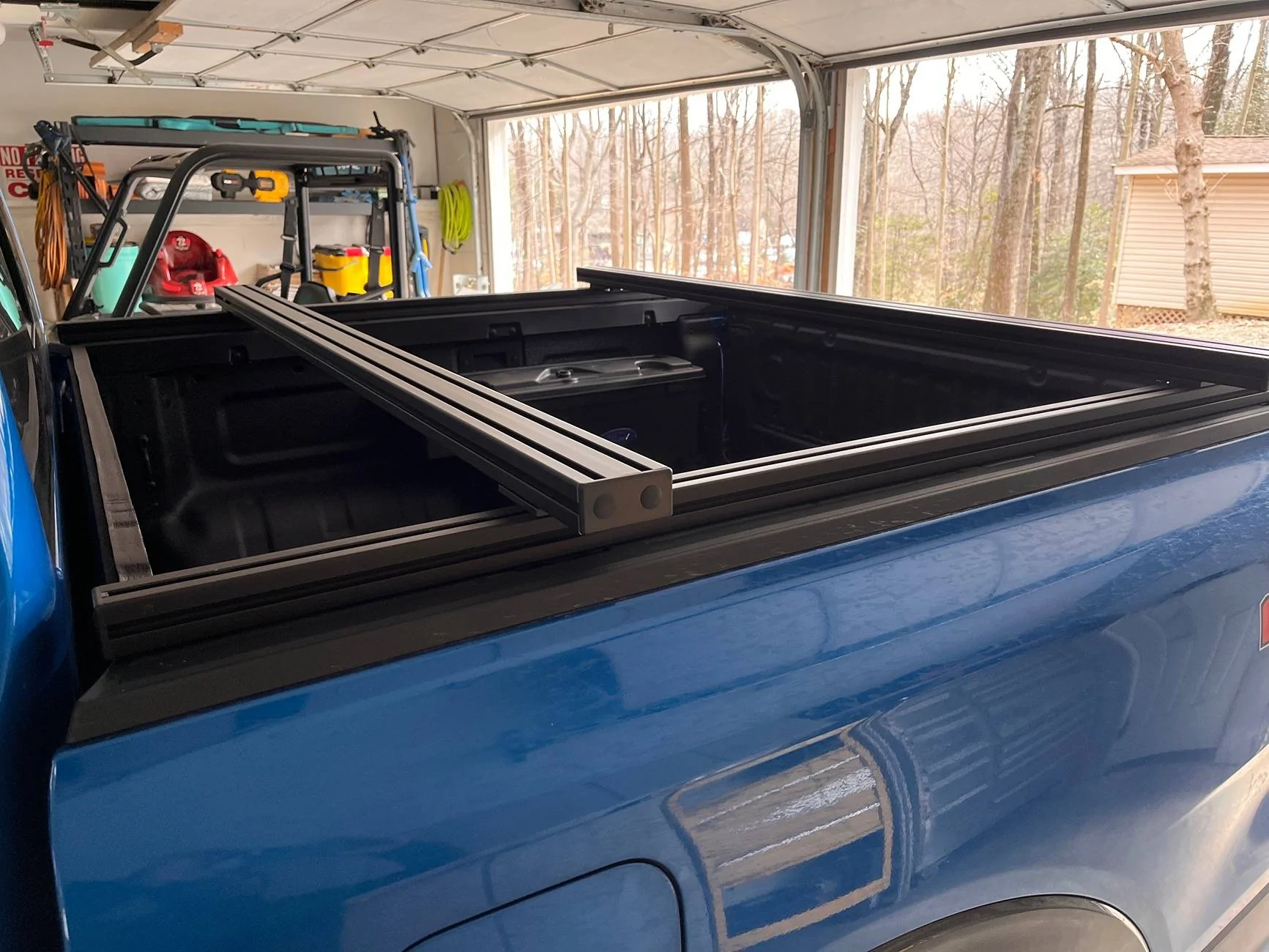

2024 xlt

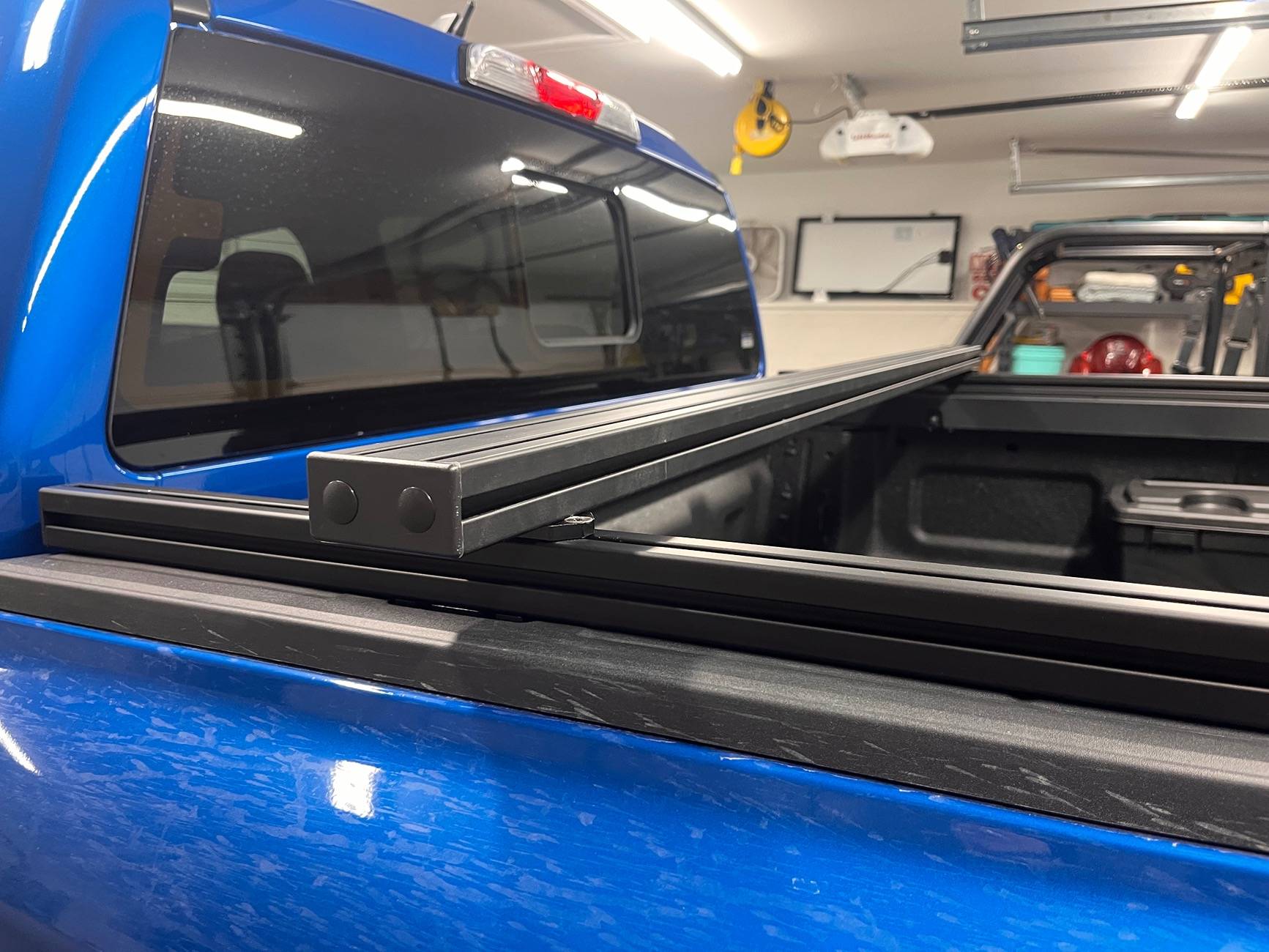

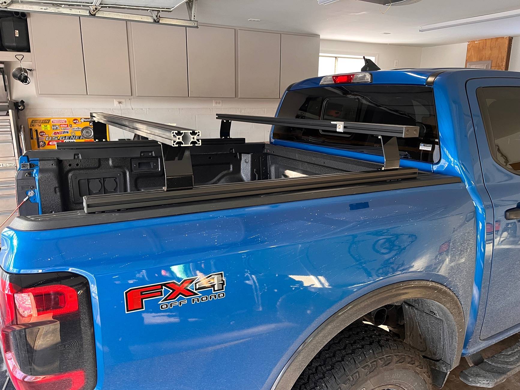

new design. using off the shelf extrusion parts. base bars attached using grade 5 (8 is overkill) carriage bolts in the track with spacers in the stake pockets, bolted through.
crossbars are mounted using the 4 hole 15 series bracket, one side countersunk so it’s flush. ( i would rather counterbore but didn’t have one around, but whatever).

That looks pretty functional with a super low profile and minimal weight. It appears you could still put the canister type bed cover under it, or use your original risers for a roll top bed cover. It should be super flexible for attachments and low profile enough to keep most things out of the wind.
Thanks for posting. I am sure I will be copying it at some point.

i am going to make another set of riser brackets, 1/4” black anodized aluminum this time, 3” rise. i will be able to roll a soft tonneau up a bit easier.
those brackets will cost 118 just to have made.
the whole idea is to make a rack that’s easy on and off.
this way i have it right now- alittle more cumbersome take off- a good thing and bad thing.
