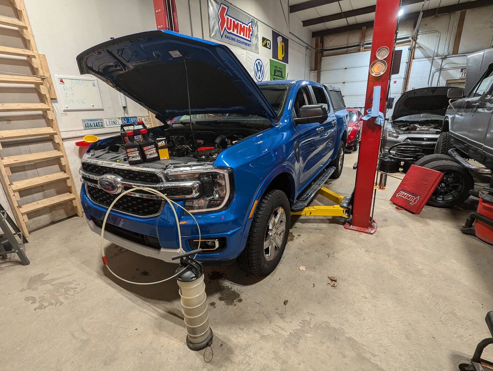

I have a hand pump version that I've been using on VWs and Minis for a decade. With the engine warm I shove the hose down the dip stick, give it 10-15 pumps and watch for fluid to start coming. At that point I start to remove the filter (give it a couple of min to lower the overall level) and work on the filter replacement and o-rings. At some point I'll give it another 5 pumps or so and wait until it starts sucking air. I then start to feed the tube up/down a bit while giving it a few more pumps to try and get everything out and make sure I didn't miss something. Before I install the filter I pull the hose from the dipstick and place it in the filter cup and give a few more pumps (there's typically a couple fl oz in the cup).
Replace dipstick, pour a bit of fresh oil in the filter cup, install filter, fill oil. Whole process is probably 15-20min if I'm diligent. I've only done one change on my '24 so far (not my daily) and it took a bit longer because it took a coupe of tries to find the right depth for the hose in the dipstick tube, but once I got it right it pulled a solid 6qt out.

Next change I'm going to do a video of the process on my truck, but I have done one in the past on my VW which is the same process:

I watched your video and another one about the Harbor Freight version that looks similar to yours. It looks like the hand pump version is all that is needed. I'm sold. Thanks
