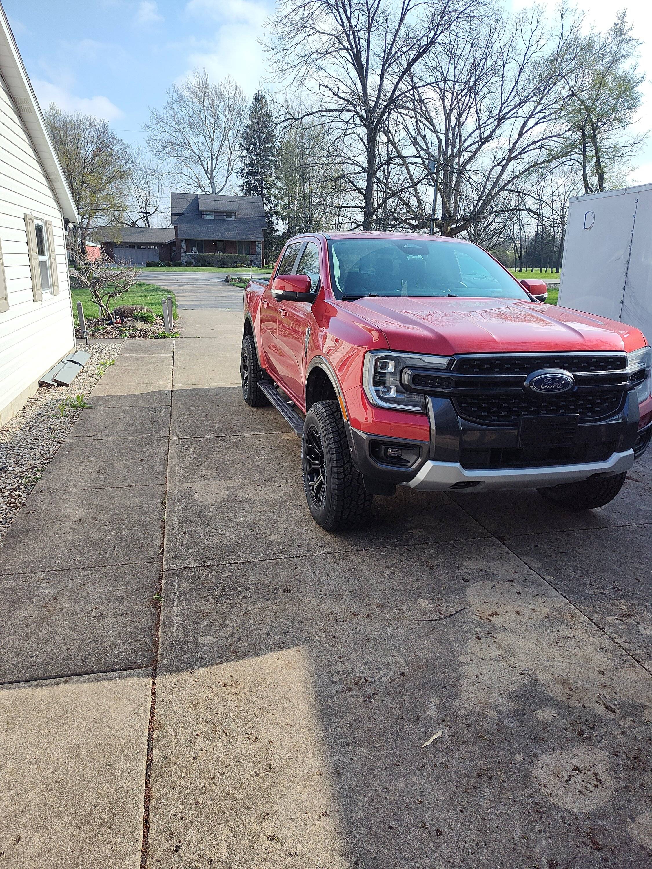

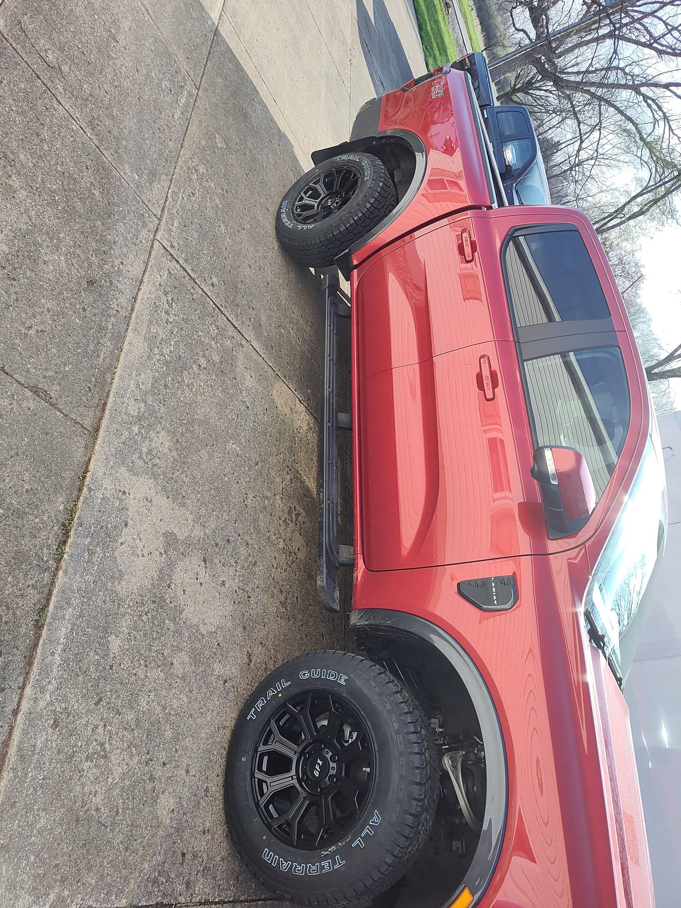

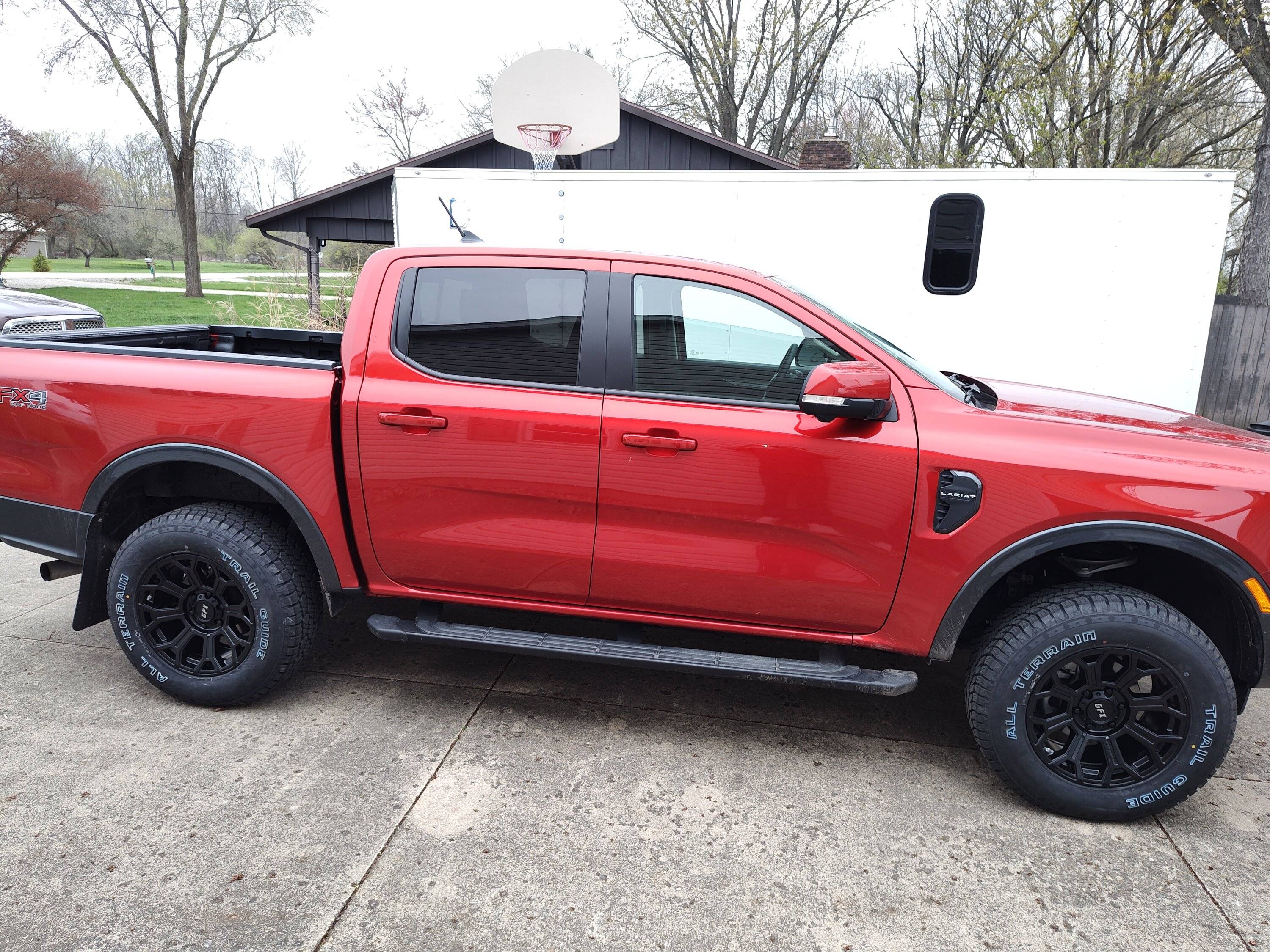

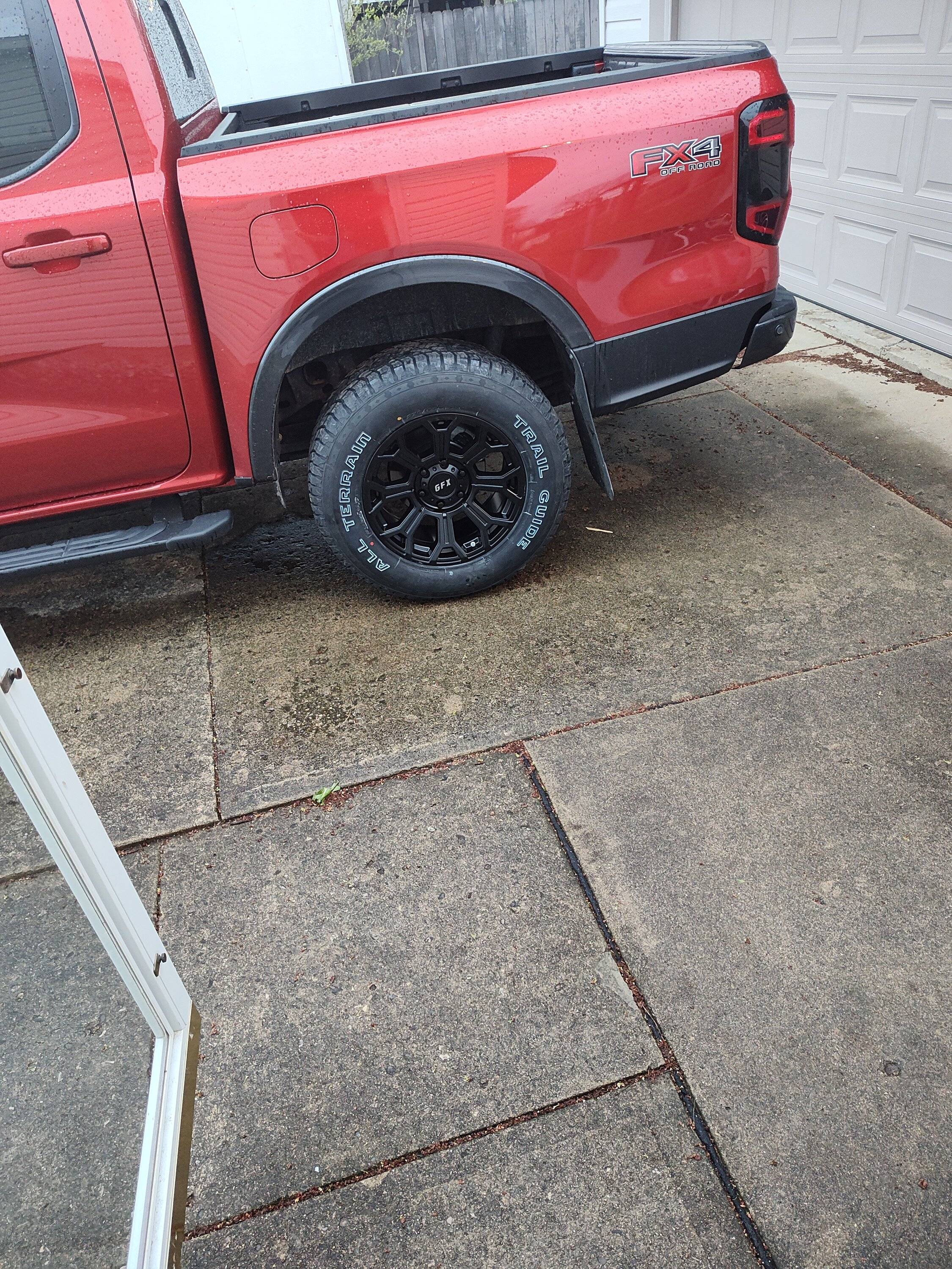

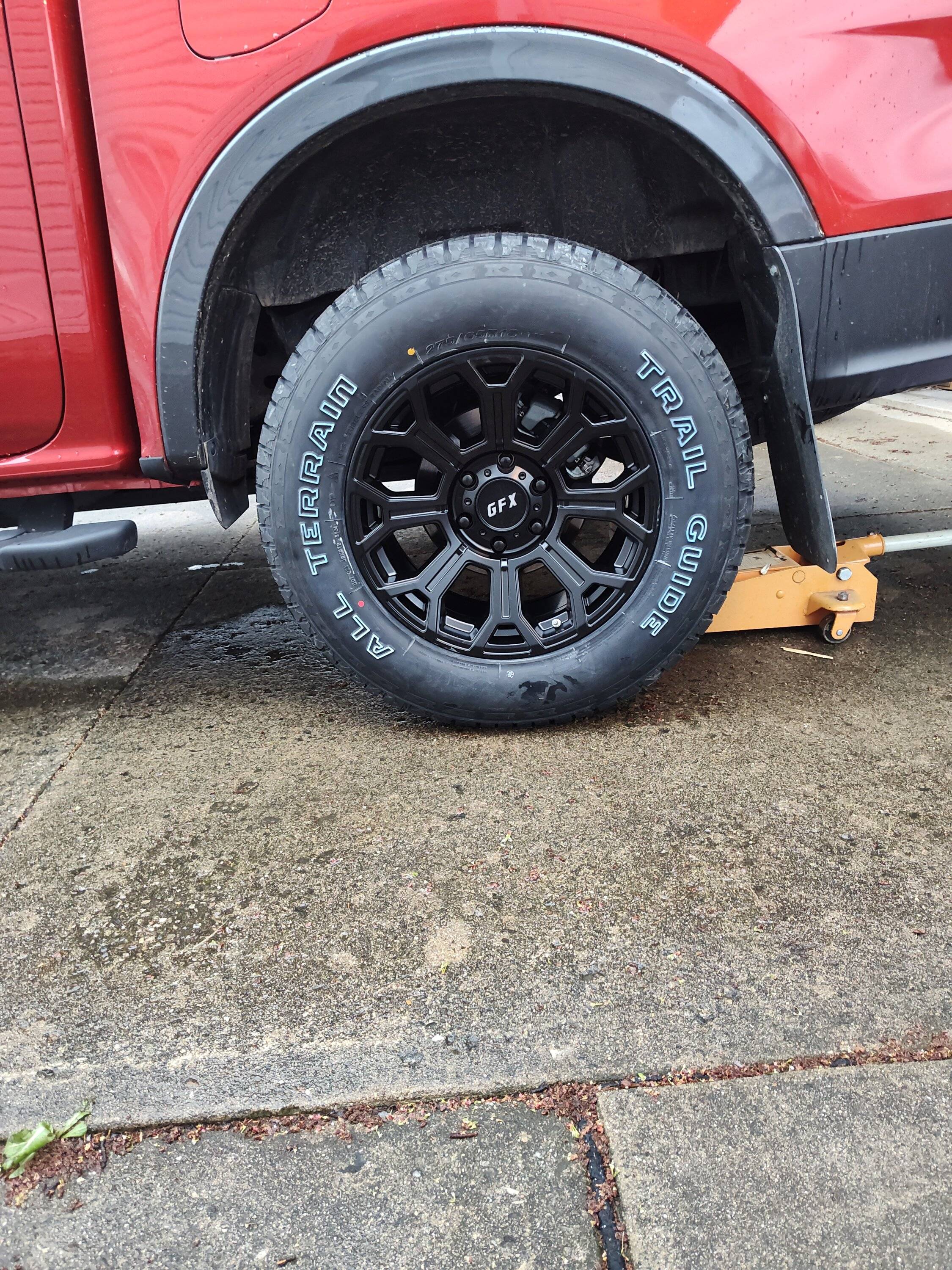

Before and after pics of my wheel/tire upgrade on a budget. Im not great with cameras, sorry!
Here is what I used/paid:
Rough Country level kit $518 installed with alignment (I simply didn’t feel like DIYing this one).
https://www.roughcountry.com/product/ford-leveling-lift-kit-50100
G-FX TR19 Rim 18X9 6X139.7 Offset +12 Matte Black (Ebay) $720.00
https://www.ebay.com/itm/175676739954
I went kinda budget on the tires. I used these on my F150 and had good luck with them. I know white lettering is a polarizing topic but I like them. 275/65R18 (32”) $541 total
https://www.amazon.com/dp/B01M8KY548?ref=ppx_yo2ov_dt_b_fed_asin_title
Accessories to make all this work:
Hib Rings https://www.amazon.com/dp/B0B3LT7Z1M?ref=ppx_yo2ov_dt_b_fed_asin_title
Lugnuts: https://www.amazon.com/dp/B078RCLR71?ref=ppx_yo2ov_dt_b_fed_asin_title&th=1
$39 for both
TPMS: https://www.amazon.com/dp/B0BRQVG1JK?ref=ppx_yo2ov_dt_b_fed_asin_title&th=1
No programming needed, truck recognized them without doing anything, recommended from another post. $84
Total cost of this upgrade: $1902

Do you have the 2.3 or 2.7? My understanding is that the same leveling kit with the 2.7 will result in less lift than advertised. Can you measure the gap front and rear so we know what lift you actually got/how it sits using that kit?

I have the v6. I didnt take measurements before and the new tires are already on.
There is a SLIGHT Rake now, but there was significant before the lift kit.
Its a 2.5 inch kit and I feel like I probably got 2 inches.
Several youtube videos of V6 rangers with same kit say they got 2 inches.

Hmm, I think I like more sidewall with 70 or 75 ratio tires. I think that 65 makes tires appear smaller than they actually are.
