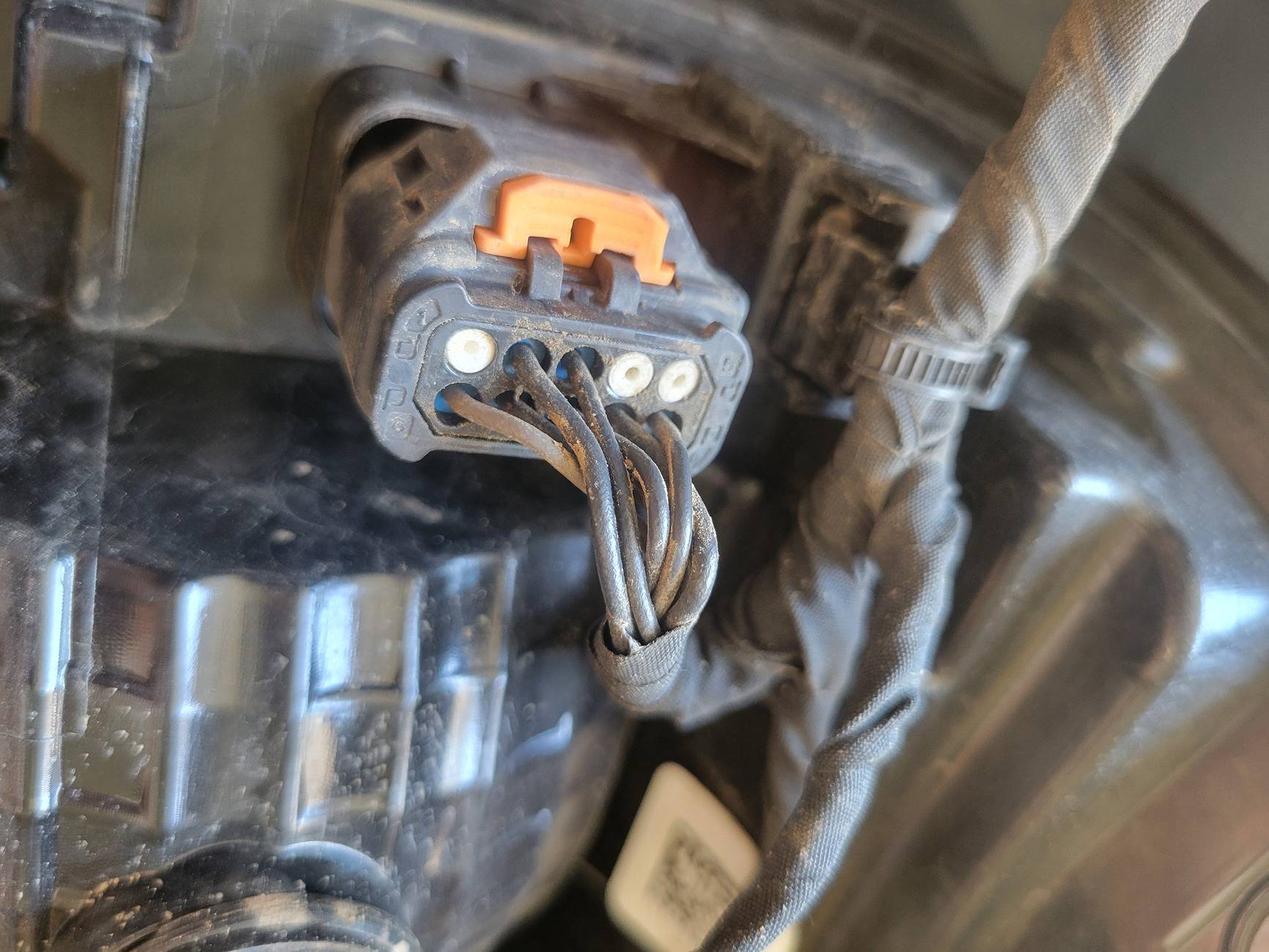

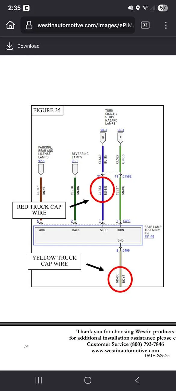

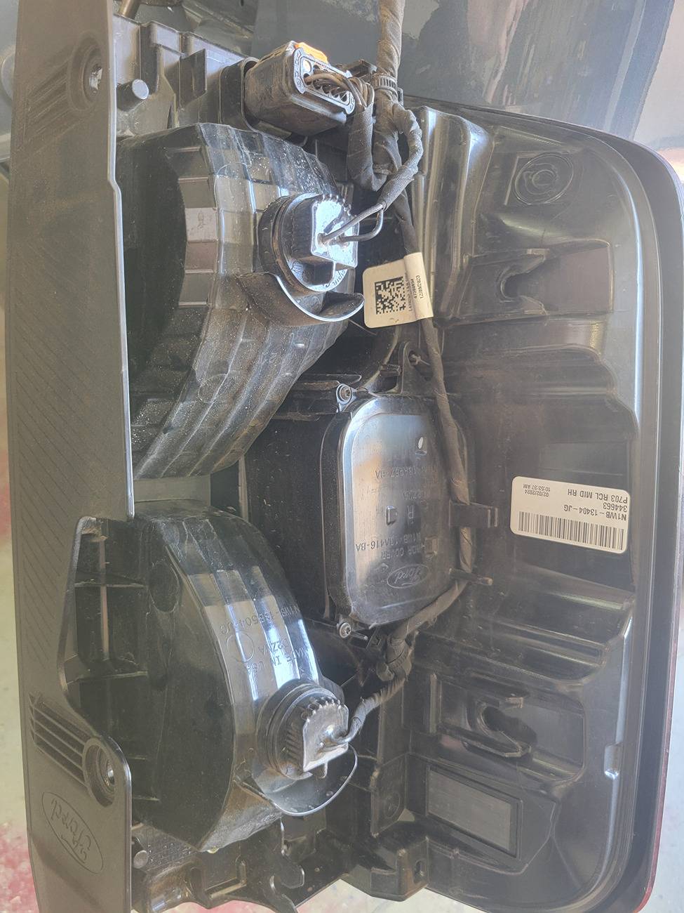

Does anyone know the wire color for the brake lights, I am trying to wire in some auxiliary lights and want to either tap into the brake light only or maybe tap into the trailer(brake light only) wiring.
