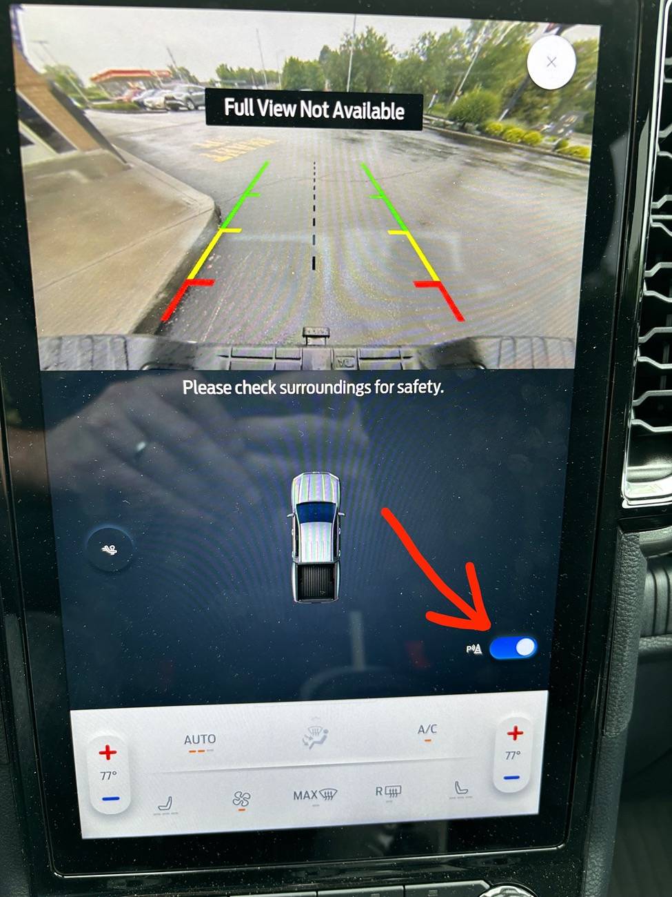

The system on my 6G is more sensitive than the one open my 5G was. If you know it's safe, you can just toggle the system off on the display. Mine somehow thinks the cracks in my road are dangerous around dusk. I just toggle the system off when I back up. It comes back on the next time you put it in reverse.
Ford Ranger Behavior of backup collision avoidance feature IMG_5797
