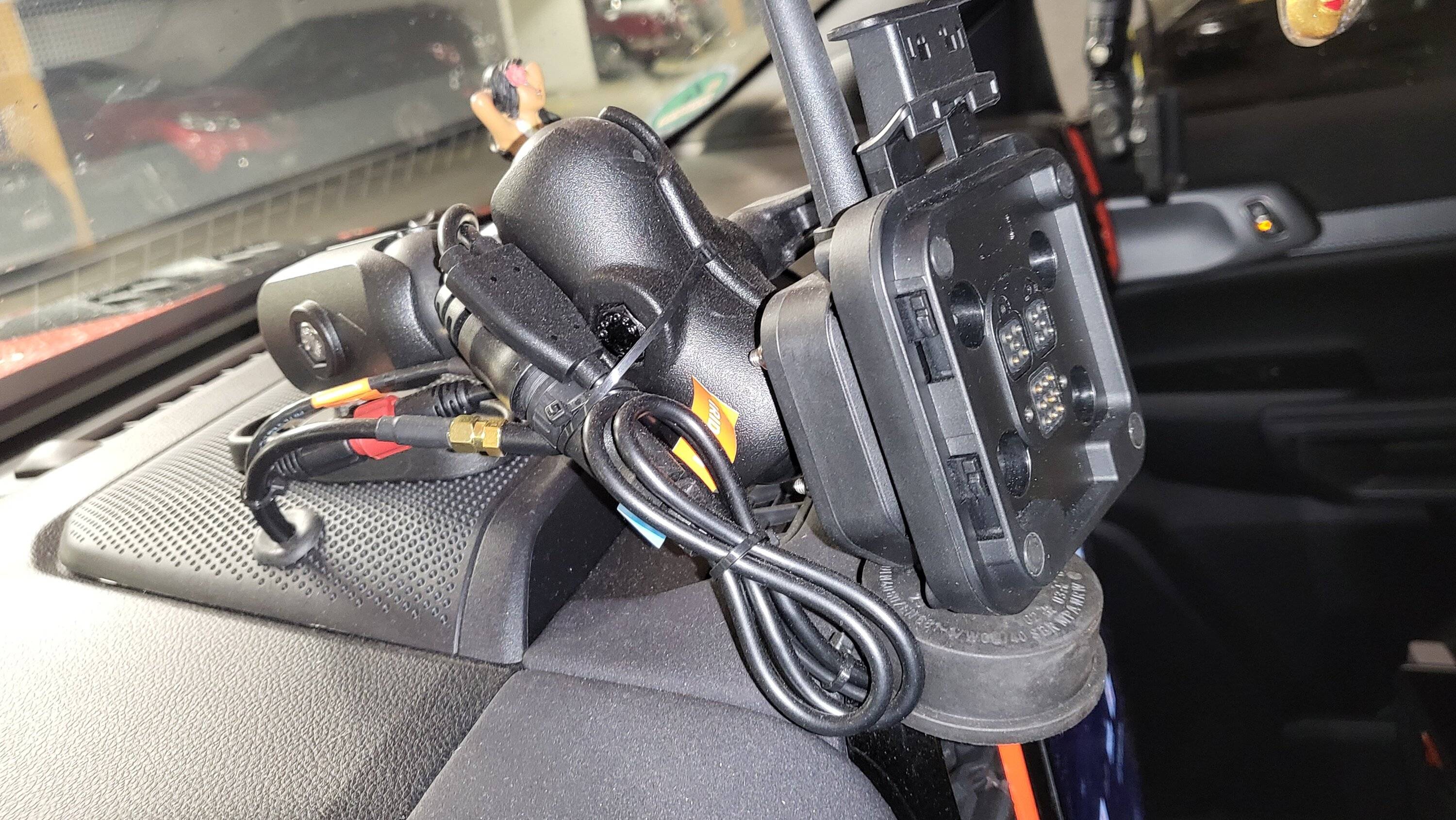

Sweet Setup! I haven't actually seen much about this so I’m curious... what are the attachment point options like on the raptor dash area? I see u mounted ur Garmin and stuff. Wondering if there's good areas for aftermarket mounts and such.

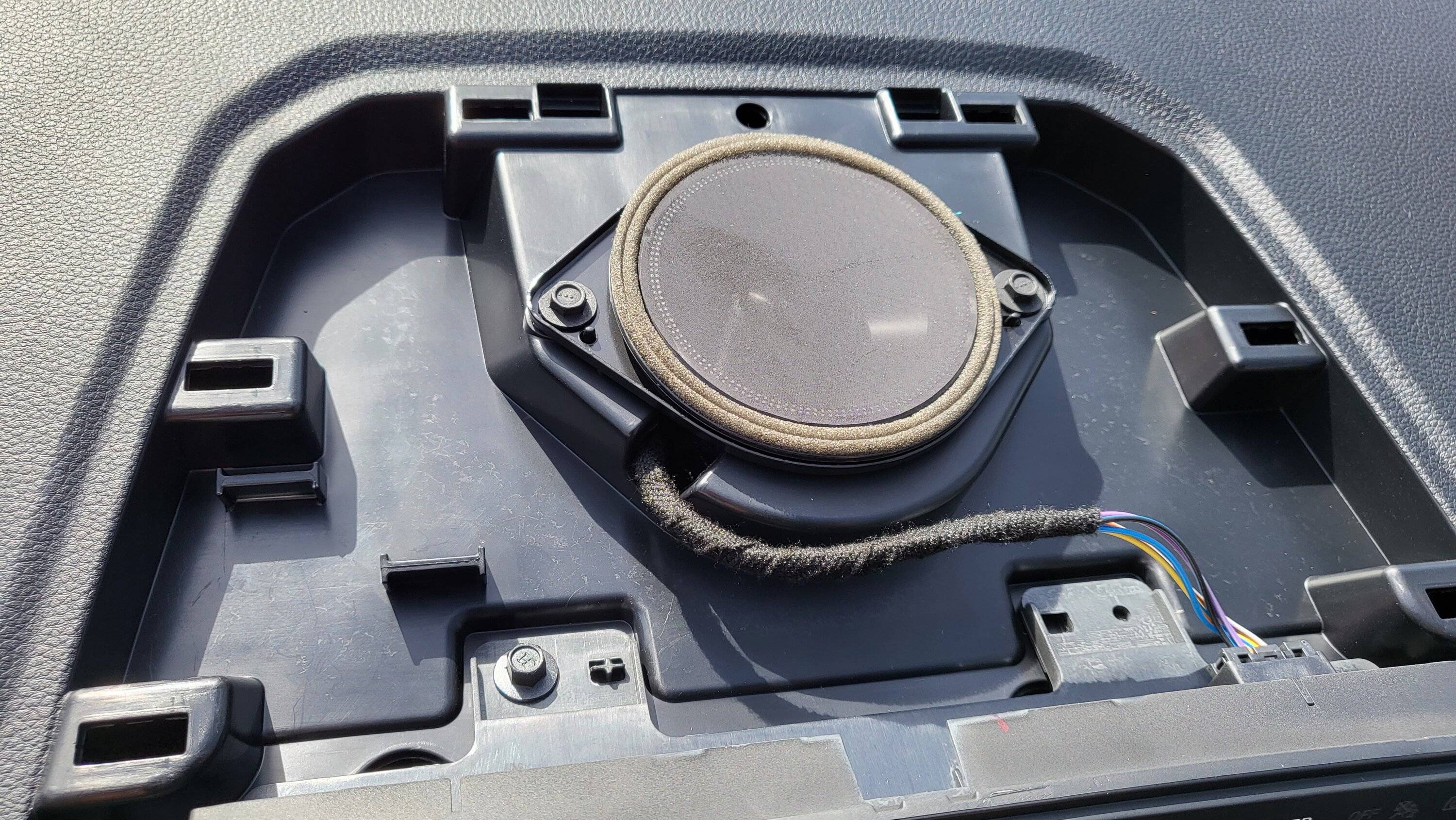

The best spot i found sofar was the center dash Loudspeaker cover. You can pop it right off with a car radio prior tool and put some stuff on that. I also have Go Pro mount on there.
BTW there is a USB2 like socket on the right side of the Front roof console (where the Upfitter Switches are) to power devices like a Go Pro etc.
Center dash Loudspeaker with cover Off :

So no issues when offroading with your GPS mounted on the cover as far as sturdiness or rattling
goes?

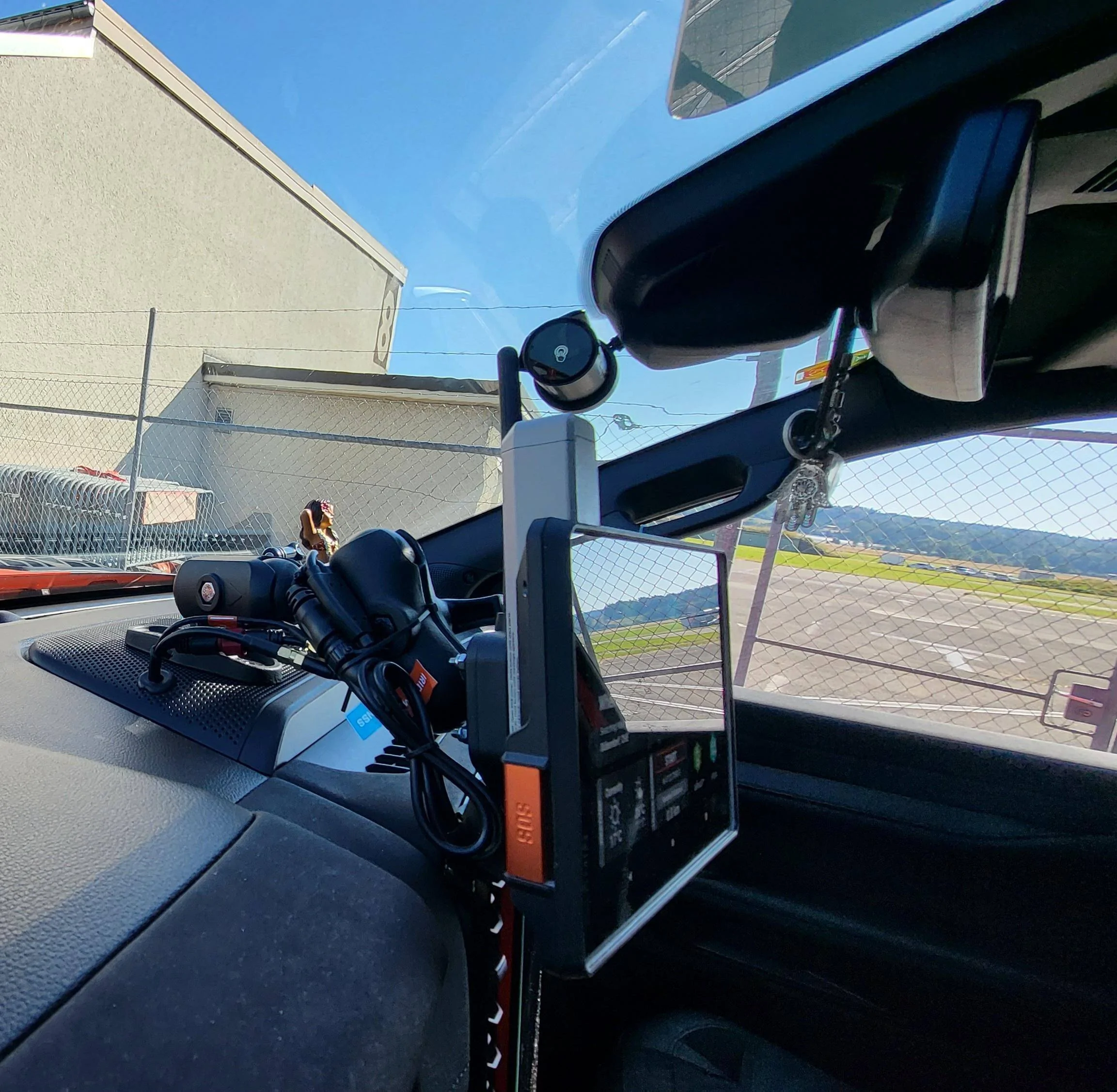

Hi jp001 no issues whatsoever - i used also a aluminium plate on the inside of the speaker cover and rubber Ring (actually wash machine waist water drainpipe-cover with an hole) right under the GPS holder/adapter. Done some heave off-roading - not a squeak !
