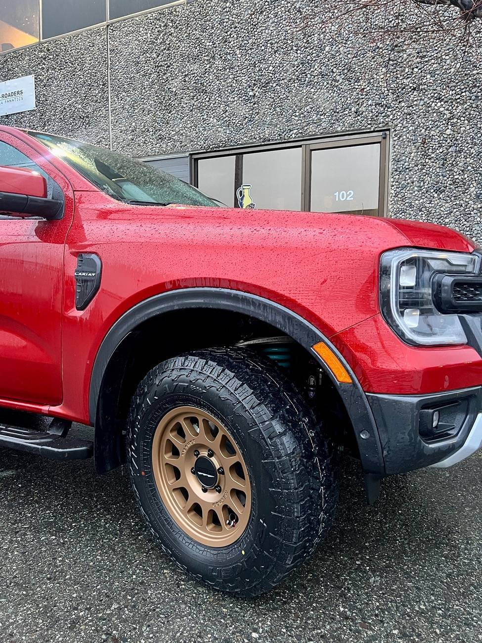

I am against poke and want to keep things tucked as much as functionally possible. This definitely achieves that with all the tread tucked in the arches, the sidewalls just peek out ever so slightly. All covered by the factory mudflaps too stopping anything being kicked up the side.
This is not a level, but a full 1.5" to 2" lift with new remote res adjustable shocks. Still a work in progress with manufacturers to confirm fitment.
No clearance issues, its just rubs ever ever so slightly at full lock on some of the flexible arch liner at the very front, easily fixed.

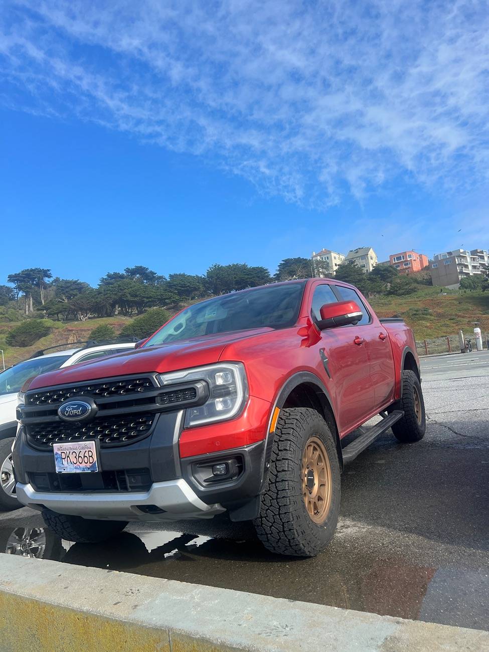

I think +35 is spot on for the standard Ranger, its also confirmed to fit 285/70R17 How much room would you say you have between the tire and the upper control arm?

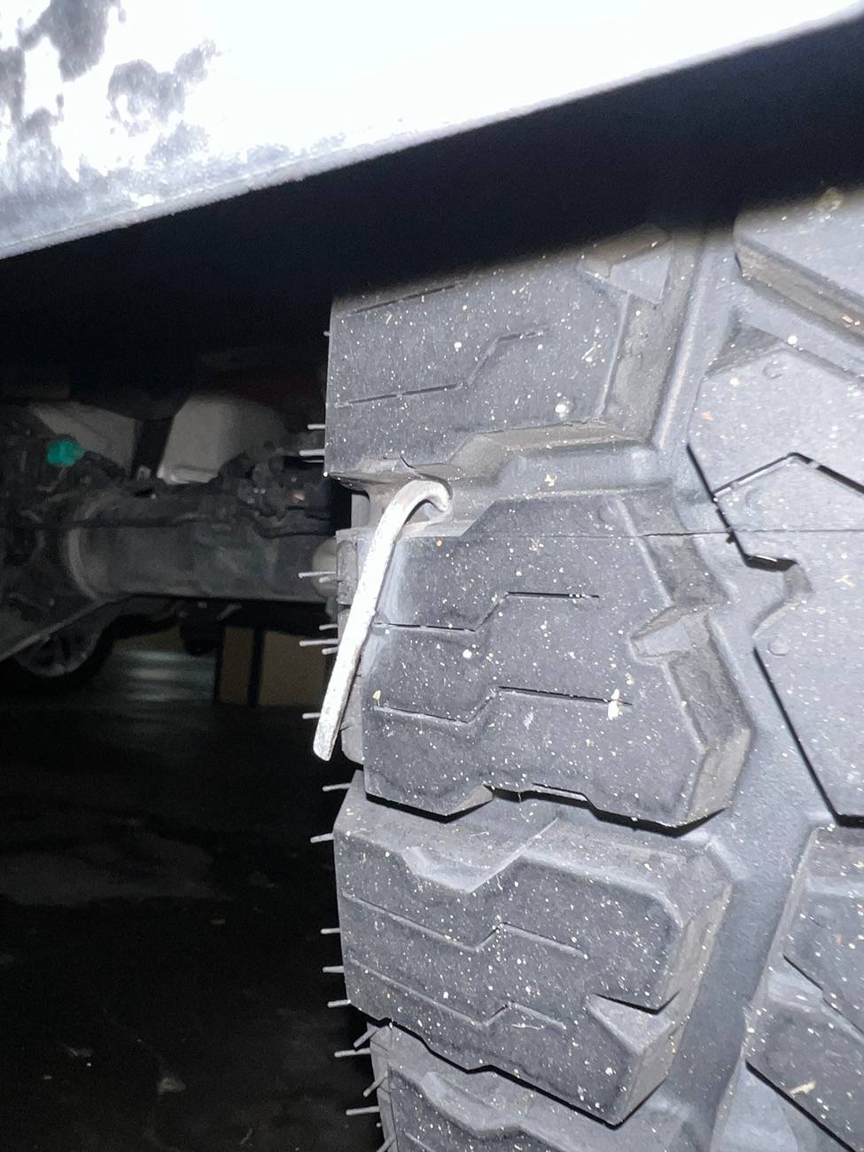

Welp, that didn't take long. Oh well, now have a correct size plugged tire for the spare. Every cloud an all that...

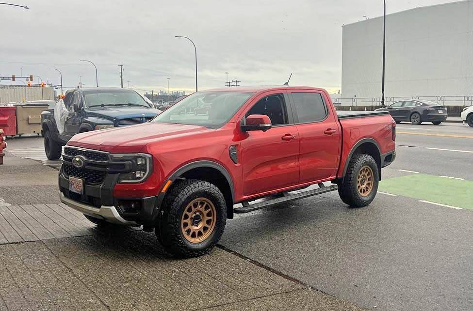

Ford Ranger 2" Lift, Method 703's and 275/70/17 Wildpeak tires on 2024 Ranger IMG_4749
Ford Ranger 2" Lift, Method 703's and 275/70/17 Wildpeak tires on 2024 Ranger IMG_4786

I have one
I know this is getting a bit tiring for you, but would you be willing to post a complete side shot and a front shot of your truck? Looking for a setup and right now it's hard to decide - 2" vs 2.5" : 275/70r17 vs 285/70r17 : +35 vs +25 offset. Too many options. Others feel free to jump in. Thanks in advance!
