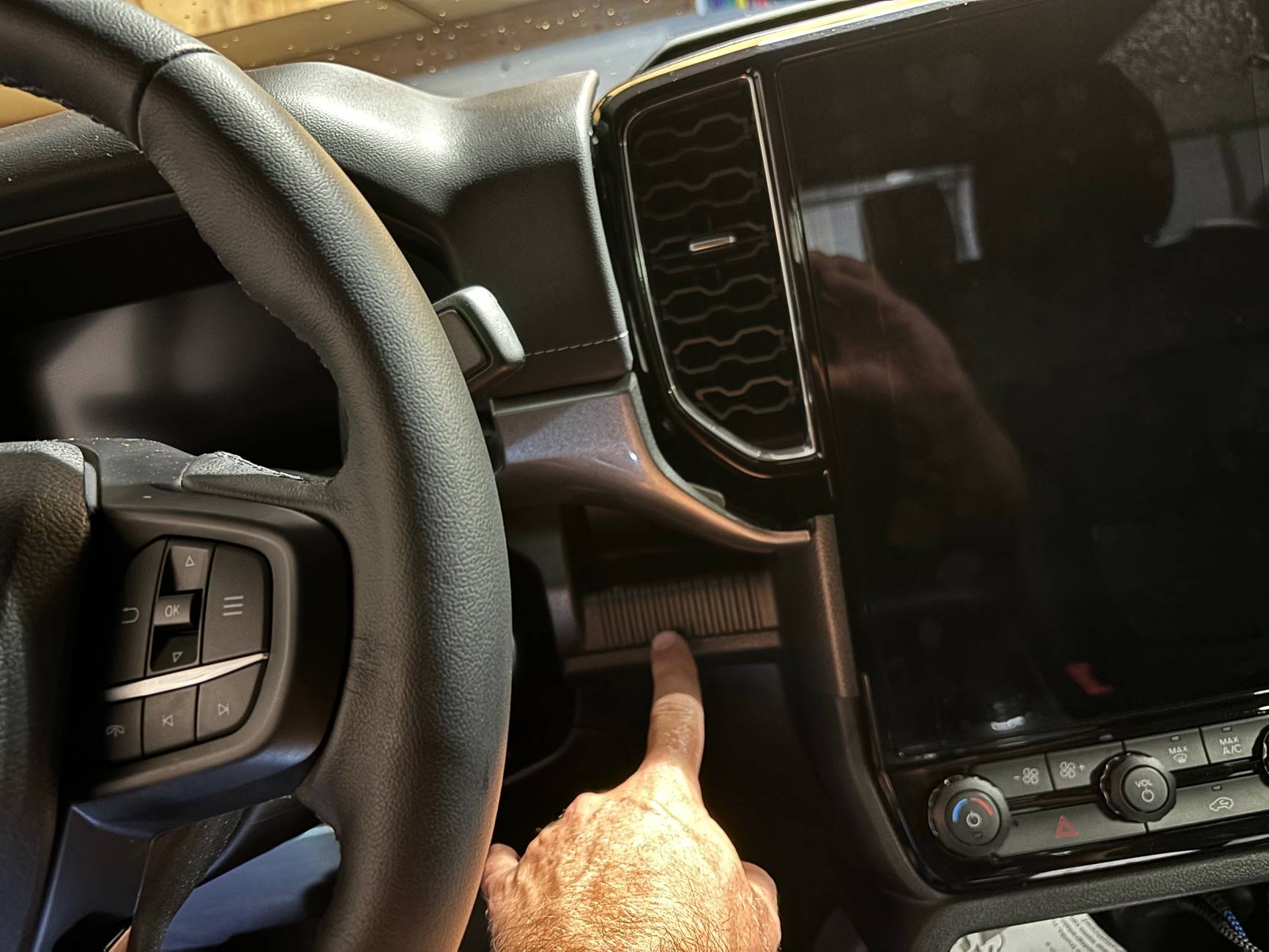

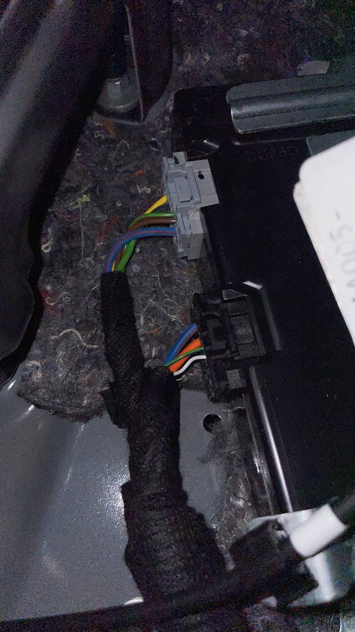

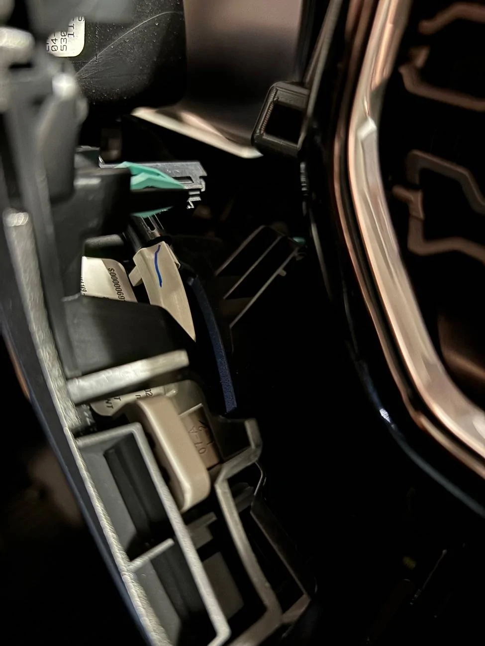

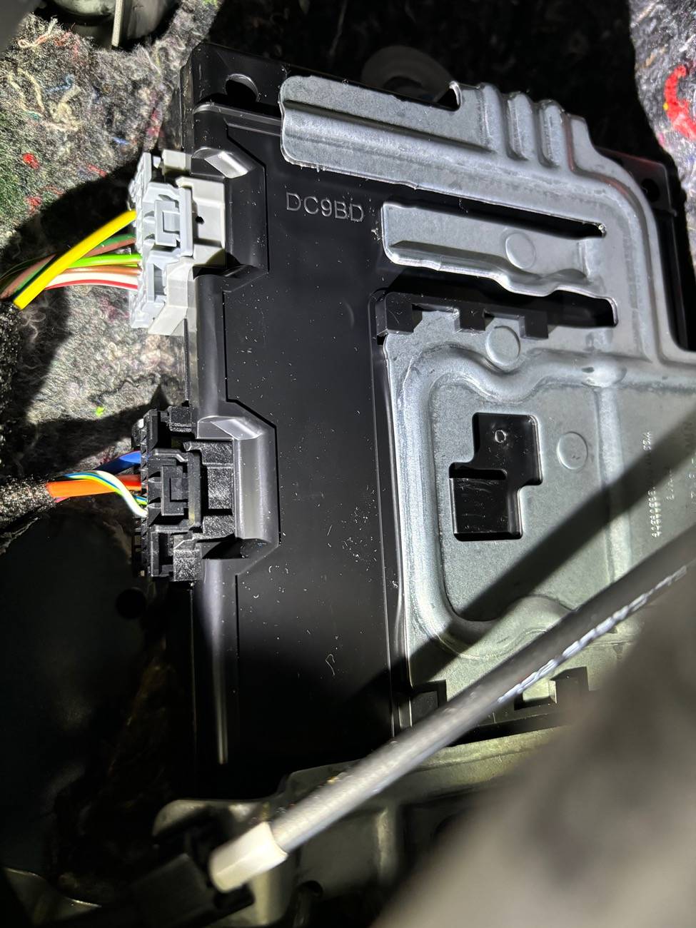

Thanks for that! I tried looking up and feeling all under the dash but found nothing. So I started pulling trim. Wish I had better news but no connector behind this trim part which I believe is where the controller is installed with the advanced tow package. I am not good at tracing the diagram either, but I think I found the trm with two connectors in place. If this is it then maybe at some point ford sells a dongle that goes with the tbc to install on right of steering wheel
first pic is of the trim piece pulled out some
Second pic is looking behind it. Not much to see but all I was able to find is the wire for the ambient light
Last pic is from the left side behind the hood latch. Couldn’t see labels on those two connectors but I am thinking that module is the trm. Except the wire colors don’t match the diagram posted earlier so maybe it isn’t? Can’t see anything else that would resemble that. So I’m at a loss

So, I've been on a mission since seeing your post :) I am a newbie at all this so no real expertise here.... See my earlier post that has a pic of what I am assuming is the TRM module. After googling the part # seen in the photo, I'm pretty confident that my assumption is correct : https://dealer.parts.ford.com/shop/...cket-module-trailer-brake-p-nz6z19h332a?pdp=y (it's for a Maverick, but I think the Ranger is just not updated yet). Not much info but since the part number matched a trailer brake assembly, that seems at least that confirm those two connectors would be the ones with trailer wiring going into a tow module.
Now the hard part from there is to find out which wires that have to be tapped in for the after market controller. To that end I have no idea. Hootbro posted a picture of the wiring, however the colors from my photo do not seem to match what is seen in the diagram. So, this is where I am stuck.
