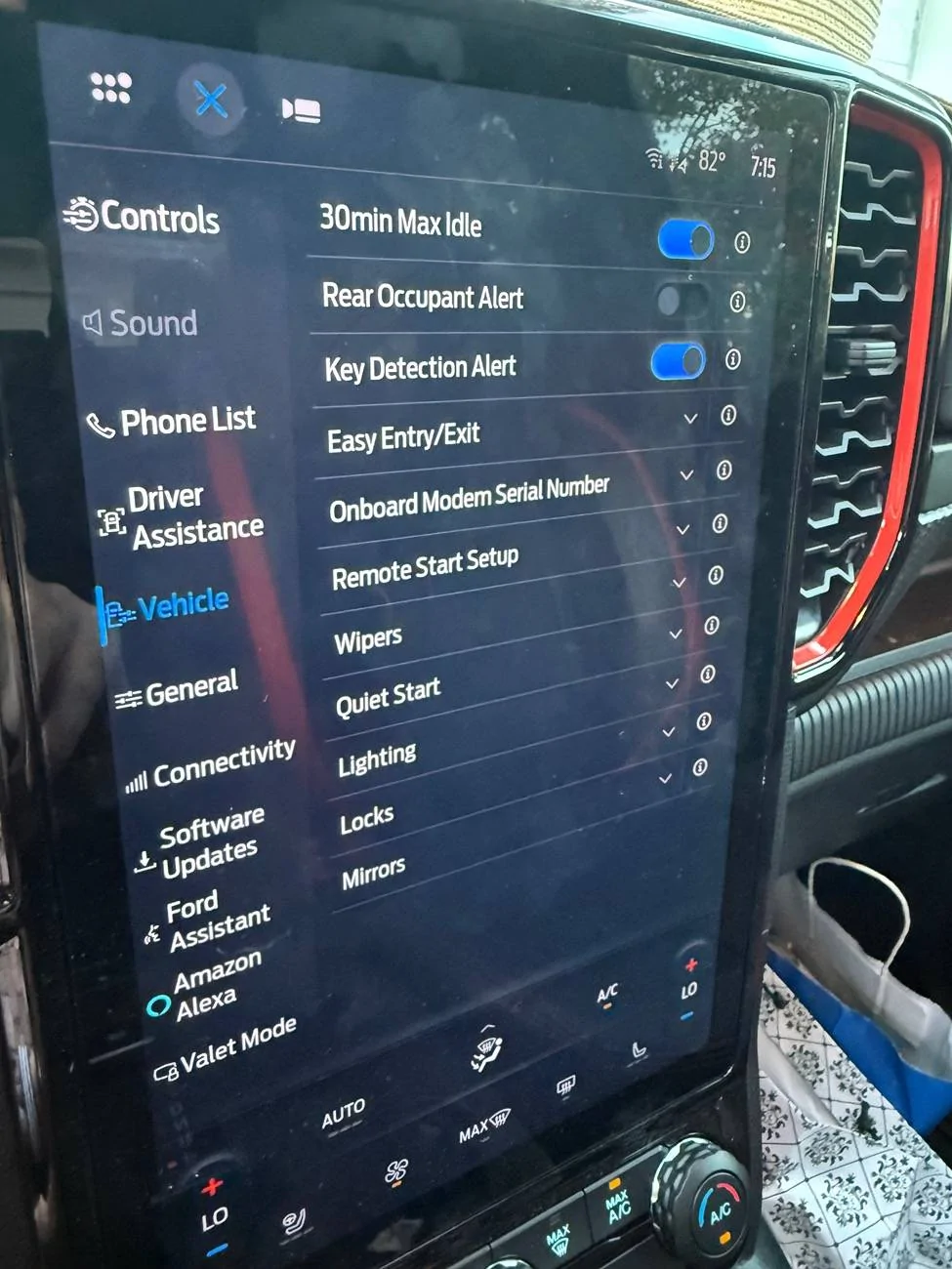

I noticed today that my Ranger Raptor 2024 seems to be missing the ability to bring down all 4 windows via the FOB. I believe it’s called global open and global close. I press unlock than release than press a 2nd time, this time holding it… nothing. I don’t see an option to enable/disable in the settings either (picture included). This seems like something Ford should be fixing.

It would be under windows on your screen but I don't see it there. I know it's on my Lariat FX4 as I was into the settings the other day to get my mirrors to fold when I lock it, turned that feature off in winter as wouldn't want to break the motors if it was frozen.

Yah I also don’t see it in settings. I do have the side mirror options.

I’m missing it also, it’s like they missed some features on a batch of them

Mulchbags2, my Lariat was built on 8/25/24 and was missing that feature, as well as many others. My info screen looks exactly like yours. Ford is supposed to be working on a fix, but I'm not holding my breath.

Just checked my truck screen. I have window listed on screen.
