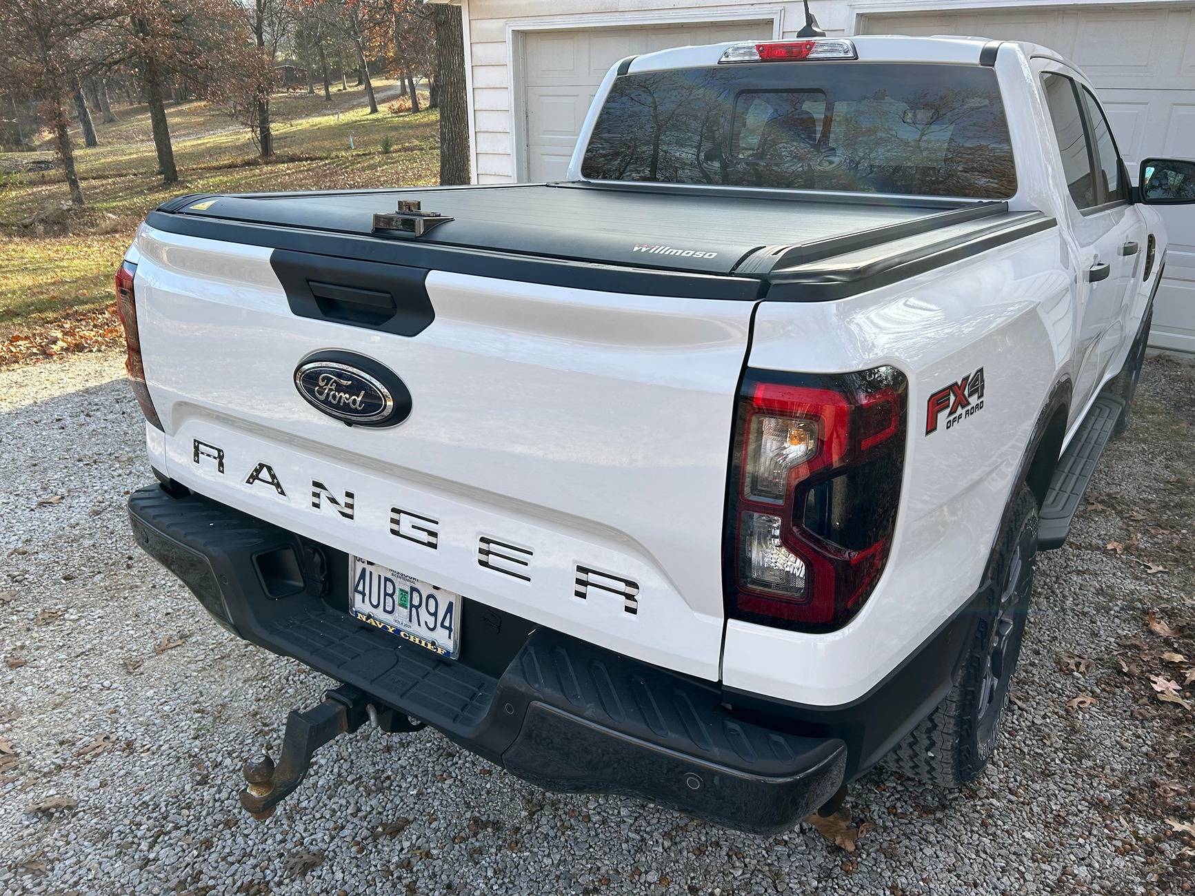

Finished the installation of a Willmoso tonneau today. I've seen variations of this advertised under at least 3 different brand names. Once installed it functions properly and the slats don't flutter at highway speeds like the Leer Jack Rabbit on my previous truck. The instructions leave a lot to be desired but if you have a mechanical background you can figure it out. At less than half the price of a new Leer
hard retractable I'm happy with it.

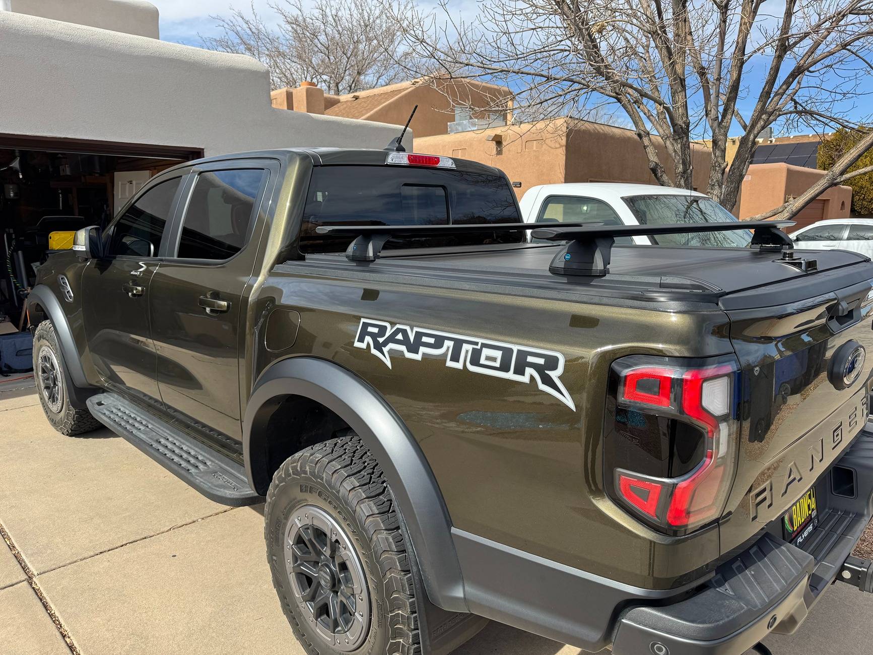

I got my Willmoso installed a couple days ago. Was basic stuff, but took a bunch of micro adjustments to get it going smoothly for me. It turned out good though. There's a couple You Tube videos (AI badly translated - HA!!) that helped a lot. Couple people on the forum helped me a lot too answering my questions. Thank you!

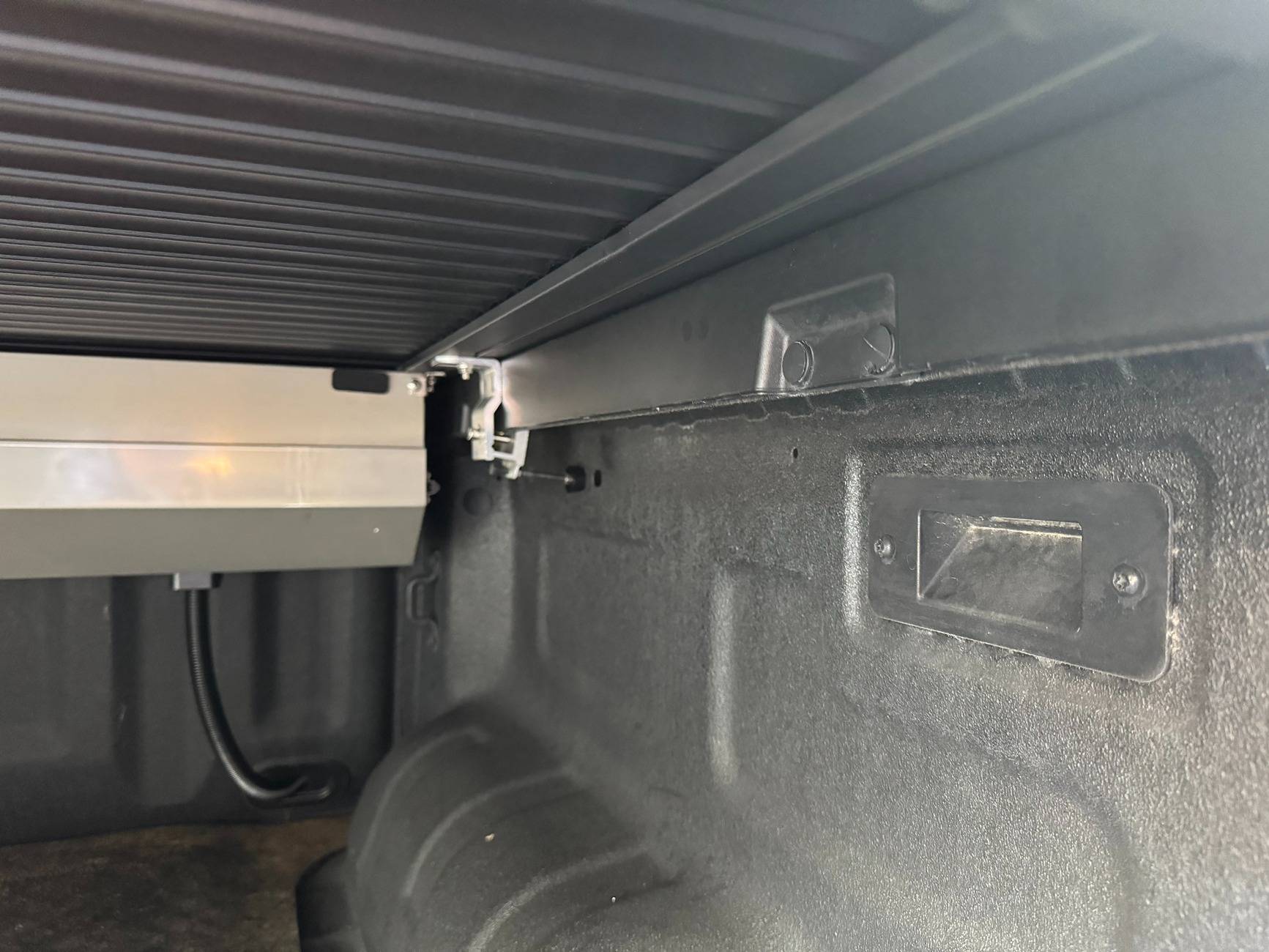

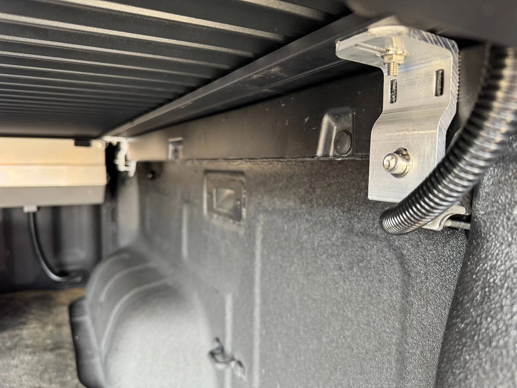

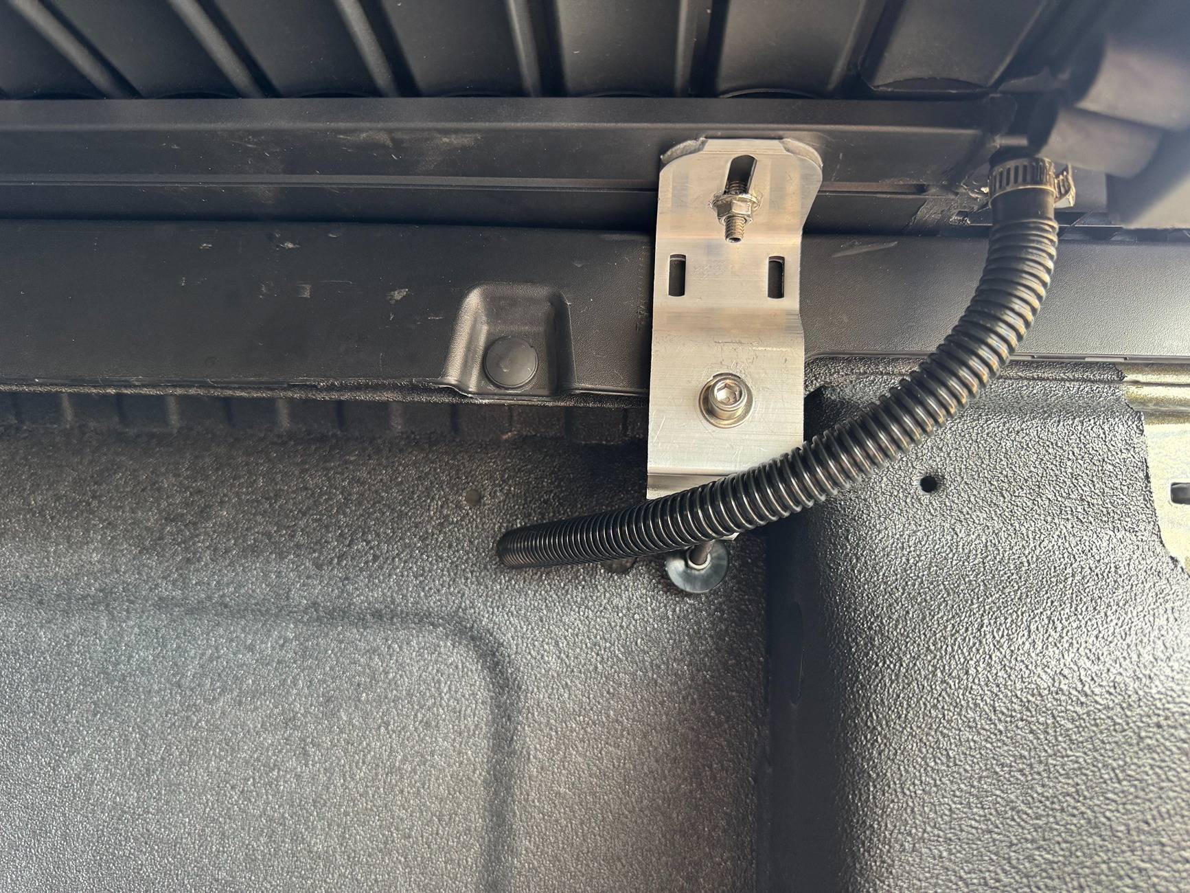

One more question... Does it eat up much bed space with it being retractable? Hard to find PICs of the inside of the bed.
Moonlit
Chris
Dec 23, 2024
58
Pittsburgh PA
2025 Ranger Lariat (Marsh Gray, Rear Locker and BAP)

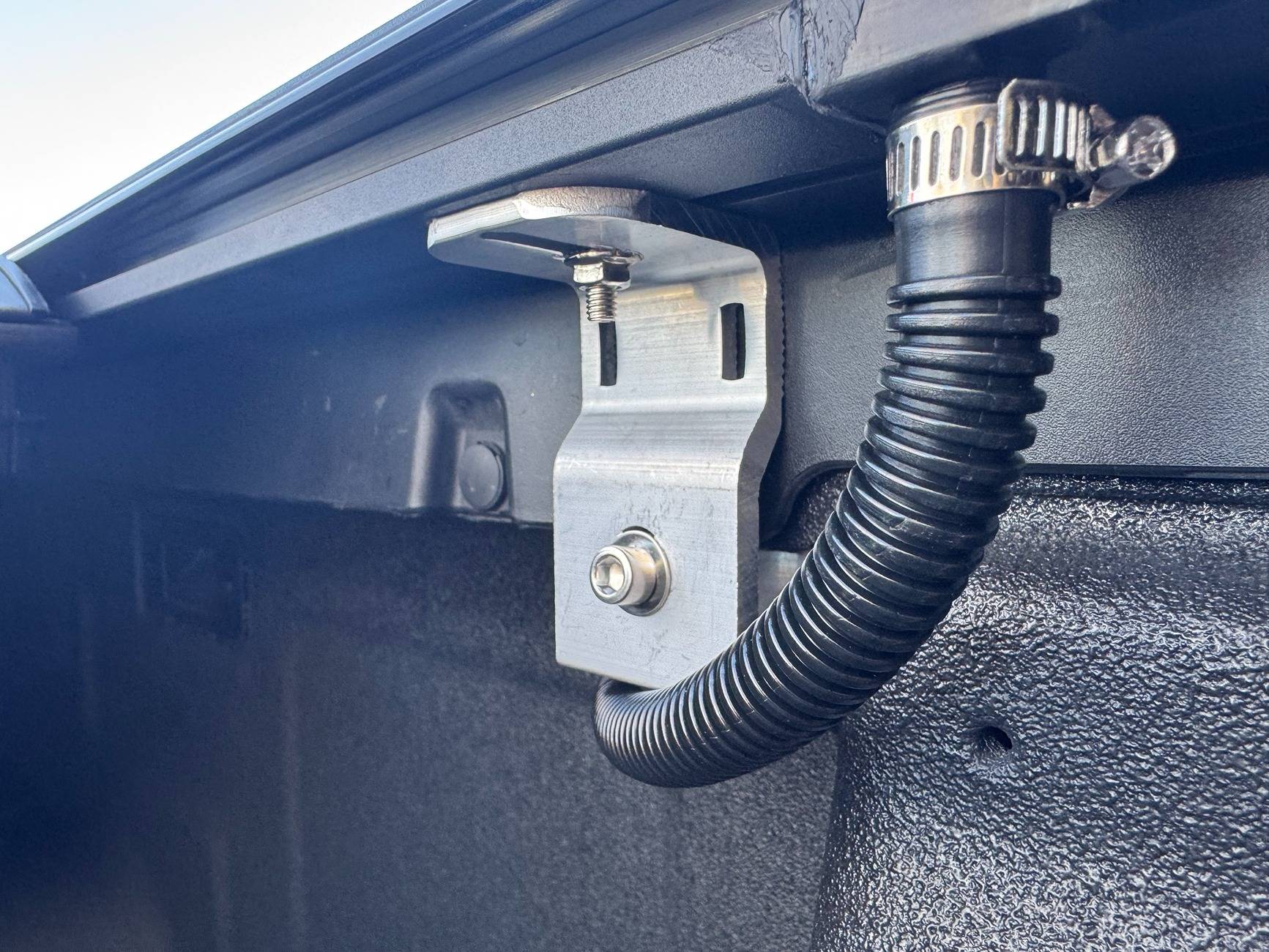

Yeah, it takes up a little room. Here's some additional pics that show under the tonneau.
Thank you very much - That helps a ton!

Who makes the racks and how are they attached?
D. Sampson
Dana
Jun 10, 2024
76
74
Albuquerque, New Mexico
2024 Ranger Raptor - Shelter Green Metallic
Hey Charley - I'm not sure if there is a brand name, they were super cheap off Temu (Ugh!). Temu threw a discount at me when I bought the tonneau and the cross bars cost $100. They attach in the T Slots of the tonneau.
The bolts the cross bars shipped with were for a larger T Slot, so I found bolts that fit. Afterwards, the seller did end up sending me some bolts that would have worked - but I already found better ones. As you can see if you zoom in on the picture I posted, the bars don't sit super flush. They would work better on a flatter T Slot, but for now, they work for my purposes.
Helps when my truck bed if full, so I can strap on a luggage rack, ladder, lumber, hand truck, etc... Eventually I'll likely get a canopy and pull the tonneau and bars off.
If you want the link to the bars, just let me know, I'll send it to you.
