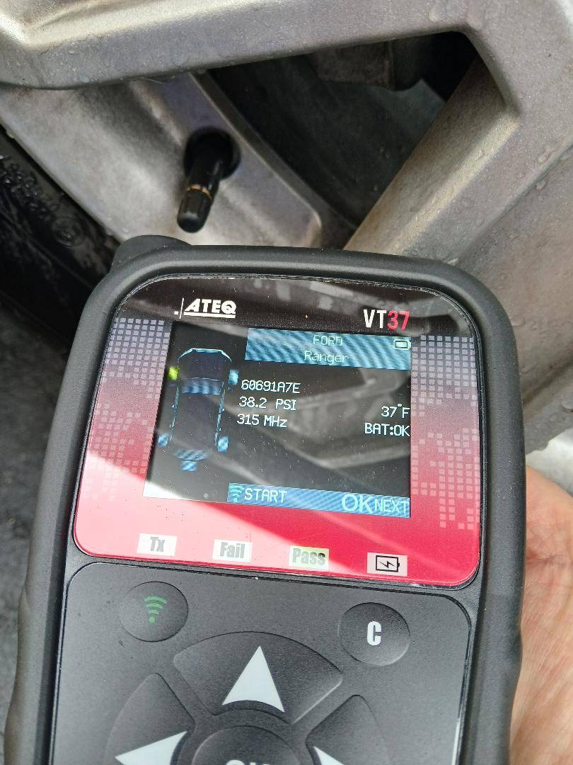

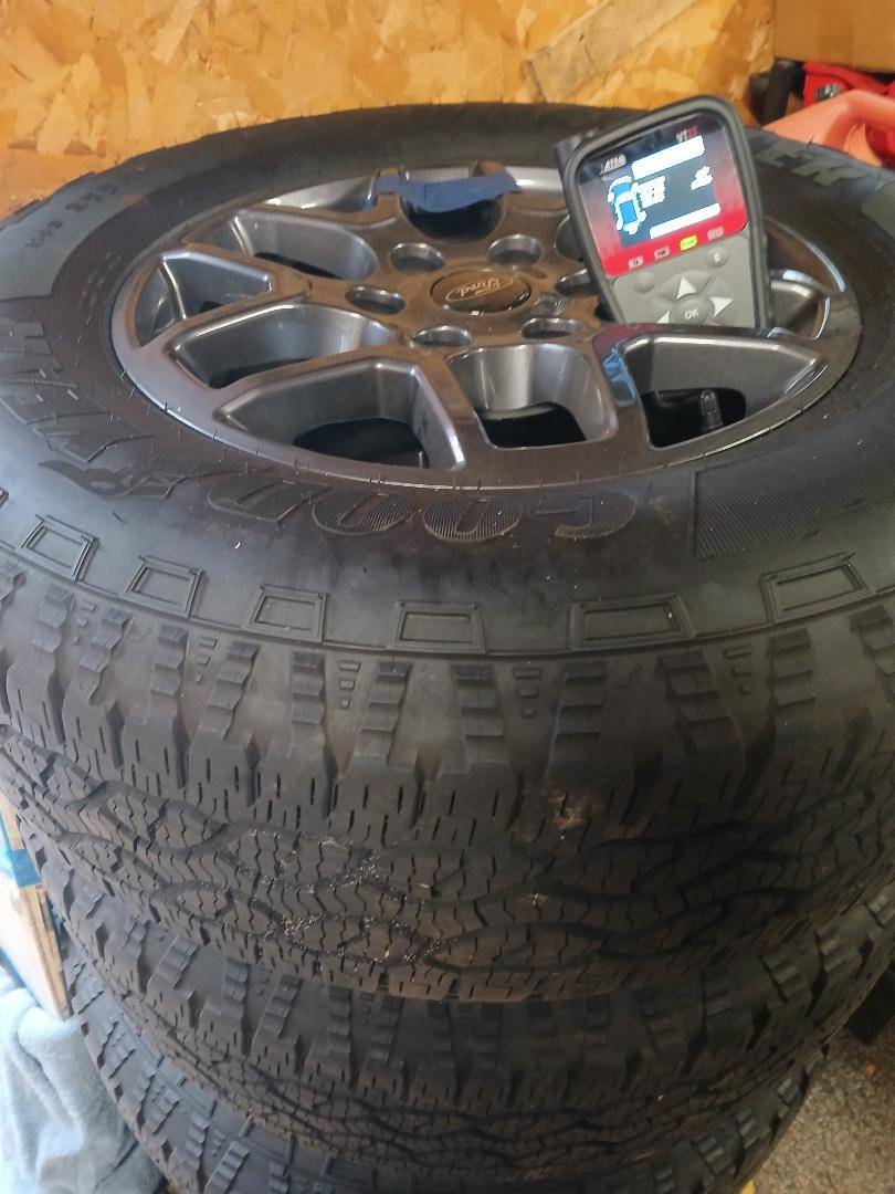

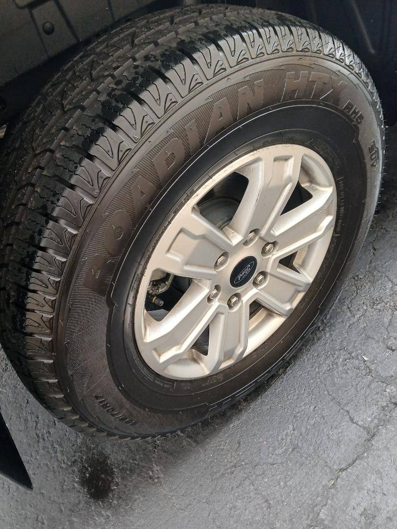

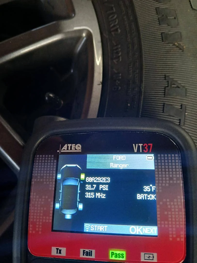

Now as far as will the sensors in those wheels your buying be recognized by your truck, the sensors i used above broadcast both 315 & 433 MHz so i just went out to my truck and it is sending out the 315 as shown in this pic (silver wheels).
The OE wheels i removed are pictured first they are the carbonized gray and they too show they are on 315 Mhz also, so my '24 is receiving 315Mhz
Now your getting a '25... Did they change anything in the TPMS system IDK. But my truck is a early production 4/24 build if that matters IDK
1. You could purchase the tool and see what your current sensors are on the purchased set then drive to your local Ford dealer walk the lot and check a new '25 Ranger if its the same Mhz as your purchased tires you gold and that way your know.
2 Just wait till the truck comes in and go to the tire shop and find out then about both sets.
The info in my first post about 433 Mhz must be incorrect (Google AI search result) because i just verified otherwise.

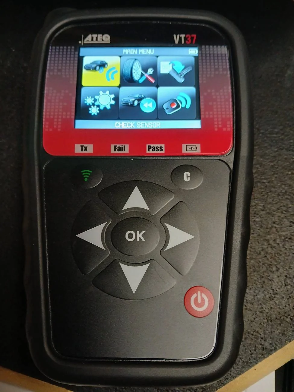

Yea the tool is great i do a # of tire swaps on all my vehicles plus it's able to check battery strength in key fobs to see if there going dead.
