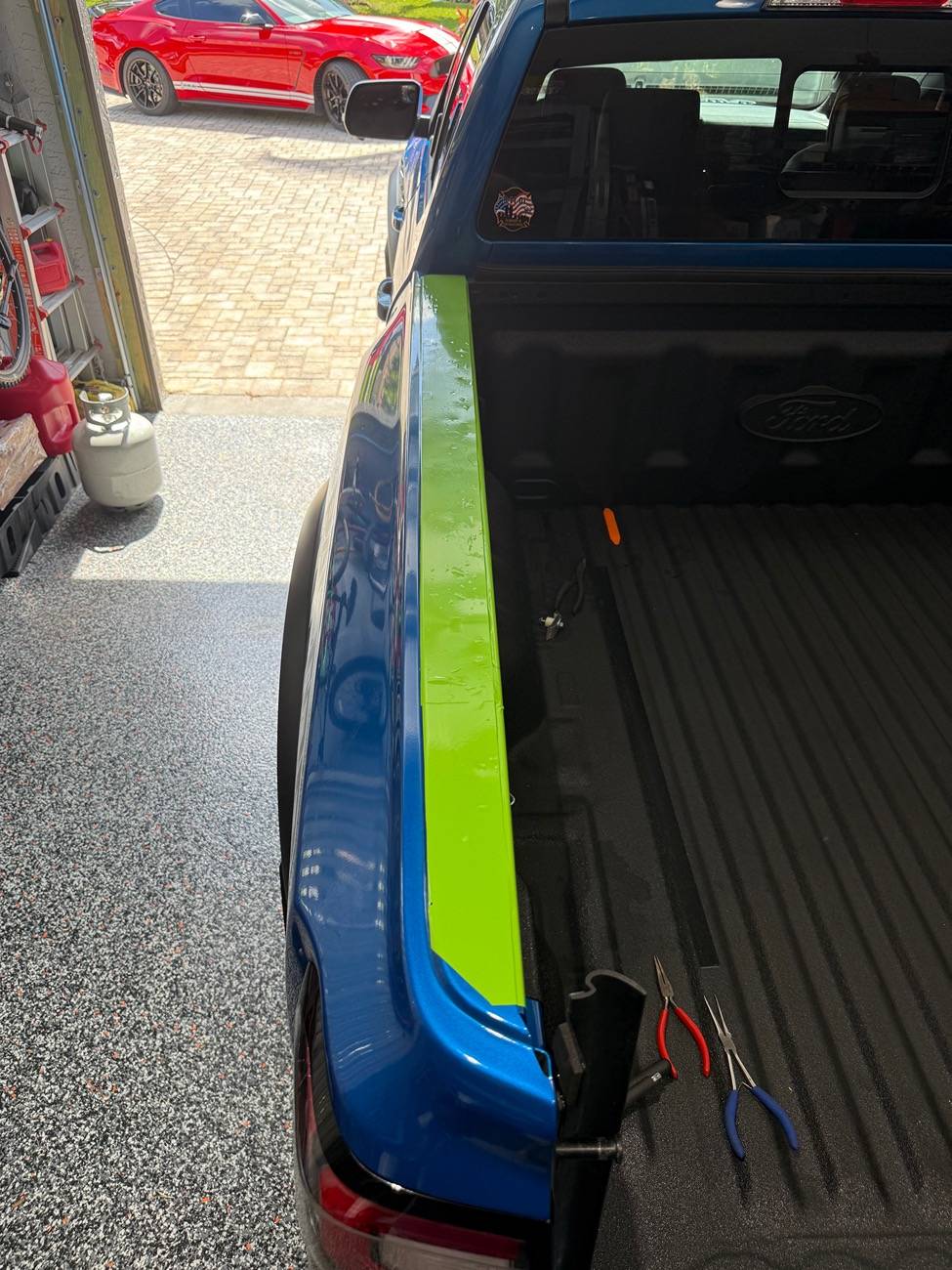

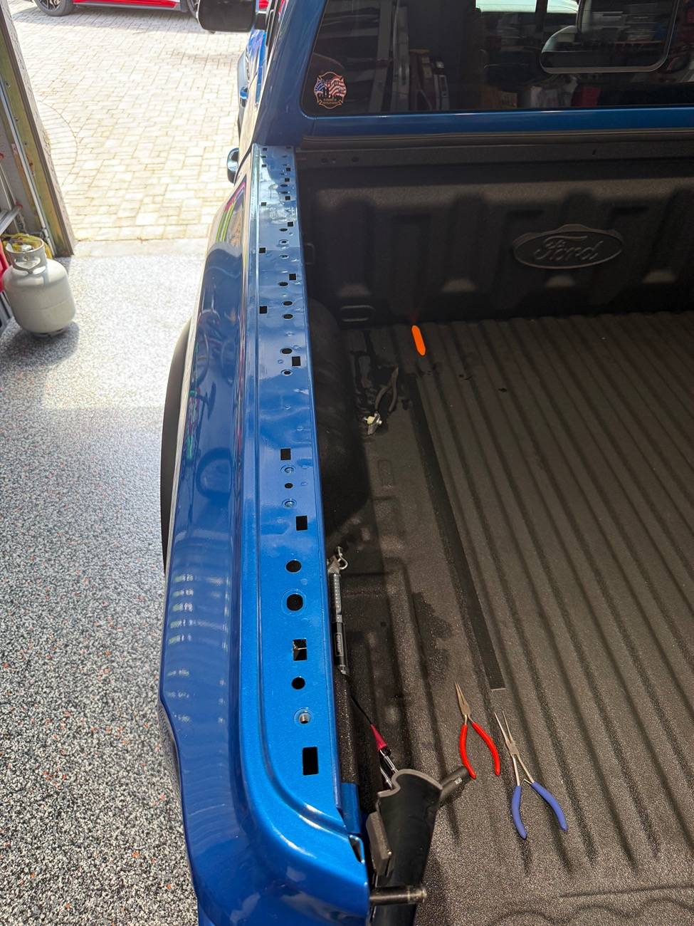

I pulled the caps, breaking the same clips on both sides. Laid down vinyl and silicones the places that the caps pierced going back on.
Ford Ranger Water Leaking Through Stake Pockets IMG_2966
Ford Ranger Water Leaking Through Stake Pockets IMG_2965

I cut matte black stickers on my plotter to cover mine.
I thought about that, but figured one or two would peel, using one large piece gave me more peace of mind.
