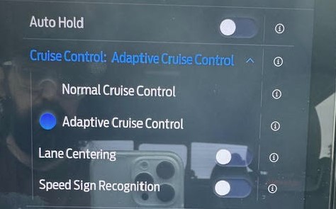

Yeah, it's become muscle memory already to hit cruise and then the lane centering button to disable it.
What doesn't make sense is there is a toggle for lane keep assist under adaptive cruise settings and it is supposed to disable it. I've tried it and it does not.

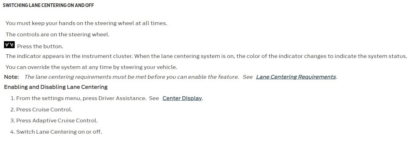

Correct. I believe it is lane keep is when you are not using adaptive cruise. Lane centering is when you are using adaptive cruise. The button on the steering wheel is the same for both functions according to the owner's manual entries.
Either way, using the lane centering toggle under adaptive cruise doesn't work. It comes on every time I engage cruise and have to use the steering wheel button to disable it. I'll have to look at the center stack message next time to see what verbiage they use when I disable it.

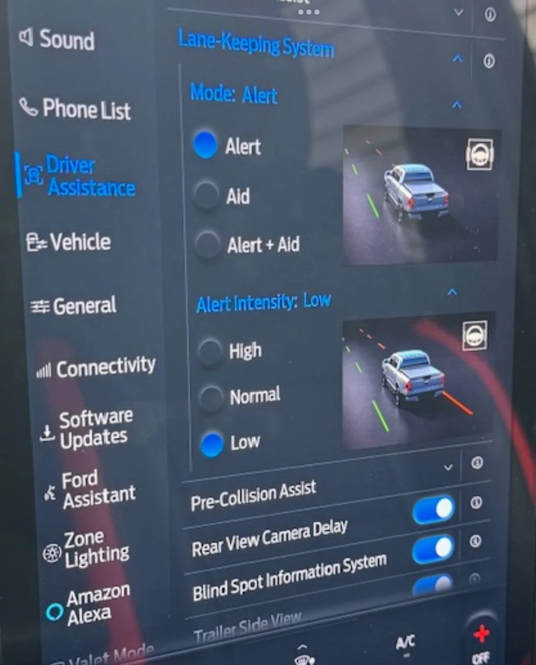

I think I have a workaround. If you go into Driver Assistance > Lane Keeping System, you can change Mode to Alert. Now when I turn on cruise it no longer actively keeps nudging the wheel. It will just show up in the bottom right corner if you lane drift.

I have played with this and make sure lane centering is turned OFF in the cruise control menu. This is what is currently buggy and causes the truck to feel like the alignment is screwed up and is throwing tons of errors at you to hold the steering wheel. I have not had an issue with cruise since I turned this off and run lane keep all the time.
