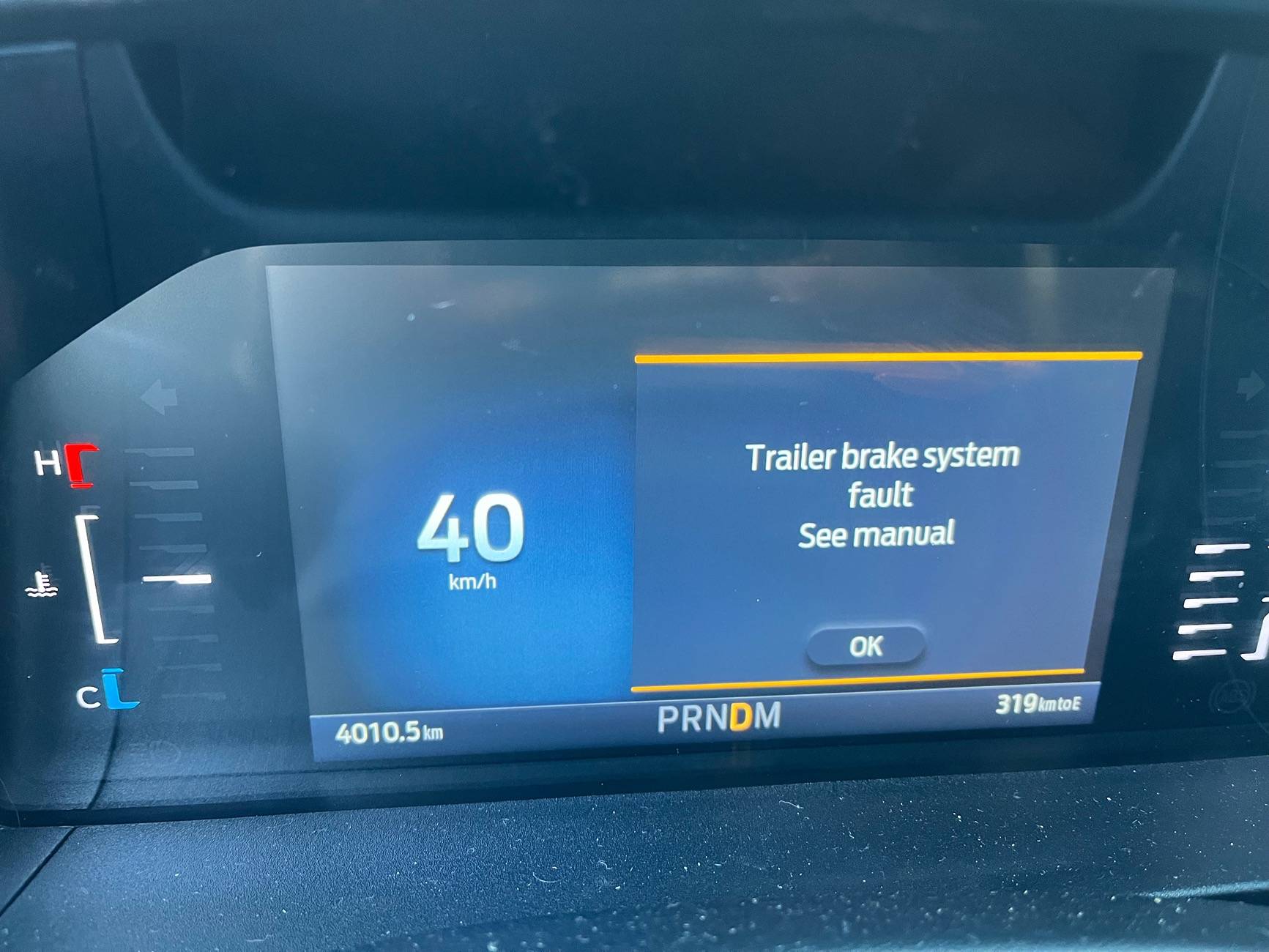

I tow a small (under 2,500 lbs) boat trailer - 4 pin single axle trailer and small fishing boat. No Trailer Brake System, no trailer brakes, just the factory tow hitch. Have towed the boat 2 times in the 2 months I’ve had the truck without any issue.
Today, with no trailer attached, I’m getting a warning “Trailer Brake System Fault. See Manual” every time I get in the truck and start the ignition. Six times today.
Can’t find anything in the manual. Anyone run into this? Anyone have a solution?

I’ve seen it on my boat trailer as well. 4 pin with no brakes. Haven’t looked into it beyond seeing it a couple of times.

Just to add fuel to the fire, I had this happen exactly once. But, if I remember correctly, I was actually towing at the time, or at least I was on a camping trip during which I towed my trailer.
I don't have a solution, but it hasn't happened again.

Possibly a blown fuse. Check I had a similar issue. Could had been when the trailer was connected it grounded out.

I was washing my Ranger a little while ago and remembered that the one time I did get this error was after washing the truck. I assume I got water in the trailer connection and that made it go haywire. It went away after a while. I didn't happen when I washed the truck today but I was a bit more careful with pressure around the trailer connection.

thanks for taking the time to respond. I think we may have an answer here. I washed my trailer and truck when I got home from fishing now that you mention it. Quite a bit of pressure when I washed the tailgate and it happened after that. went on all day but has resolved since. Maybe moisture in the connection was the problem.
Thanks for your input!
