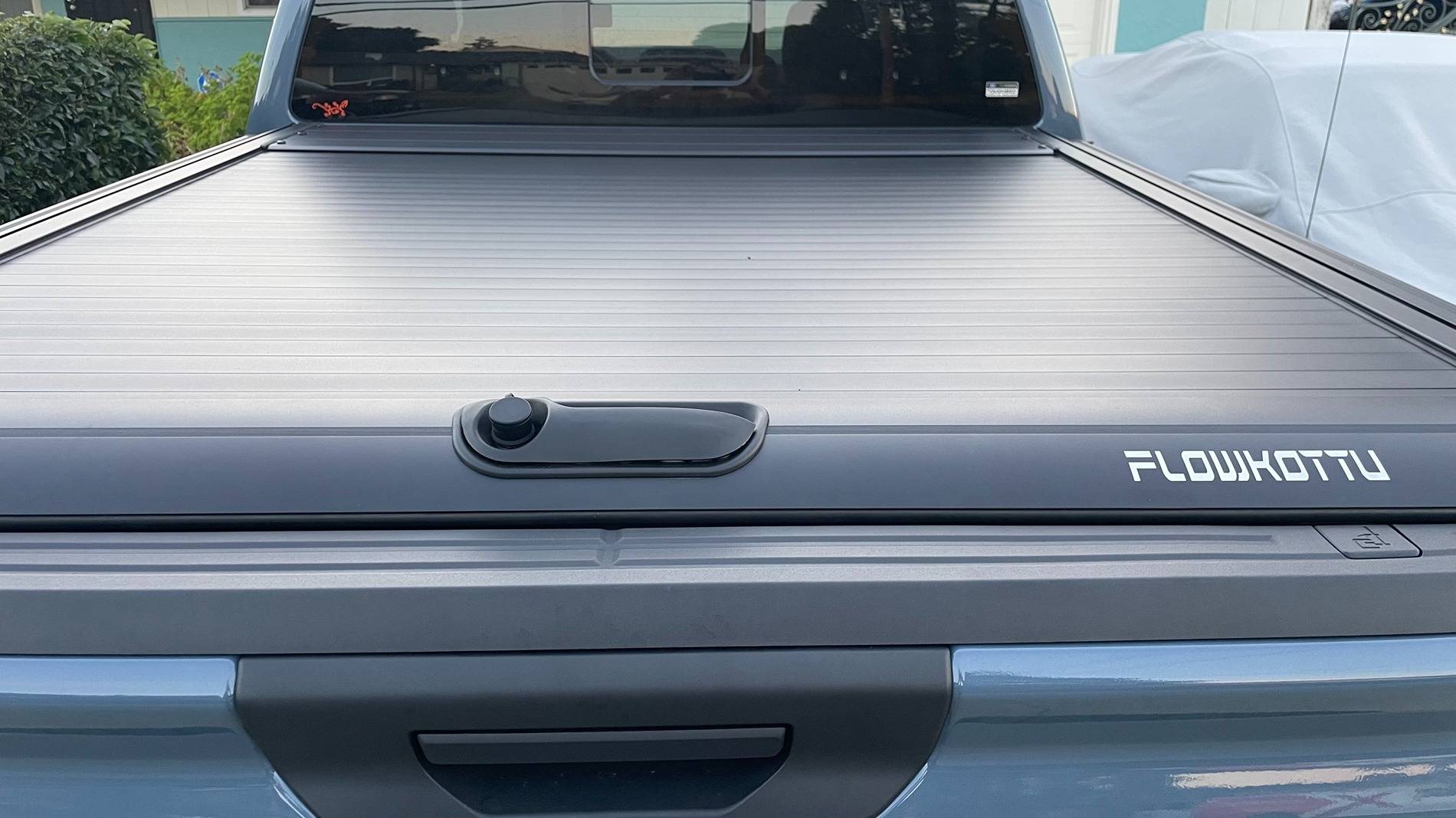

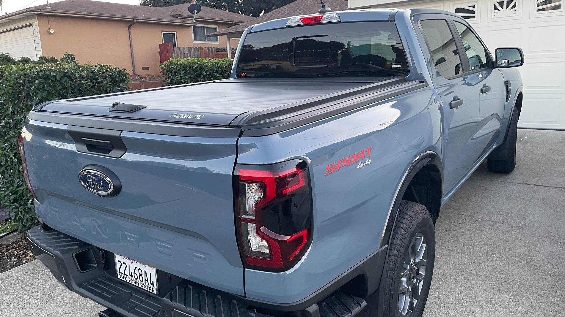

I just installed one. they're fine along the plastic covers. Now a Bed Cap- No. But a Tonneau cover is fine.
Ford Ranger Tonneau Cover Installation Questions IMG_2653
Reactions: JDW

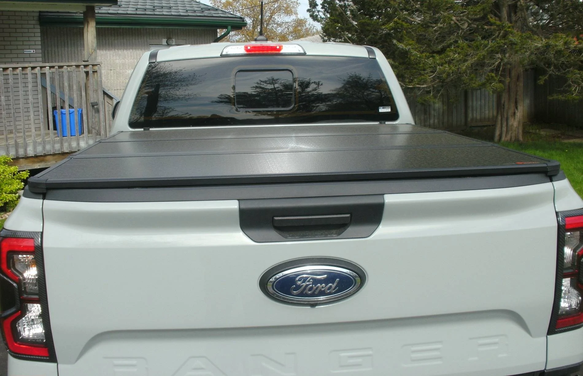

Mine is also on top don't worry about it.
Ford Ranger Tonneau Cover Installation Questions Tonneau cover pass side view
Ford Ranger Tonneau Cover Installation Questions Tonneau cover tailgate open
Ford Ranger Tonneau Cover Installation Questions Drv side view tint tonneau cover
Reactions: JDW
