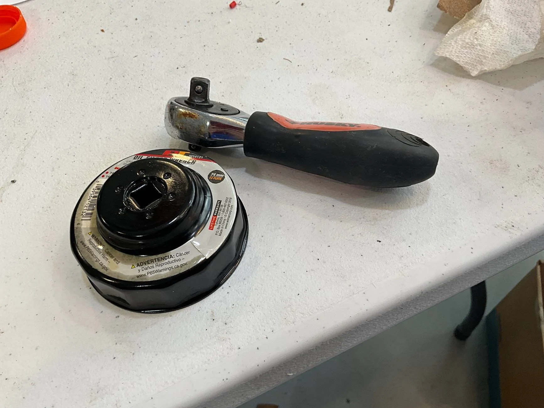

1st observation, it wasn’t nearly as bad as I was expecting from reading the many posts on this site in preparation for doing the job. I reached down from the top, used my right arm. I have a HUSKY stubby socket wrench that is 1/4 on one side and 3/8 on the other. An oil filter wrench (74mm, 14 flute) $8 from an Advance Auto parts. I had to use a step stool (5’7”) and lay across the top of the covered fender. Tight fit and would be difficult with “Popeye” forearms. I don’t have that issue.

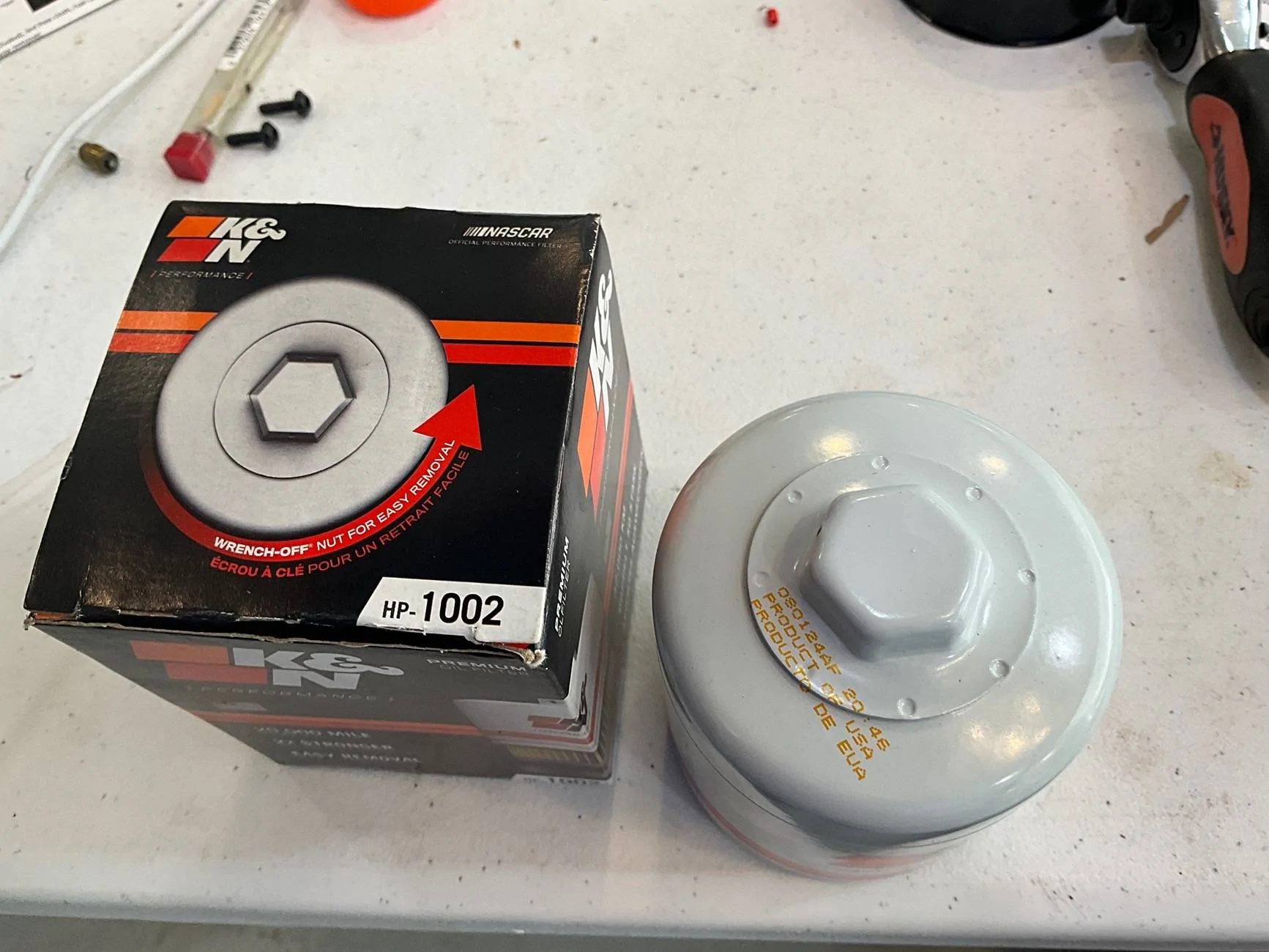

2nd observation, I have always used K&N filters(HP 2002) on all my oil changes. I believe they are high quality filters and I like the idea of the 1 inch “nut” on the end so you can put a wrench on it. As I secured the filter, I wondered about getting a wrench down there to remove it, but that will be figured out down the road (see observation #4 below).
