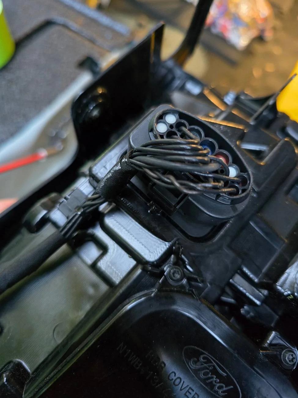

Thanks. Got it done. But wow they made all the wires almost the same color. Wtf.
One might be slightly brown.
Unplug the connector and u can use a multimeter to find ground and power. Can have someone do reverse for u so u can see which port gets powered only when reverse is engaged. And can find ground once u find a positive (ground on a bolt or bare metal nearby for finding positive then hold the positive and search for a ground pin in the plug). I did it for my third break light on my camper but i dont have any pictures for which ones i tapped sorry.
