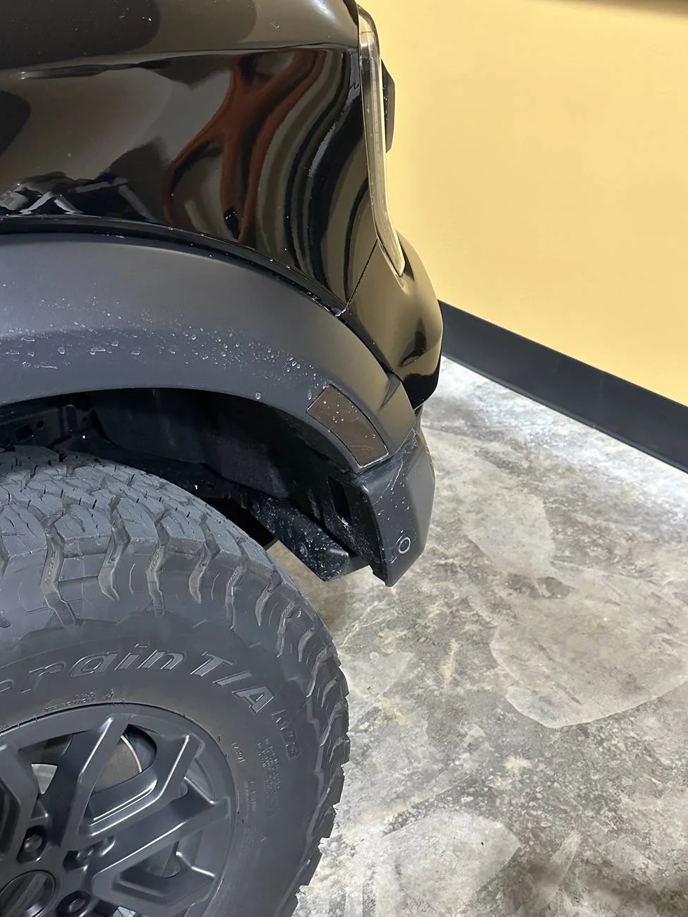

My previous gen Ranger, I purchased the smoked side marker lights. I’ve not found any so I tried the AutoZone tint option. If you guys know someone selling them please share.

I wrapped one set of mine too. I’m terrible with cutting a straight line and after 500 yards of tint wasted I finally got it right. I’m a little better at spray painting 😆.

I took a piece of painters tape, covered the light, used a pen to mark the outline, took the tape off, used it as a template. One side was traced on the back of the Vivvid tint, one on the front. Laid them down and perfection.
