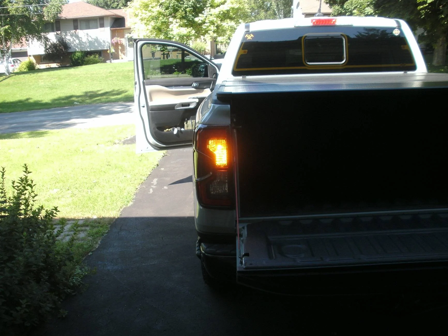

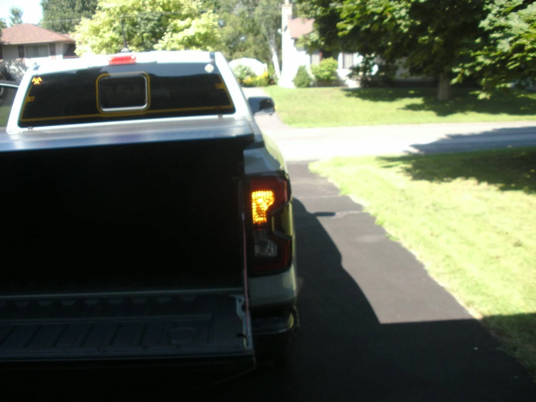

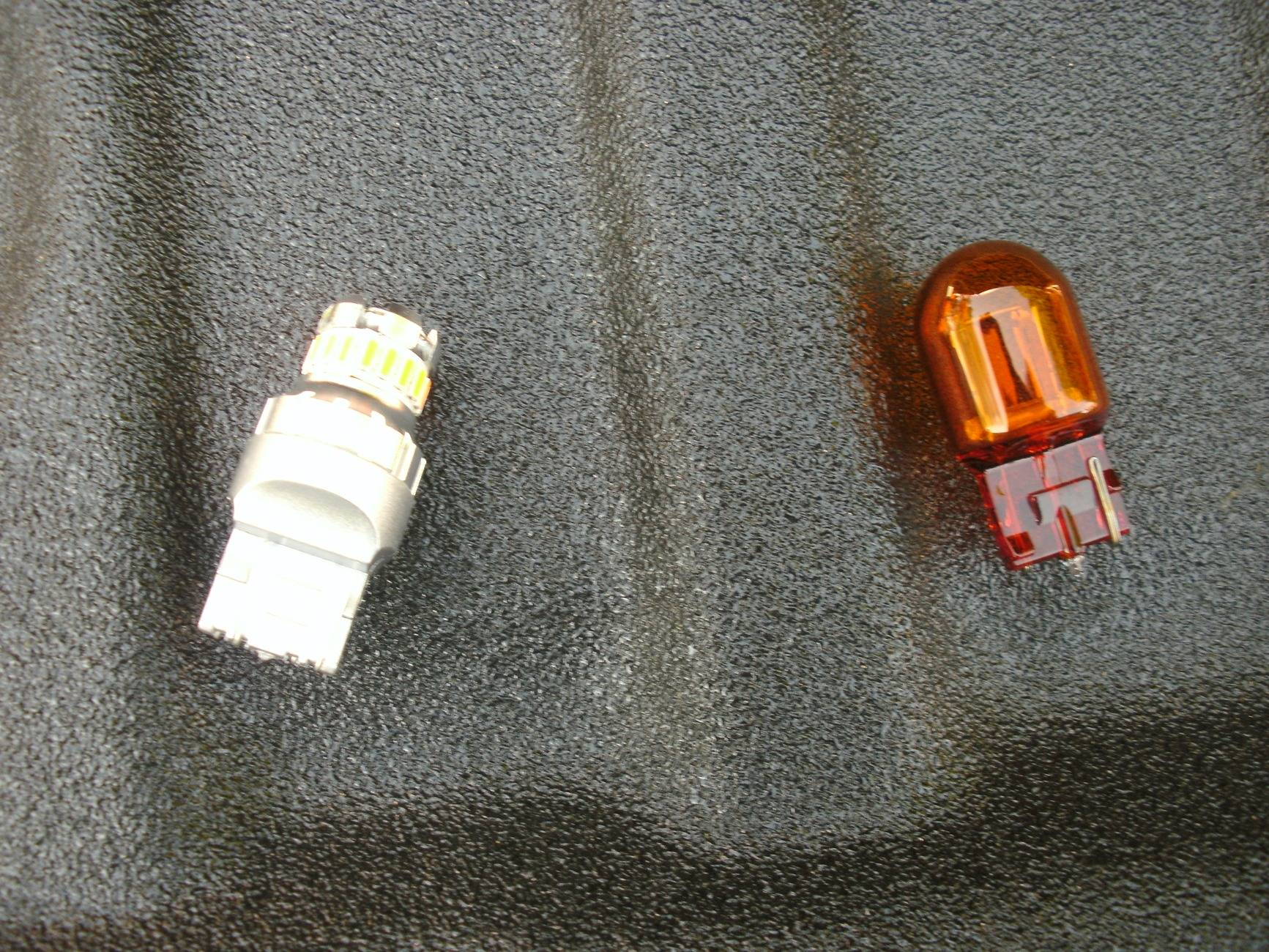

My was easy take the 2 torx screws out and pull straight back. Push the socket down a bit and turn it and it pops right out. Took me maybe 2 mins to do both and that's with pics. I did the turn signals.
