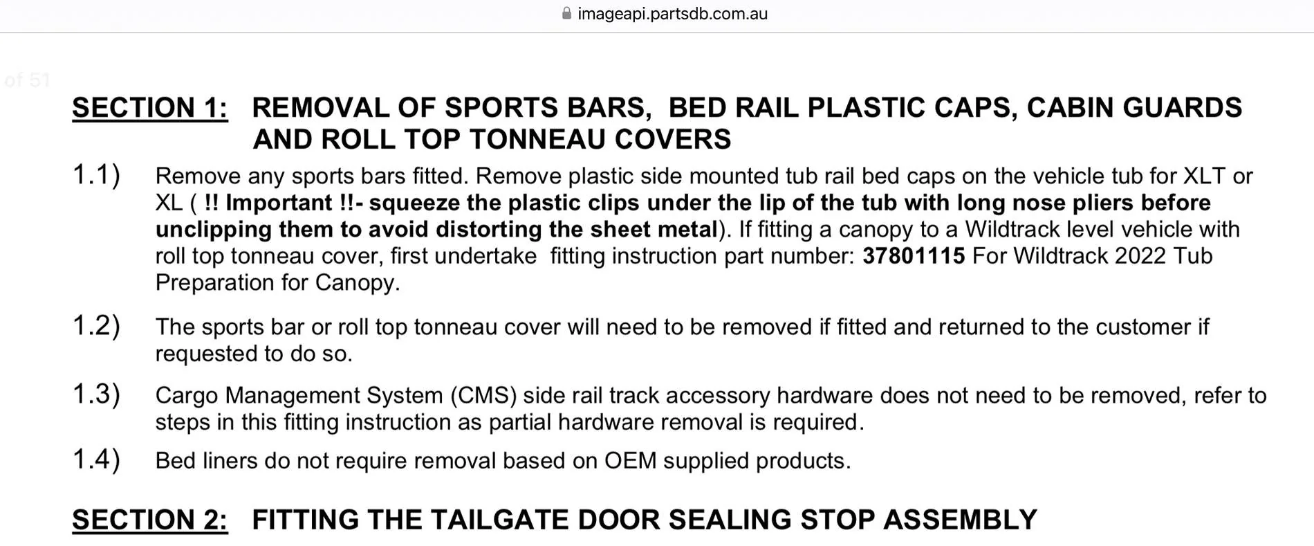

I haven’t done it personally, but this is what ARB says in their canopy installation instructions
Ford Ranger Remove Plastic Bed "Rails" IMG_6827
Here is the source:
Instructions Ascent Canopy AC16C– to suit Ford Ranger Dual Cab 2022+
If you get them off, please post a few pics and any tricks you discover.
FYI, you can’t mount stuff directly over the plastic trim pieces without using appropriate hard spacers to transfer the load directly to the steel rails. If you don’t do this, the plastic will distort/ break, and then you are fu@#$&

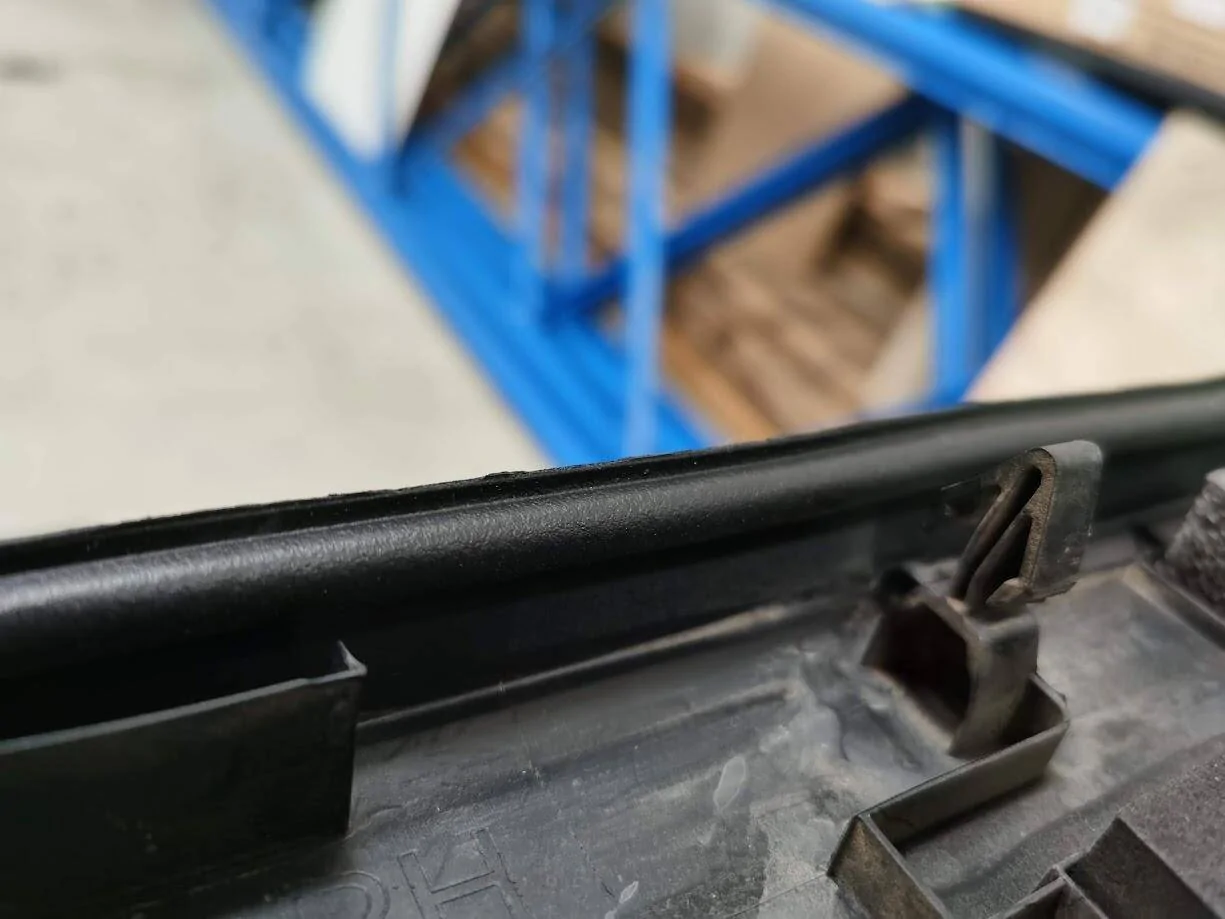

This gives you some idea of what you are dealing with (zoom in to see they types of clips).
For some of the clips you can use a plastic trim tool to help push the clip inward while pulling up on the plastic trim. For the ones at the front of the bed, you can't get a trim tool into. The best approach I found was to hold the trim and pull it upward while rocking it side to side. It takes a bit of wobbling and a bit of force but eventually the clips come out.

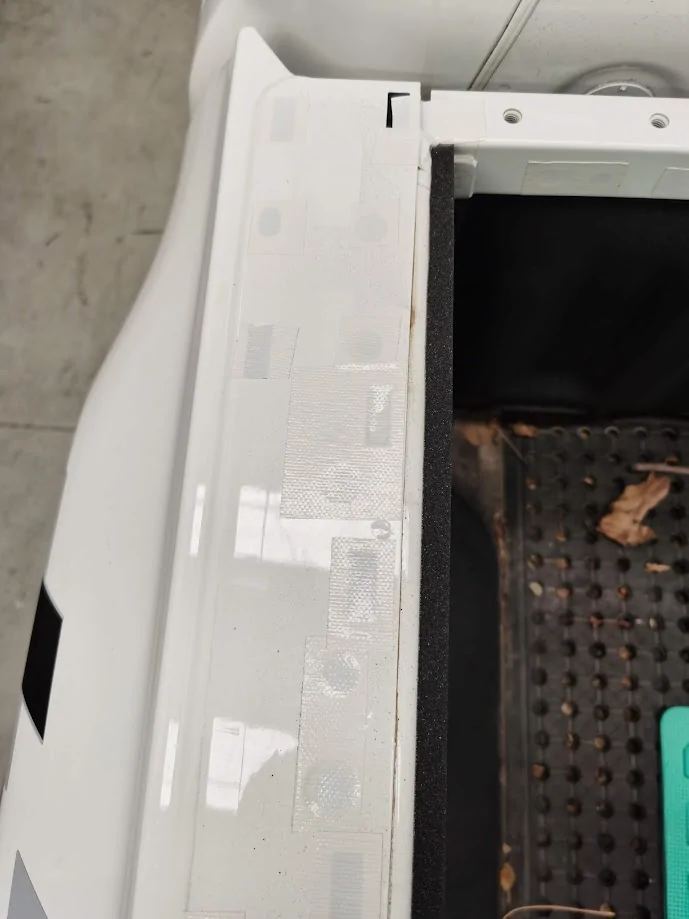

This is a close up of one of the clips (and a rubber seal I put around the trim to try to control dust ingress):
Ford Ranger Remove Plastic Bed "Rails" 1721085740384-3t

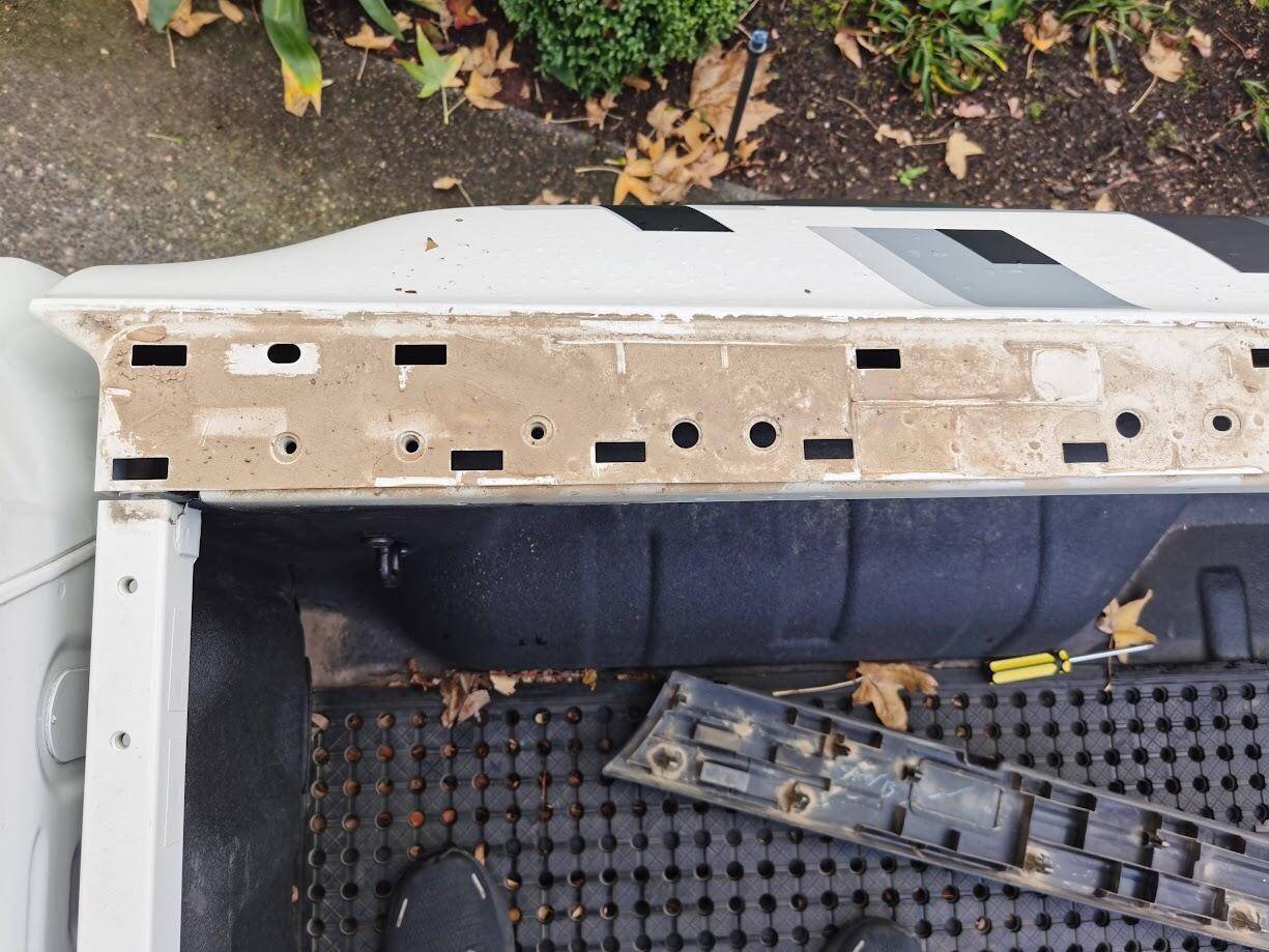

I also took the time to cover up the plethora of holes in an attempt to further reduce dust:

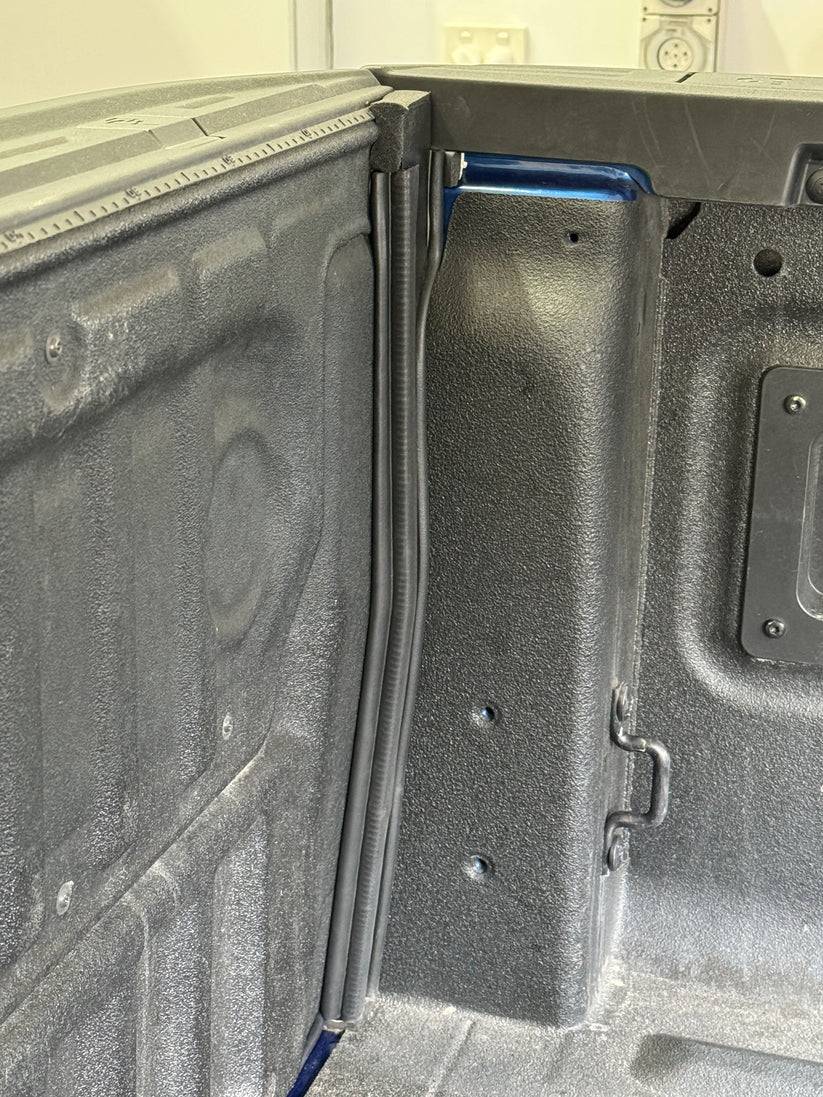

But the biggest defence against dust comes from the tailgate seal kit (not my car):

What tape did you use to cover the holes?
