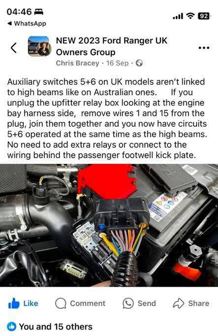

I've found this on facebook, haven't tried myself yet.
Only AUS rangers have this functions, rest of the world doesn't because of legislation.
Ford Ranger Reconfigure AUX switches for Australian High Beam Setup? WhatsApp Image 2025-04-16 at 15.38.27
