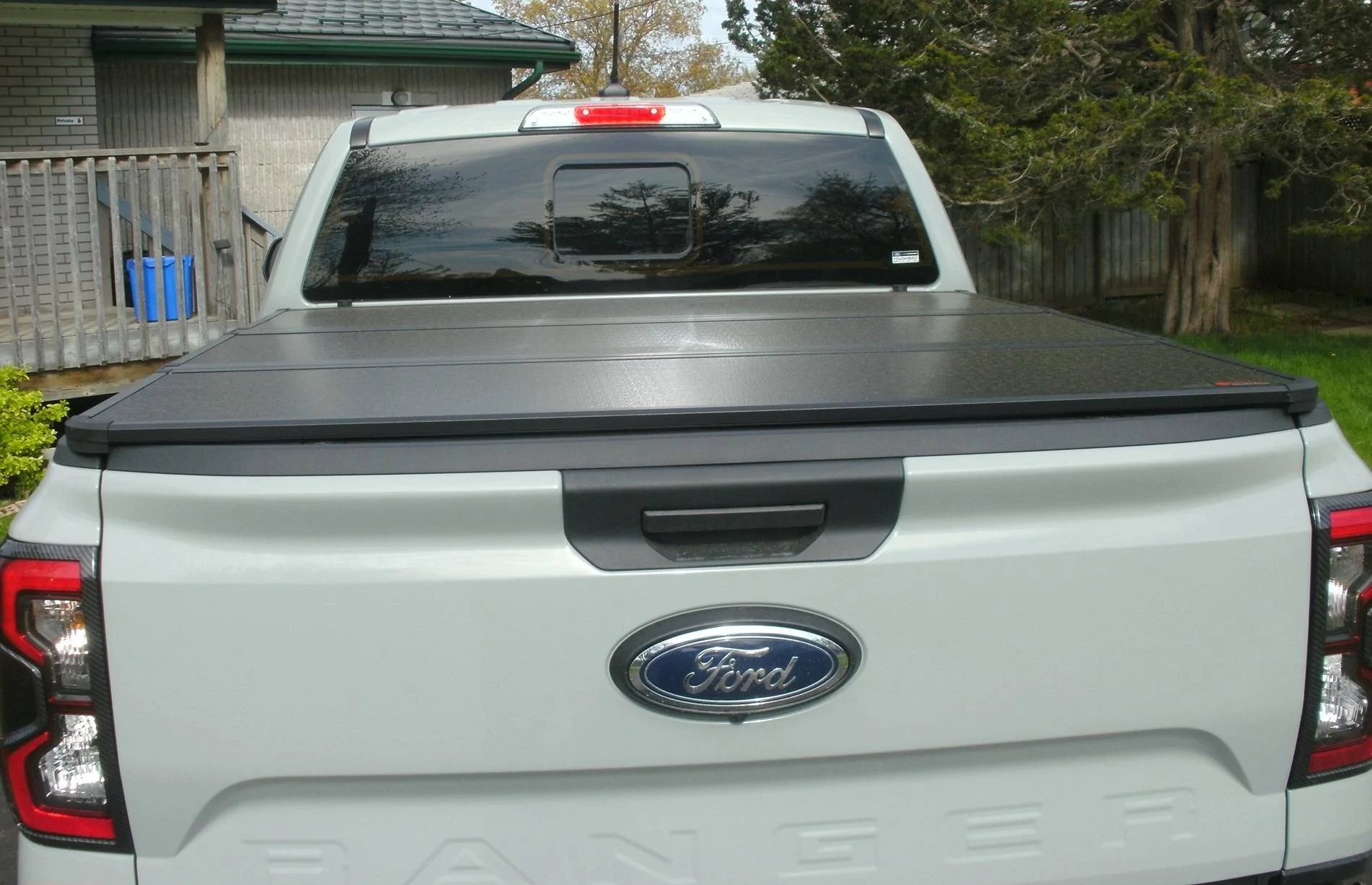

Mine fit well. It a version of Extang 2.0 Solid Fold and it was way cheaper here in Canada.
